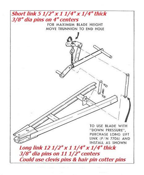

case442 132 #1 Posted December 13, 2022 Hello all, I have a 1997 314H that I’m looking for the lift arm or bracket to attach the snow blade to the rock shaft. I see that there are two different lengths available. Would anyone know which arm would be used on this tractor? I appreciate your help. Thank you, Mike Share this post Link to post Share on other sites
Achto 31,861 #2 Posted December 13, 2022 41 minutes ago, case442 said: Would anyone know which arm would be used on this tractor? If you do not need down pressure you can use a chain. Down pressure is nice to have though. 3 Share this post Link to post Share on other sites
953 nut 66,302 #3 Posted December 13, 2022 If you want to go directly to the rock shaft the long link should be the one you want. If you want to connect to the mower lift arm so the blade has float and follows the couture of the driveway which I would advise then you want the short one or a chain. 4 Share this post Link to post Share on other sites

Racinbob 12,980 #5 Posted December 13, 2022 Here you go. 2 1 Share this post Link to post Share on other sites

case442 132 #7 Posted December 13, 2022 Thank you all, it’s much appreciated now I have a direction to go in. mike 2 Share this post Link to post Share on other sites
