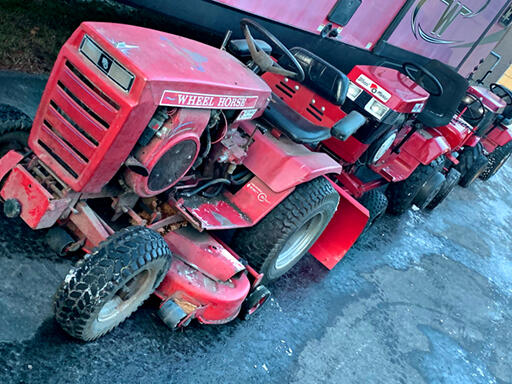

jsp_333 306 #1 Posted December 11, 2022 Went to fire up the 314-8 I picked up this summer and when I put it into gear got this horrible belt screeching noise and the tractor wouldn't budge. Got off the tractor to see if it would roll in neutral and no chance. Used the tractor all summer and even pushed snow with the blade a month ago. Has anyone else experienced this and/ or knows what it is . Have I missed the obvious? Cheers, 1 1 Share this post Link to post Share on other sites
gwest_ca-(File Mod) 12,489 #2 Posted December 11, 2022 Is there a chance the temps have been below freezing? If there is water in the transmission oil given some time it will settle on the bottom. If it freezes the gears won't turn in the ice. Warm up the transmission and drain the oil. It takes quite a while to melt all the ice. 7 2 1 Share this post Link to post Share on other sites
stevasaurus 23,856 #3 Posted December 11, 2022 G-West nailed it. Water froze in the trans. Don't do anything but melt the ice. Space heater, light bulb are good choices...open drain plug an let the water out. 7 Share this post Link to post Share on other sites
jsp_333 306 #4 Posted December 11, 2022 Awesome. Thanks guys. Thought I had changed transmission oil when I brought it home. I guess not. I'll dig out the space heater and drain it and get new fluid in the trans. 3 1 1 Share this post Link to post Share on other sites

jsp_333 306 #15 Posted December 13, 2022 Water in the transmission fluid appears to be the right diagnosis. Only took about an hour and the tractor is moving again. Can't get the transmission plug out so it will have to wait until spring. The rear tire and wheel weight will have to come so I can get enough torque on the plug. Thanks for all the help everyone. 2 Share this post Link to post Share on other sites

Handy Don 17,484 #24 Posted December 15, 2022 Under the rubber boot, there is a dog-point setscrew on the front side of the hole in the transaxle that holds the shifter in place. BUT there is room around the shifter' shaft to carefully pour in fluid. You do realize that the drain plug for the transaxle is on the bottom, right? It's a ¼" allen wrench. The plug on the side is for filling. Unless you get the water out, it'll continue to freeze. I suspect that there is enough water in there that it'll dilute any added diesel or standard RV antifreeze too much to get added protection. If you could get concentrated antifreeze (like in the old days) you might be able to get a high enough concentration. There is likely about 1-2 quarts of water in there. I know you can't work on it until spring, but if it were mine, I'd try hard to get the bottom plug out of the trans and leave it open over a pan that can hold 3 quarts of liquid. In my mind, better empty than any amount of water. 1 1 1 Share this post Link to post Share on other sites
jsp_333 306 #25 Posted December 16, 2022 Done & Done! There was more than a quart of water that came out to 1/4 quart of gear oil. Just one question remains. If the plug on the side of trans is for filling - what is tube & dipstick under the seat for ? Just a redundancy? That fill plug on the side is never coming off so filled down the tube under the seat. Did I miss anything by not use the fill plug on the side ?. 1 Share this post Link to post Share on other sites
