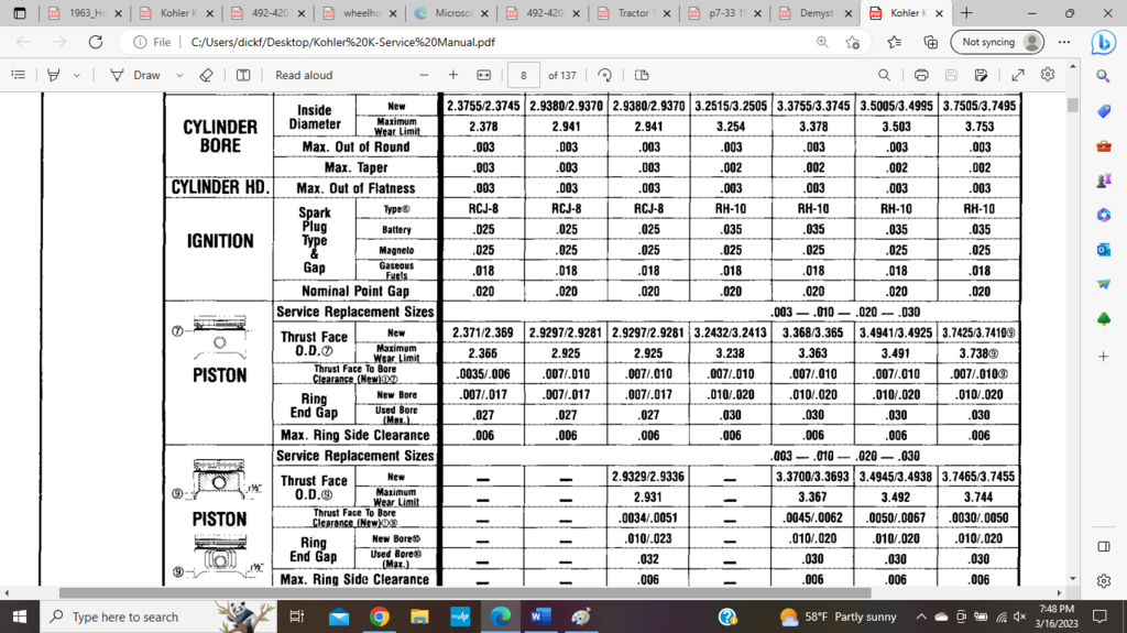

953 nut 64,340 #8 Posted March 16, 2023 2 hours ago, ebinmaine said: Not that one. Not sure if the other. My spec charts show differing information on plug gaps. I'm not sure what the effect of wrong gaps would be. This chart is in the Kohler Service Manual, same gaps. 2 Share this post Link to post Share on other sites
ebinmaine 77,556 #9 Posted March 17, 2023 18 minutes ago, 953 nut said: This chart is in the Kohler Service Manual, same gaps. May-happs it's me that's bassackwards??? Share this post Link to post Share on other sites
