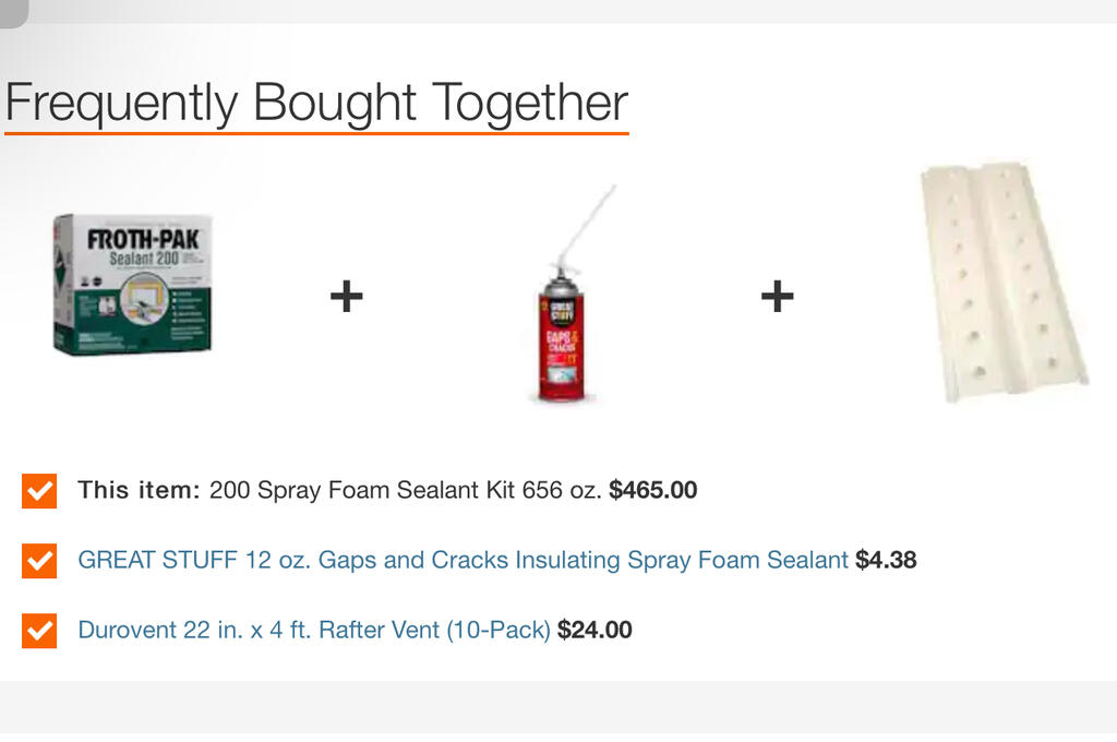

Pullstart 70,475 #1 Posted December 8, 2022 Since most of the basement walls are accessible right now, I’m thinking it might be a good time to insulate. I’m looking at cans, kits, etc. though possibly wasteful, I am appalled at the price difference of small 12 or 24 oz cans, vs a big kit. I BELIEVE that insulating with a spray foam over just batting can help with air leaks, mold, moisture, etc. Thoughts? Experience? The 200 board feet at 1” thick kit is $.71/oz. 12. oz. cans are $.36/oz. What gives? 2 Share this post Link to post Share on other sites

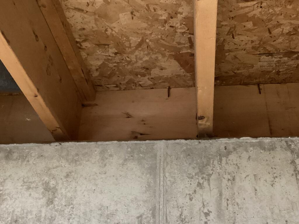

Pullstart 70,475 #2 Posted December 8, 2022 Also, our rim joists are 2x10 lumber, not plywood or OSB. Thoughts on foam board installation then spraying, vs spraying then adding batting? 2 Share this post Link to post Share on other sites
Jeff-C175 7,209 #3 Posted December 8, 2022 25 minutes ago, Pullstart said: What gives? Ease of application and the ability to cover larger areas quickly. My crawlspace is 'sealed'. Spray foam on all the rim and sill, 2" foam insulation on the walls, and the whole thing, walls and floor, completely covered with vapor barrier. 3 Share this post Link to post Share on other sites

WHX?? 57,291 #5 Posted December 8, 2022 (edited) 2 hours ago, Pullstart said: insulating with a spray foam over just batting Nety ney Jose... never foam over batting . foam first then batting if needed. You foam over batting yer done you can't get at moldy batts without ripping out foam. Your construction you want to foam right in the box sills right up against the rim board. Don't matter what the floor joists or rim board are. Lap the foam right down over the sill plate and onto the foundation wall. This seals all air gaps in the sill plate to foundation connection. Continue right down the foundation wall you got the coin. Any wall studs & wiring should be in first. Typically this is the last thing that gets done in say a basement finish off just before drywall goes on. You can stop just a couple inches down and batt the rest. I would do the whole wall... seals micro cracks that might be in the foundation & no vapor barrier needed. At least 3 inches in the box sills and nothing further needed. 1" foam = R-5 you know that. You think yer gonna do any kinda square footage with the big box stuff yer on crack. Needs to come out a 55 gallon drum which means a professional insulator. Prolly cheaper too. That froth pak is just for a small exterior wall project and its a getting it out of the can and a even coat. Don't ask me how I know. Yer paying for the cans not what's inside the cans and the gun to get it out that yer gonna throw away when done. Edited December 8, 2022 by WHX?? 5 Share this post Link to post Share on other sites

Horse Newbie 7,405 #12 Posted December 8, 2022 4 hours ago, Pullstart said: Also, our rim joists are 2x10 lumber, not plywood or OSB. Thoughts on foam board installation then spraying, vs spraying then adding batting? You talking about sealing between the top of concrete wall and the bottom of the rim joists ? 1 Share this post Link to post Share on other sites
Rob J. 1,942 #13 Posted December 8, 2022 (edited) I’d use 2” solid foam, cut to fit and glue them in. Then foam around where needed. Edited December 8, 2022 by Rob J. 4 Share this post Link to post Share on other sites
Pullstart 70,475 #14 Posted December 9, 2022 25 minutes ago, Horse Newbie said: You talking about sealing between the top of concrete wall and the bottom of the rim joists ? The entire vertical part… it’s really no R value to the great outdoors. 2 Share this post Link to post Share on other sites
Horse Newbie 7,405 #15 Posted December 9, 2022 Seal cracks with the foam- if between a rough opening and the door/window frame use low expansion, that way it won’t expand to the point of pushing on the frame enough to cause a door or window to not open or close properly. If you are sealing a crack between say the top of foundation wall and rim joist you can use the high expanding foam… it will not expand strong enough to move structural stuff. Then use batts with a vapor barrier with the vapor barrier facing the interior side. If you are adding insulation in an already insulated wall, take out batts that have a vapor barrier, put in the unfaced insulation, then put back the faced insulation with the vapor barrier facing the interior. You can add insulation in the attic using unfaced insulation… this is assuming that the insulation has either faced insulation with the vapor barrier facing down towards the interior. If the existing attic insulation has no vapor barrier, you can just add batts on top or spray in attic insulation. What ever you do just make sure you have the vapor barrier closest to the interior, and never go insulation-vapor barrier-insulation, and by the way, vapor barrier on insulation DOES NOT prevent vapor from passing through it… it does however only let the vapor pass through one way only. This is why some faced insulation actually says “ This side towards interior “ You want the vapor barrier to allow vapor to pass through to the outside 1 1 1 Share this post Link to post Share on other sites

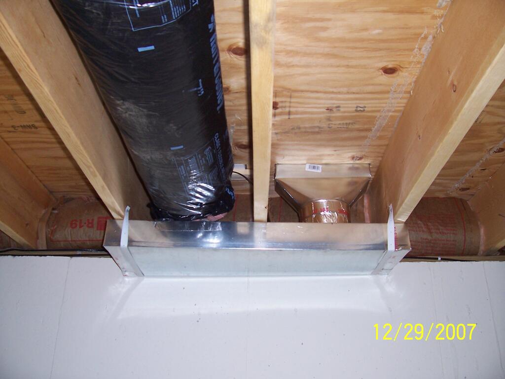

Zeek 2,299 #19 Posted December 9, 2022 I stuffed paper backed insulation bats in each one on my old house. Cheap, easy, fast, effective. 2 1 1 Share this post Link to post Share on other sites
Jeff-C175 7,209 #20 Posted December 9, 2022 1 hour ago, Zeek said: my old house How old? Looks like new construction! 2 Share this post Link to post Share on other sites
953 nut 67,276 #21 Posted December 9, 2022 8 hours ago, Jeff-C175 said: How old? Looks like new construction! Going by the date on the photo I guess it was in 2007. 2 Share this post Link to post Share on other sites
