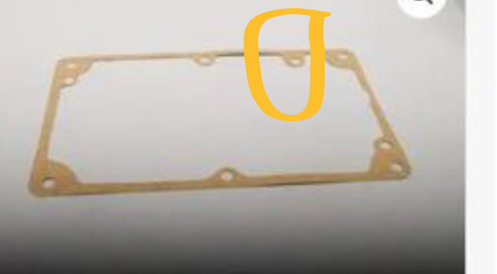

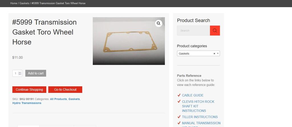

WHX??
Get one from Loweĺl... :)
  • Like 3
ebinmaine
I didn't see them listed for a hydro...
pfrederi
  • Like 1
  • Excellent 2
WHX??
Pretty sure he has them. Might want to give him a jingle. Didn't we get them from him when we did that Bronco refresh @Achto?
  • Like 3
ebinmaine
3 minutes ago, pfrederi said:
Niiiiice
Pullstart
I am probably wrong… but aren’t they the same gasket hydro or stick shift?
  • Like 3
  • Confused 1
pfrederi
Same thickness different patterm
  • Like 5
  • Thanks 1
ebinmaine
This hole is not in the gasket for a manual transmission.
  • Like 3
WHX??
:text-yeahthat:I think the sticks are a 3912.
  • Like 3
  • Thanks 1
pfrederi
Fluid return line going to filter...
  • Like 3
pacer
I just make my own, preferring a cereal box, but anything similar will do - bout 10 min and I got it.........
  • Like 2
  • Excellent 2
ebinmaine
1 minute ago, pacer said:
I just make my own,
I was gonna do that but I need to place an order with Lowell anyway.
  • Like 2
ebinmaine
Correct. Those are still available from Toro.
  • Like 1
