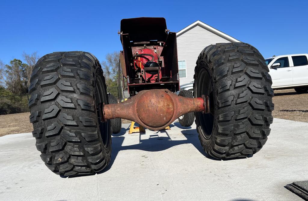

sjoemie himself 3,283 #51 Posted December 18, 2022 3 hours ago, 19richie66 said: Got the rear end in. Newb question here.. is that a stock WH rearend? 1 Share this post Link to post Share on other sites
19richie66 17,951 #52 Posted December 18, 2022 11 minutes ago, sjoemie himself said: Newb question here.. is that a stock WH rearend? Came out of a Panzer. It’s a narrowed 50’s Chrysler car axle. 1 2 Share this post Link to post Share on other sites

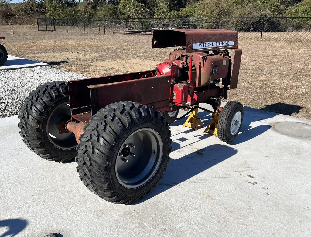

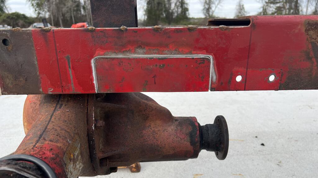

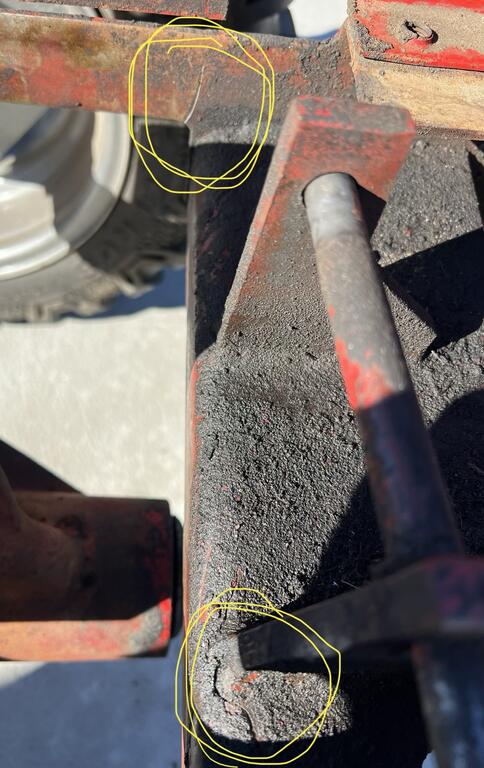

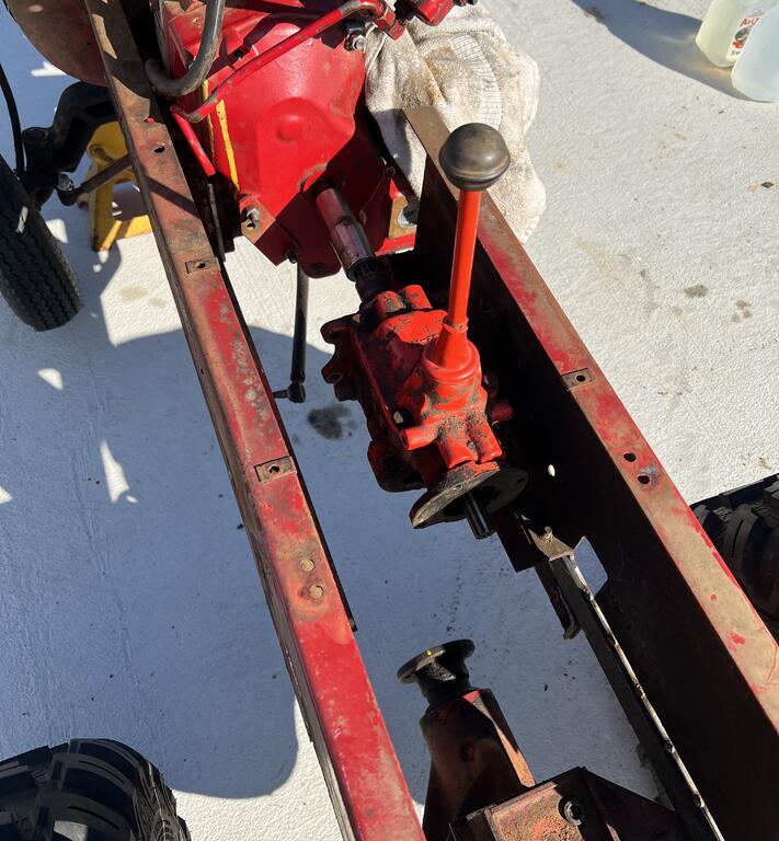

19richie66 17,951 #55 Posted December 18, 2022 (edited) Stole Skittles rear tires and put them on here with. 2” wheel spacer. Enough room behind the wheel to hopefully run disc brakes. Also found the frame cracked in two places. Cut out the cylinder mounting plate and will make a new one later. Welded in two 24” flat steel plates which I will fully weld in after all the figuring is done. Also trimmed up the side plates for a test fit. Not too bad. Looks like a pto sticking out. Once the foot plates are on it will look better. Time to fit the transmission. Edited December 18, 2022 by 19richie66 3 9 Share this post Link to post Share on other sites

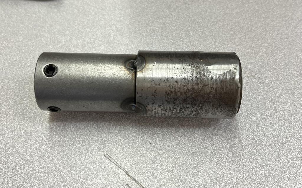

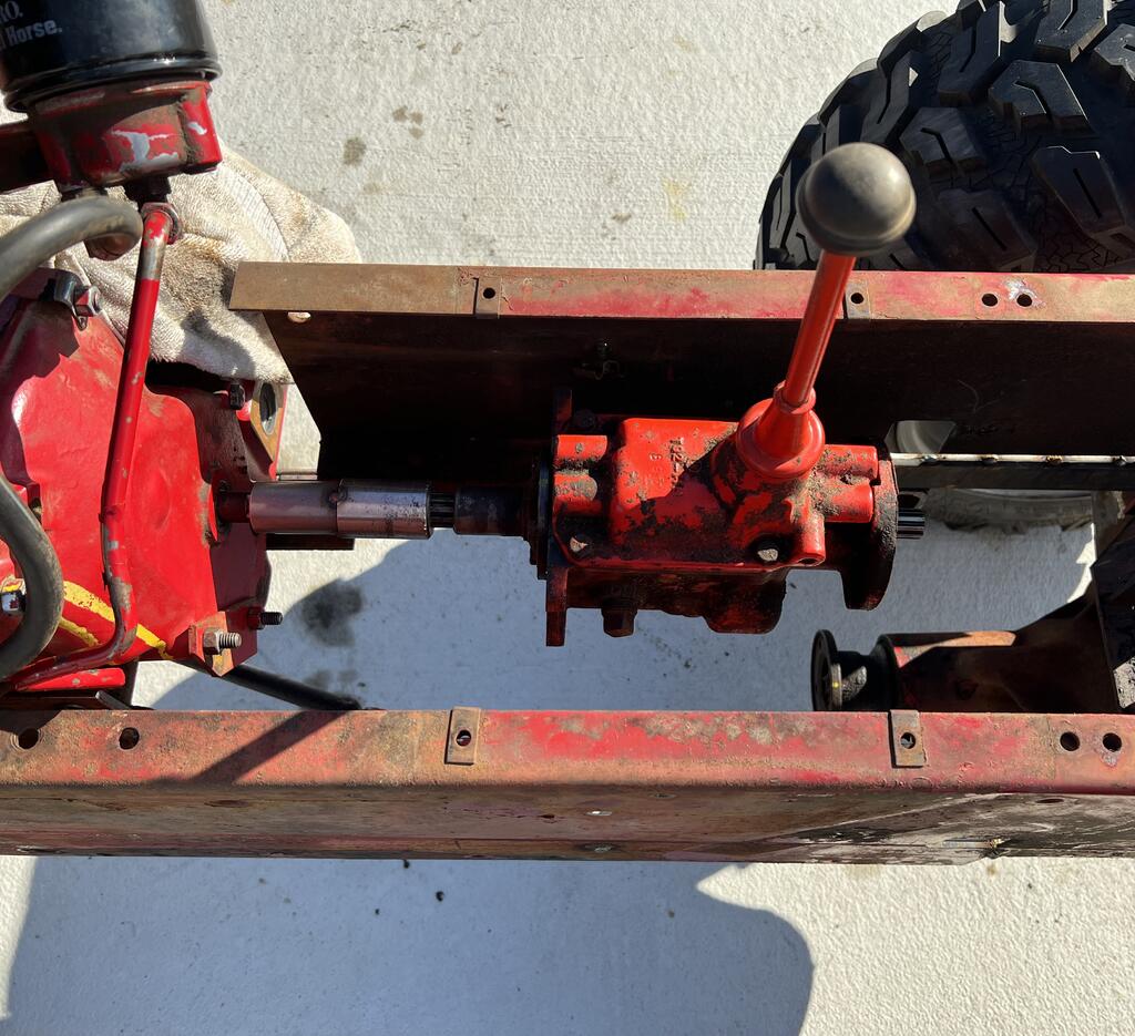

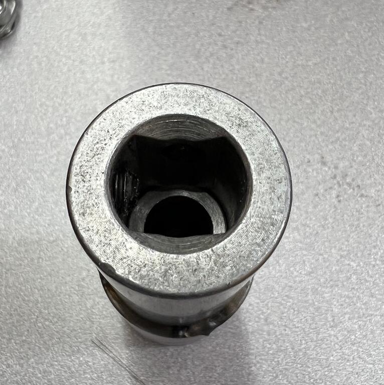

19richie66 17,951 #59 Posted December 23, 2022 Got my coupler figured out. Fingers crossed it is true. I machined a small insert to press fit into the centers of both and on the lathe it was good. Clamped it down real tight to tack weld it. Once I know it is straight, I’ll get it solidified. This will connect the hydro brake shaft to the 3 speed input shaft. Then I will run a chain down to the rear end pinion. 3 4 Share this post Link to post Share on other sites
Pullstart 71,564 #60 Posted December 24, 2022 Your abilities tell me it’s true Richie! The shadow, it’s making fun with my eyes! 1 Share this post Link to post Share on other sites

8ntruck 9,420 #62 Posted December 29, 2022 Might be a day late and a dollar short with this idea, but it might be a good idea to put a LoveJoy or a chain type coupling between the hydro and the transmission. Doing so would reduce the amount of precision needed in the alignment of the mounts for the hydro and the transmission. 1 1 1 Share this post Link to post Share on other sites
19richie66 17,951 #63 Posted December 29, 2022 15 minutes ago, 8ntruck said: Might be a day late and a dollar short with this idea, but it might be a good idea to put a LoveJoy or a chain type coupling between the hydro and the transmission. Doing so would reduce the amount of precision needed in the alignment of the mounts for the hydro and the transmission. Yeah I have been toying with that Idea. Just a matter of finding the right pieces. Going to get the mainshaft bearings replaced, transmission mounts made. I’ll make sure the front and rear are set into the right spot then I’ll see where I’m at. Appreciate the feedback.👍 2 Share this post Link to post Share on other sites

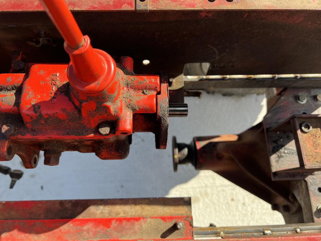

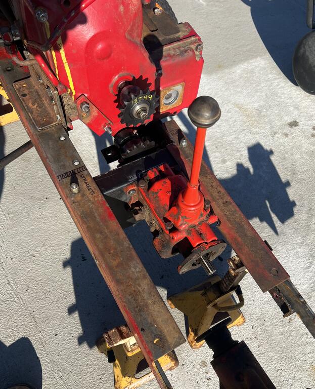

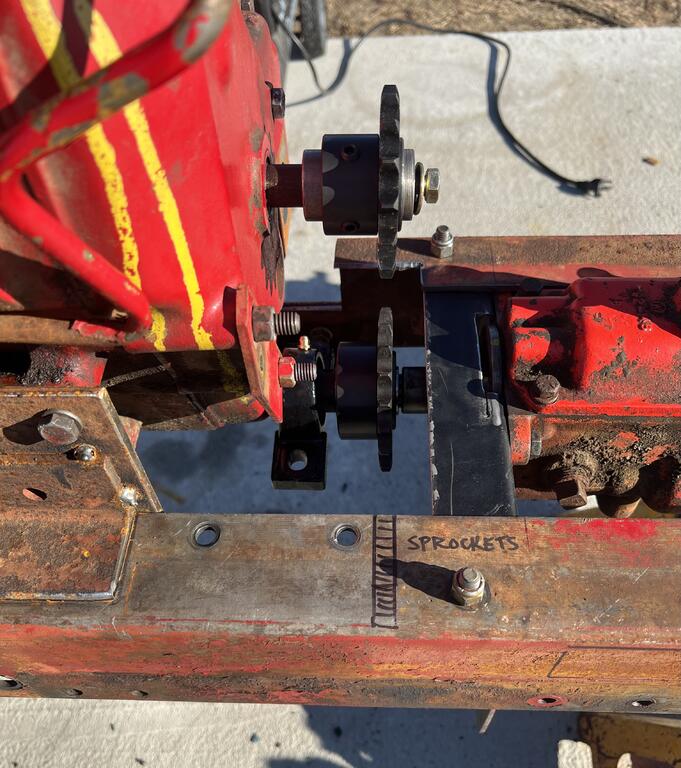

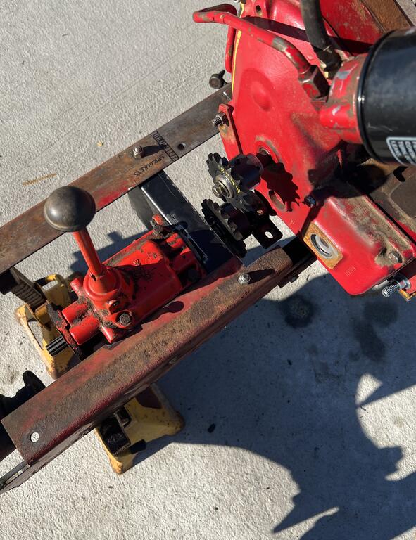

19richie66 17,951 #64 Posted December 30, 2022 @8ntruck I thought about your suggestion and decided to go with a chain up front. I cut my connector back apart as it had just a slight wobble to it. Decided against it. Bought two weld hubs and sprockets for the front. I’ll deal with the rear gearing after I get the transmission mounted. I ended up going with #50 chain, a 15 tooth on the hydro and a 19 tooth on the transmission input shaft. I also picked up a bearing for the tip of the input shaft. Going this way lets me slide the transmission further forward and lower so I won’t have long chains to deal with. With it lower and forward, I should be able to keep the three point but will have to run power steering. 😁 3 2 Share this post Link to post Share on other sites
19richie66 17,951 #65 Posted January 1, 2023 (edited) Test fit 2.0…….. Front mount roughed in. Still need to make a rear mount. Edited January 1, 2023 by 19richie66 2 4 1 Share this post Link to post Share on other sites
953 nut 70,662 #66 Posted January 2, 2023 I don't think a solid coupler like you were making would have held up, this is much better. 1 Share this post Link to post Share on other sites
19richie66 17,951 #67 Posted January 2, 2023 More adjustable this way too. 👍 3 Share this post Link to post Share on other sites

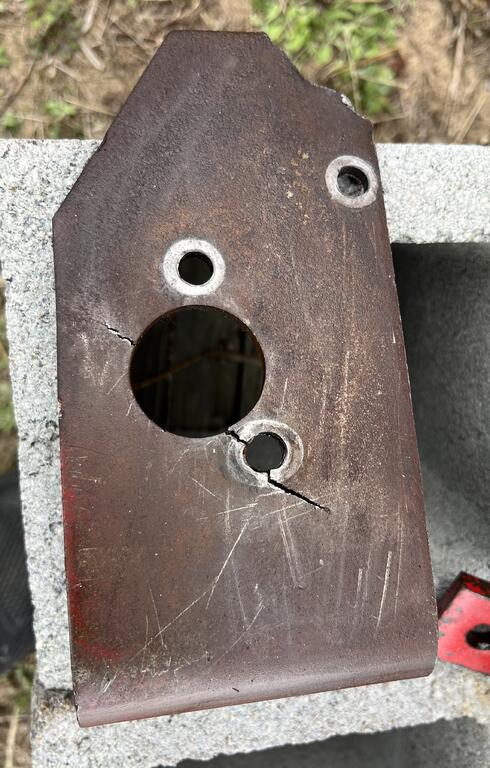

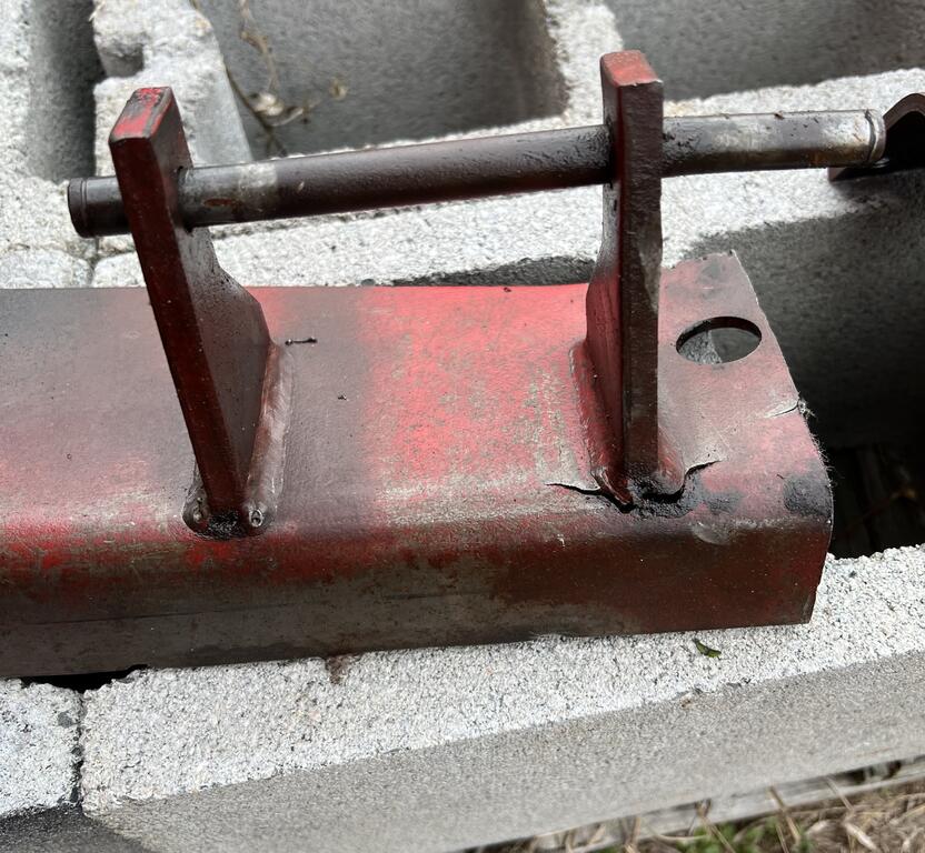

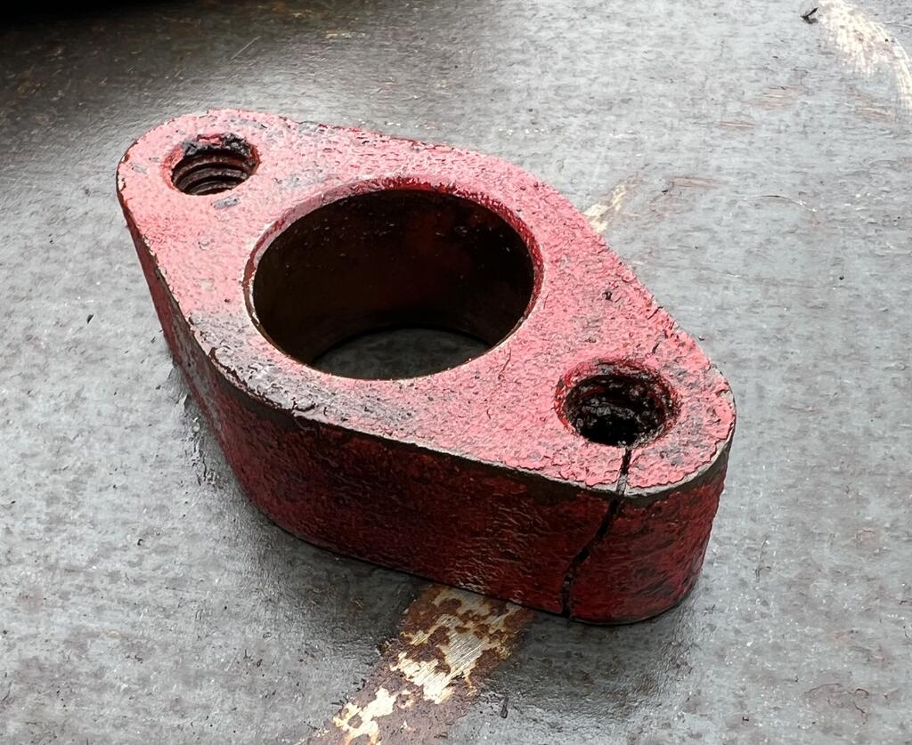

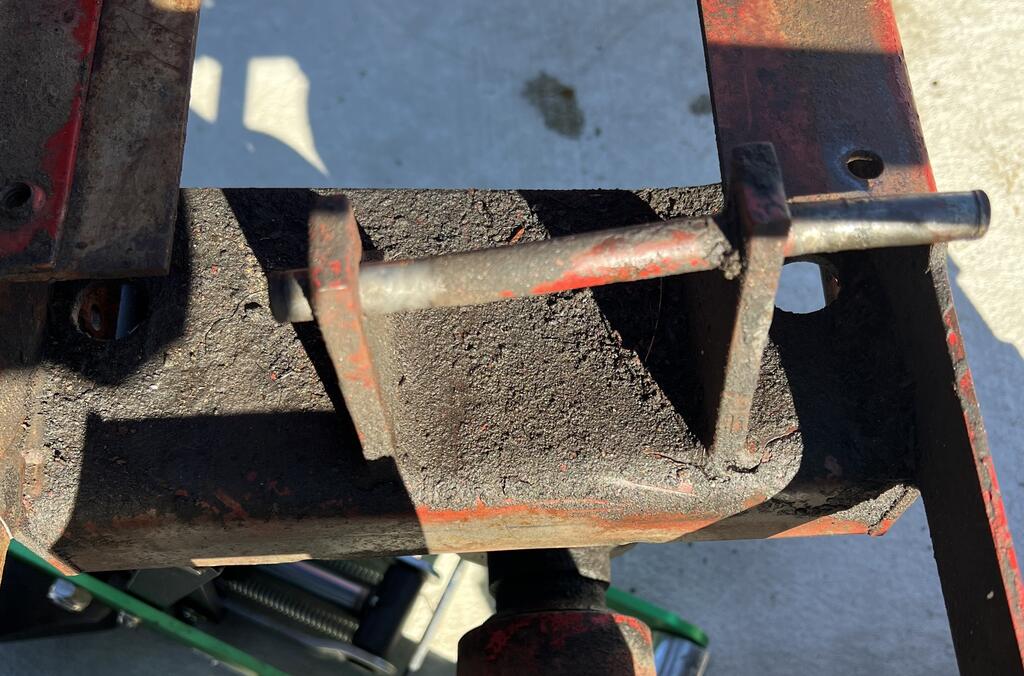

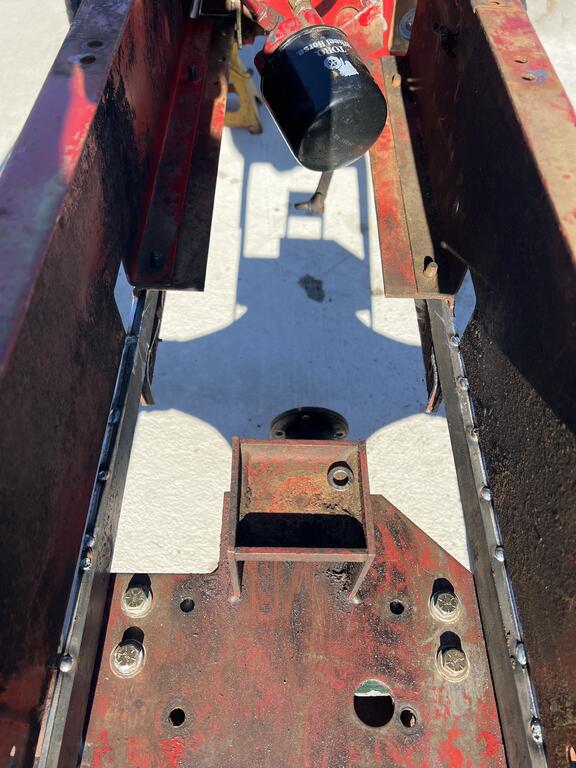

19richie66 17,951 #73 Posted January 9, 2023 This poor girl was worked hard. I was cleaning parts today and found damage under all the grease. Steering column bracket was almost split in half and the cylinder mount plate was twisted and cracked. I did get the 3 speed cleaned out and installed new front and rear bearings. 2 6 Share this post Link to post Share on other sites

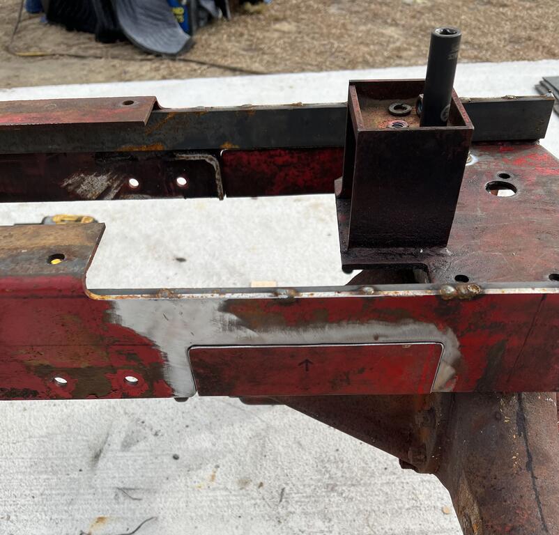

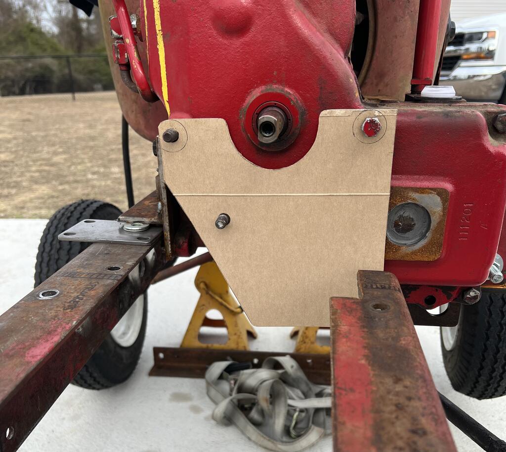

19richie66 17,951 #74 Posted January 10, 2023 (edited) Made some frame filler plates. Hopefully this will strengthen the rear of the frame a bit. Also made a pattern for a pilot bushing mount for the front of the transmission shaft. Not much but I didn’t want @WHX?? uncle Jim to think I wasn’t doing anything. Edited January 10, 2023 by 19richie66 4 1 1 Share this post Link to post Share on other sites
Lee1977 7,813 #75 Posted January 10, 2023 You do good work with cardboard. I would round that top right corner. Those sharp corners always come back to bite me. 1 1 Share this post Link to post Share on other sites
