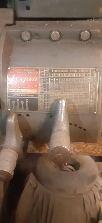

Oldskool 6,671 #1 Posted December 4, 2022 Today I had a chance to do a quick run through on my Logan. There was some slop here and there and some misalignment. Mostly dealt with. "Warning" some of the terminology may be a bit off. My biggest issue now is trying to get the play out of the control wheels that work the carriages. The video doesn't show all the play. There is about 3 tick marks worth of play before the indicator wheel moves with the handle. Then there is about 22 tick marks worth of play before the carriage moves with the handle. Any help would be greatly appreciated. 20221204_134744.mp4 1 Share this post Link to post Share on other sites
