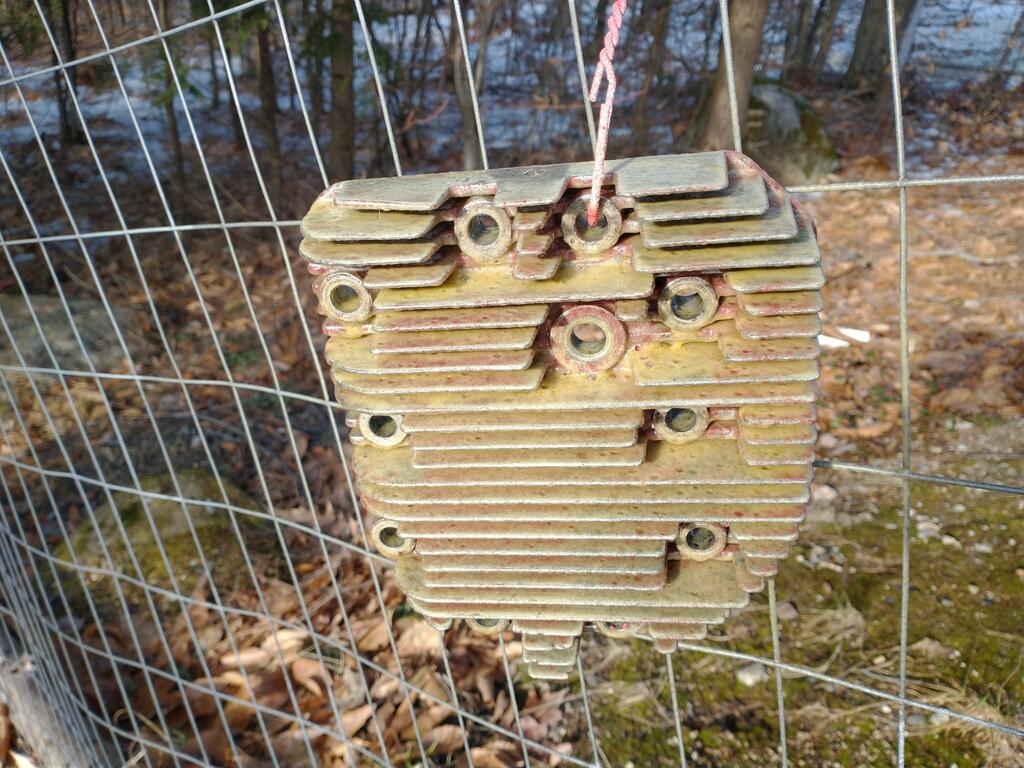

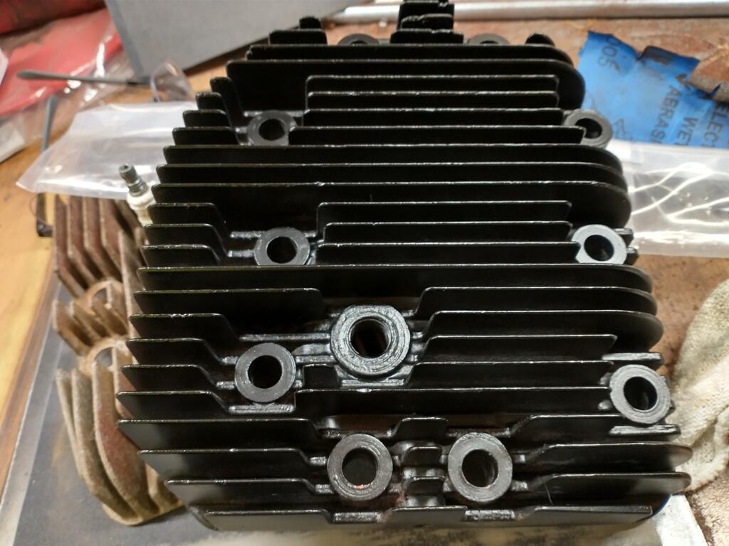

ebinmaine 80,471 #176 Posted December 29, 2022 We are trying Aircraft Remover to try to get the baked on super hard paint off the cylinder head 4 1 Share this post Link to post Share on other sites

Snoopy11 5,731 #180 Posted December 29, 2022 2 hours ago, ebinmaine said: We are trying Aircraft Remover to try to get the baked on super hard paint off the cylinder head Seafoam also works for that purpose!!! Don 1 Share this post Link to post Share on other sites
Lee1977 7,756 #181 Posted December 29, 2022 (edited) Just give it a light coat of aluminum paint and install it. You don't need to fill up that new building with incomplete projects. Edited December 29, 2022 by Lee1977 1 4 Share this post Link to post Share on other sites
ebinmaine 80,471 #182 Posted December 29, 2022 34 minutes ago, Lee1977 said: Just give it a light coat of aluminum paint and install it. You don't need to fill up that new building with incomplete projects. I ASSURE you that will not happen. I don't want to add paint to the head. If that was the acceptable form I would have already done it. 1 Share this post Link to post Share on other sites
Lee1977 7,756 #183 Posted December 29, 2022 1 minute ago, ebinmaine said: I ASSURE you that will not happen. I don't want to add paint to the head. If that was the acceptable form I would have already done it. Your the Dremel expert order up those wool polishing pads and some metal polish. Around 35 to 40 dollars worth from Amazon and polish it to a high gloss . Then take it out in the snow and get water spot all over it. We want you to be happy. 1 Share this post Link to post Share on other sites

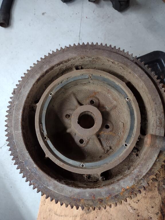

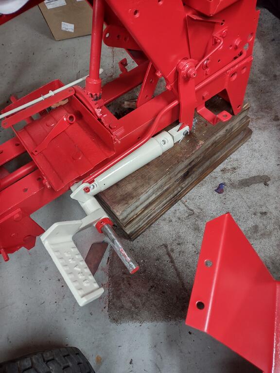

ebinmaine 80,471 #184 Posted December 30, 2022 (edited) Trina got the seat pan ready for paint today. Removed the original 1974 rear light. Cute little round push/turn bulb 💡 in it. She hammer and dollied several areas to get it close to straight. Then she spent some time hand sanding the whole thing and cleaning it up with acetone. Primer tomorrow. In the reassembly department she put the hydraulic cylinder and brake/neutral pedal on. I got the engine drive pulley off. Removed the flywheel screen using the AWESOME new manual impact driver o got today. Also pulled the flywheel and cleaned the block a little. Note the little nests between every magnet. Edited December 30, 2022 by ebinmaine 3 5 Share this post Link to post Share on other sites
oliver2-44 11,717 #185 Posted December 30, 2022 2 hours ago, ebinmaine said: Note the little nests between every magnet. Now EB before you start heavy handed cleaning, you know there are little round aluminum tube spacers between those magnets- 1 1 1 Share this post Link to post Share on other sites
ebinmaine 80,471 #186 Posted December 30, 2022 5 hours ago, oliver2-44 said: Now EB before you start heavy handed cleaning, you know there are little round aluminum tube spacers between those magnets- No sir I did not know that! First time I've seen those used. These are clearly made into little paper wasp or other insect nests. 2 Share this post Link to post Share on other sites

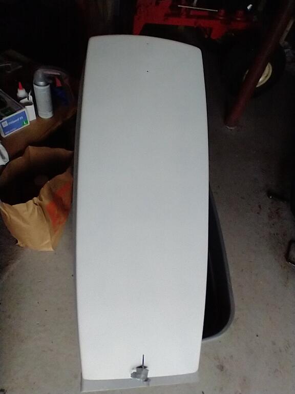

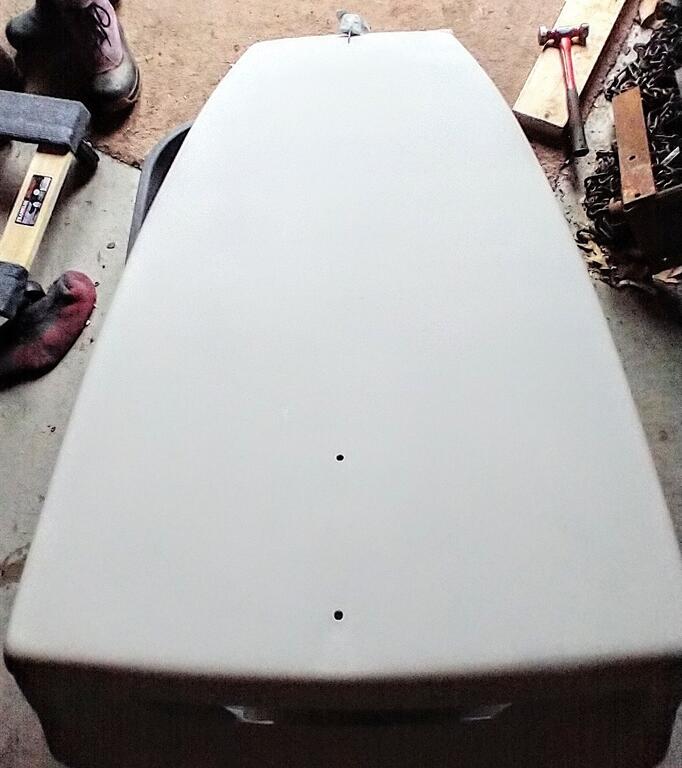

ebinmaine 80,471 #187 Posted December 30, 2022 The Paint Department has been working on this hood off and on. Several coats of filler primer after the body filler was put on. Maybe three coats? Of the white primer. A little sanding with 400 to 600 grit paper in between a bunch of that. For her first attempt ever at body work I'd say this borders on stellar. She's a super happy girl. 7 Share this post Link to post Share on other sites

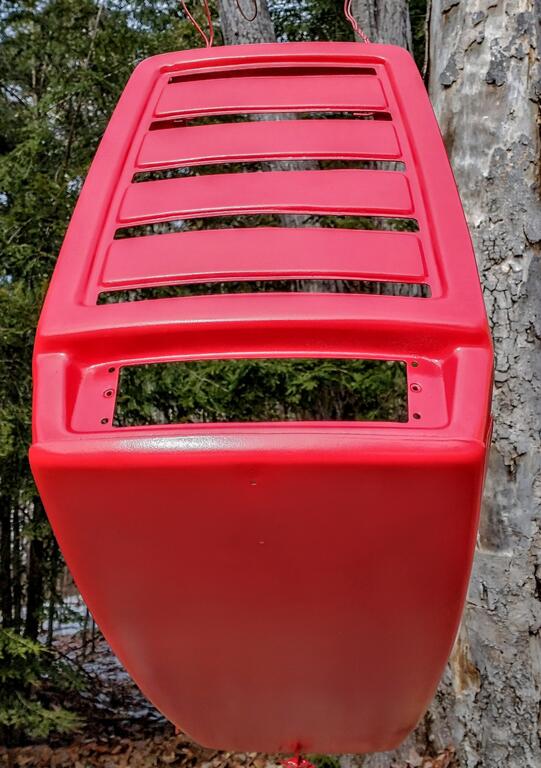

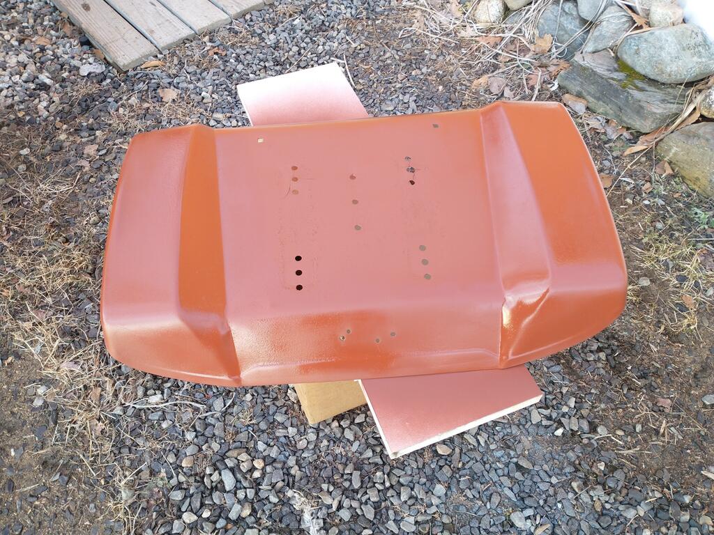

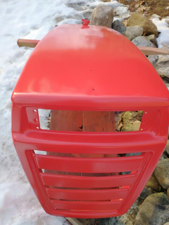

ebinmaine 80,471 #191 Posted December 30, 2022 Two coats of red on the inside and one coat on the outside. 2 3 Share this post Link to post Share on other sites

ebinmaine 80,471 #194 Posted December 30, 2022 The hood is done as much we'll do...for now. Trina's still picking out spots she wouldn't mind fixing but it isn't a show tractor. It's immediately being put to work plowing snow. Trina put 4 good strong coats of Rust-O-leum 2X Red Oxide Primer on the rear fender/ seat pan. That'll dry overnight or more then she'll sand it off and paint it red. As for the cylinder head which had absolutely HARD BAKED on paint... We are only able to remove so much because the aluminum itself is stained. Without getting into a bead blaster (I can see that being in our arsenal of tools but not yet) we opted to put a VERY thin coat of flat black high heat paint on it. The transmission pump may get the exact same treatment. 2 1 Share this post Link to post Share on other sites
kpinnc 18,916 #195 Posted December 31, 2022 7 hours ago, ebinmaine said: The transmission pump may get the exact same treatment. Looks real nice! I've painted Kohler heads many times before. One light coat to to "slick" it and prevent it corroding won't hurt anything. 3 1 Share this post Link to post Share on other sites
ebinmaine 80,471 #196 Posted December 31, 2022 8 hours ago, kpinnc said: Looks real nice! I've painted Kohler heads many times before. One light coat to to "slick" it and prevent it corroding won't hurt anything. I thought about going with off-white like the rest of the engine. I chose black for two reasons. It covers far better. Black will dissipate the heat slightly better than white. 2 Share this post Link to post Share on other sites
Horse Newbie 7,405 #197 Posted December 31, 2022 3 hours ago, ebinmaine said: Black will dissipate the heat slightly better than white I thought black absorbed heat and white repelled heat… 1 Share this post Link to post Share on other sites
Lee1977 7,756 #198 Posted December 31, 2022 9 minutes ago, Horse Newbie said: I thought black absorbed heat and white repelled heat… That's true, but the heat is coming from the inside. 1 Share this post Link to post Share on other sites
Horse Newbie 7,405 #199 Posted December 31, 2022 (edited) 1 minute ago, Lee1977 said: That's true, but the heat is coming from the inside. So a black head will “draw” more heat from the cylinder ? Which will then dissipate through the cooling fins ?… Edited December 31, 2022 by Horse Newbie 1 Share this post Link to post Share on other sites
Lee1977 7,756 #200 Posted December 31, 2022 4 minutes ago, Horse Newbie said: So a black head will “draw” more heat from the cylinder ? Which will then dissipate through the cooling fins ?… I don't think there would be much difference, but the white paint might not dissipate heat as quick. 1 Share this post Link to post Share on other sites
