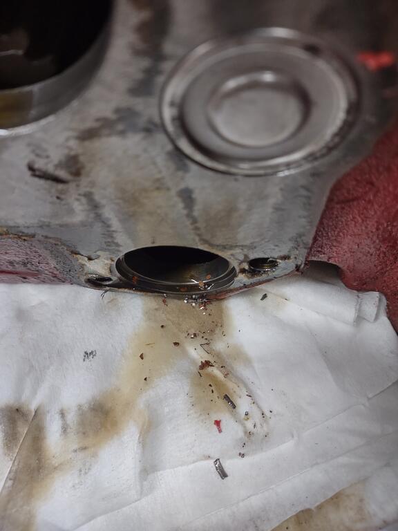

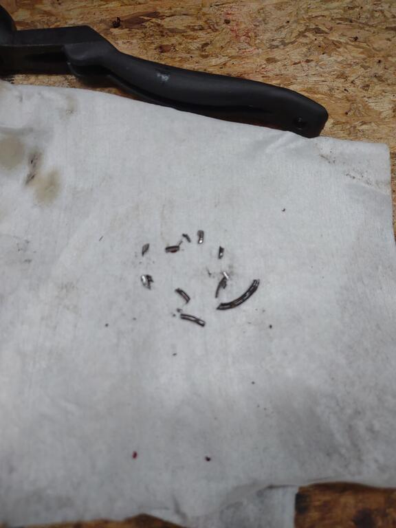

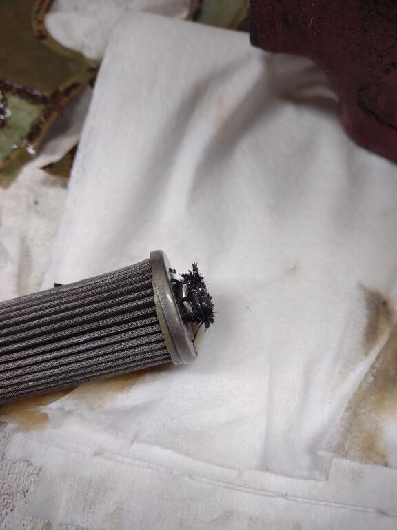

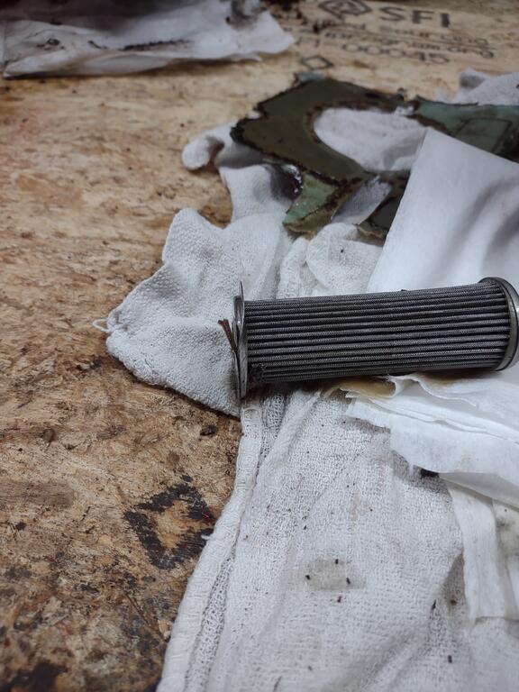

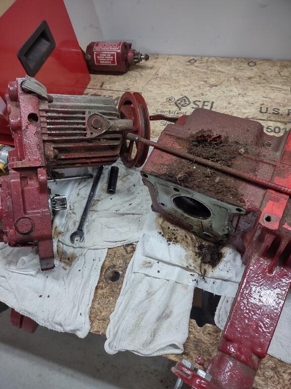

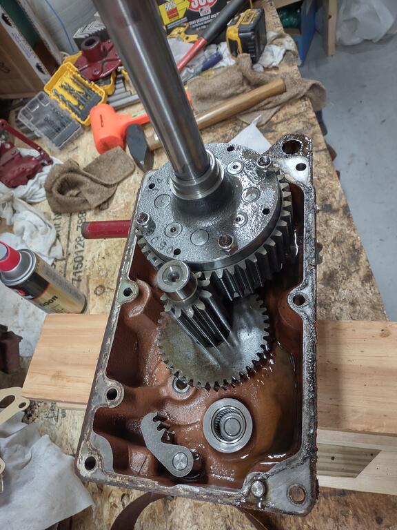

ebinmaine 81,038 #52 Posted December 3, 2022 I had the Local Heavyweight Lifting Department gimme a hand getting the transuhmasshion n pump up to the workbench. Got the other two hoses off and pump separated from the unidrive section. Did a bit of vacuuming and cleaning. Removed the screen from the case half. Didn't exactly like what I found... Looks like the remnants of an old bearing cage... 5 1 Share this post Link to post Share on other sites

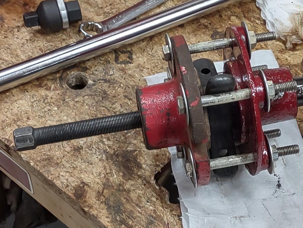

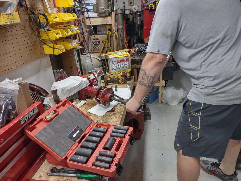

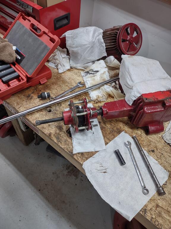

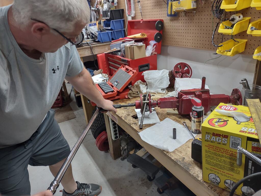

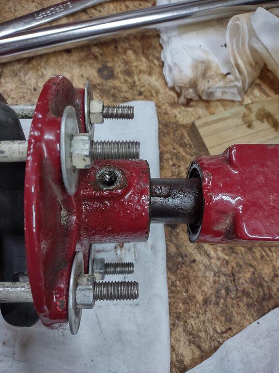

ebinmaine 81,038 #53 Posted December 3, 2022 Made a little more headway this afternoon. Brake arm off. Set up my hub puller. Made some progress... Going slow.... But going... And this is where all production came to a screeching halt. I have a video to put together as well. I'll post it later. I'll let it set for a bit and try again. 3 1 Share this post Link to post Share on other sites

WHX?? 58,310 #55 Posted December 4, 2022 (edited) 2 hours ago, Snoopy11 said: Bro... where are your socks?????? Ain't cause @stevasaurus has them... What's up with the star hubs EB? Shouldn't it have had the stronger ones like the puller hub? Paint looks fresh too? Be careful those star hubs shatter easy... looks like you might have a woodruff hung up? Edited December 4, 2022 by WHX?? 1 1 2 Share this post Link to post Share on other sites
ebinmaine 81,038 #56 Posted December 4, 2022 6 minutes ago, WHX?? said: Ain't cause @stevasaurus has them... What's up with the star hubs EB? Shouldn't it have had the stronger ones like the puller hub? Paint looks fresh too? Be careful those star hubs shatter easy... looks like you might have a woodruff hung up? Them 5 star hubs are the originals. These may very well end up in your hands. Fresh paint would be from the repaint back in 2012. I'd agree with your assessment on the hung up key. Any advice for how to proceed? 2 Share this post Link to post Share on other sites
WHX?? 58,310 #57 Posted December 4, 2022 1 hour ago, ebinmaine said: Them 5 star hubs are orginals Really ... that floors me... what year did you say ? I thought they were discontinued in the later 60s? 1 hour ago, ebinmaine said: These may very well end up in your hands. Bring em on... 1 hour ago, ebinmaine said: Any advice for how to proceed? Very gently... or just put the moxie to them... well maybe not I'm heavy on 1 inchers not so much on 1 1/8. 2 Share this post Link to post Share on other sites
ebinmaine 81,038 #58 Posted December 4, 2022 4 minutes ago, WHX?? said: Really ... that floors me... what year did you say ? I thought they were discontinued in the later 60s Oh no no. I've had several 74s with em. This is a 75. Seems to me the thicker hubs started a couple few years after this model year. 6 minutes ago, WHX?? said: Very gently... or just put the moxie to them... well maybe not I'm heavy on 1 inchers not so much on 1 1/8. We'll toss a flame at them tomorrow. 2 Share this post Link to post Share on other sites
WHX?? 58,310 #59 Posted December 4, 2022 (edited) 12 minutes ago, ebinmaine said: Oh no no. I've had several 74s with em. This is a 75. Is that right? I believe ya you say so...well just be careful...don't ask me how i know... I don't know if the heat wrench is going to help you out but it won't be lack for trying... maybe try a smaller punch down the key to try and re-seat it it???? Just thinking out loud here. Edited December 4, 2022 by WHX?? 3 Share this post Link to post Share on other sites
8ntruck 9,358 #60 Posted December 4, 2022 That punch idea sounds like a good one. Watch how hard you hit the key - you don't want to mushroom the end. Might try to rotate the hub on the shaft. That might rock the key loose. 4 Share this post Link to post Share on other sites
ebinmaine 81,038 #61 Posted December 4, 2022 5 minutes ago, 8ntruck said: rotate the hub Any ideas how to do so? 2 Share this post Link to post Share on other sites
WHX?? 58,310 #62 Posted December 4, 2022 Lock the other side up and try wiggling it back and forth? Any chance you can get the other side off easier? 2 Share this post Link to post Share on other sites
8ntruck 9,358 #63 Posted December 4, 2022 1 hour ago, ebinmaine said: Any ideas how to do so? Put the tractor back together and bang it between full forward and full reverse a few times? 2 Share this post Link to post Share on other sites
SylvanLakeWH 32,764 #64 Posted December 4, 2022 Have BBT take it upstairs in the new barn, put it in the middle of the room, and do her thing... If that doesn't work, then have her teach it a lesson... 4 Share this post Link to post Share on other sites
ebinmaine 81,038 #65 Posted December 4, 2022 9 hours ago, WHX?? said: Any chance you can get the other side off easier? That might be the way to go.... 2 Share this post Link to post Share on other sites
NA73 82 #66 Posted December 4, 2022 over the years with various other machinery, I've found that sometimes speed is the key when pulling a stuck hub - once it starts moving you need to keep it moving - as long as the force applied isn't going to break parts. hand tools are good most of the time. but there is a time and a place for using an impact gun. I'm guessing that you'll replace the seals anyway so no real harm in warming up the hub with a bit of fire. 3 Share this post Link to post Share on other sites

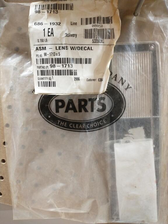

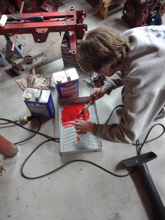

ebinmaine 81,038 #67 Posted December 4, 2022 More progress this evening. Hub is OFFF!! Casualty of action... My puller is kaput. No worries. It was a cheapo that shouldn't have lasted even this long. I found a bag of N. O. S. gaskets. Still need to source a couple (?) more. The Paint Department BBT is working on the frame and steering tower. Front spindles and tie rods off. I won't be using them. Sanding is done. She's getting everything cleaned up with acetone. Got some engine decals in the post from @Vinylguy Terry. 2 sets there. One is for this tractor. Also found an N. O. S. Later style headlight lense. Ain't likely we'll use it on this one as it'll be a worker. 3 3 Share this post Link to post Share on other sites
RandyLittrell 3,946 #68 Posted December 5, 2022 2 hours ago, ebinmaine said: Also found an N. O. S. Later style headlight lense. Ain't likely we'll use it on this one as it'll be a worker. Thems gold these days!!! Good find! Randy 1 1 Share this post Link to post Share on other sites
ebinmaine 81,038 #69 Posted December 5, 2022 3 minutes ago, RandyLittrell said: Thems gold these days!!! Good find! Randy Had you in mind when I found that... 3 Share this post Link to post Share on other sites

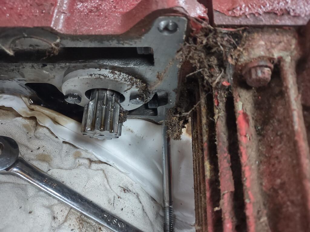

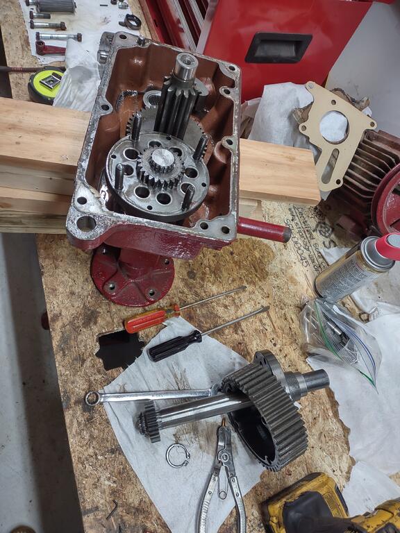

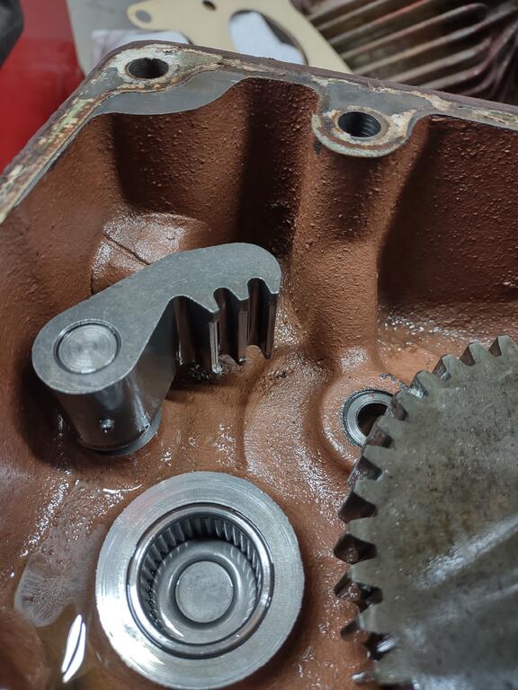

ebinmaine 81,038 #72 Posted December 6, 2022 BBT/The Paint Department/Trina messed with the qt can of paint some. Fiddling with mixtures along with using a brush and roller. Again I remind you fine folks how NOT to clean a thing. I worked on disassembling the transmission some more. The end of the axle is mushroomed. I'll have to file or grind it down so I can remove the gear. You can see the park pawl is chipped but very usable. I still don't see the reason for the metal pieces..... Yet. 5 Share this post Link to post Share on other sites
