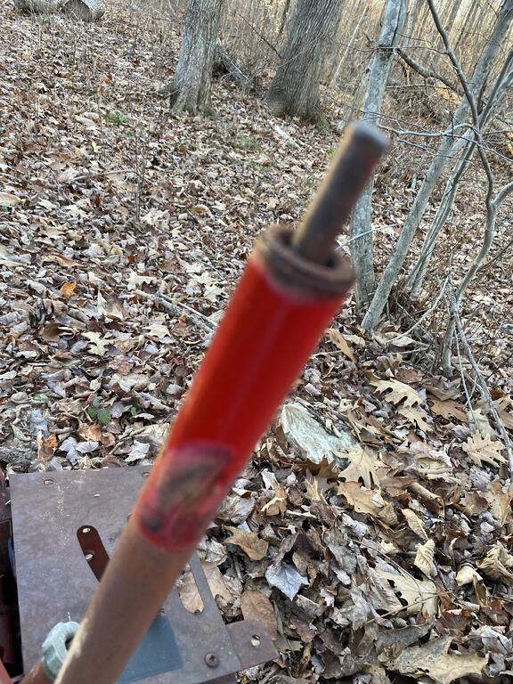

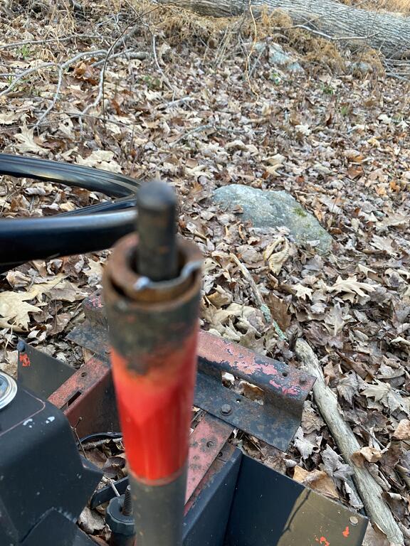

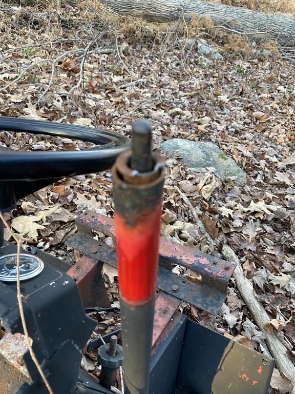

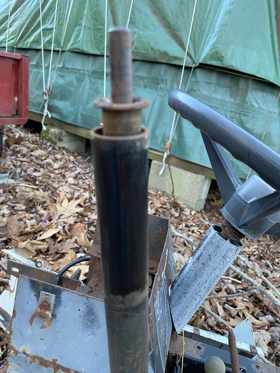

Sparky-(Admin) 25,934 #14 Posted November 26, 2022 5 hours ago, squonk said: Check the spring inside the lift arm. It's the spring that keeps the thing in the slot Part # 3624 in your program! https://www.partstree.com/models/21-08k802-308-8-toro-lawn-tractor-1986/manual-lift-linkage-17/ Ok…I sliced off the plastic grip on a couple junker parts machines to try to learn about the spring and its replacement. Looking at that diagram you linked it seems like it would be right there under the grip. Sliced off two grips and neither had a spring that I could see. I managed to pry up that inner sleeve looking thing but wasn’t able to actually get one out of the handles tube. 1 Share this post Link to post Share on other sites

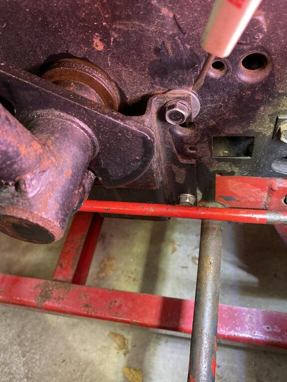

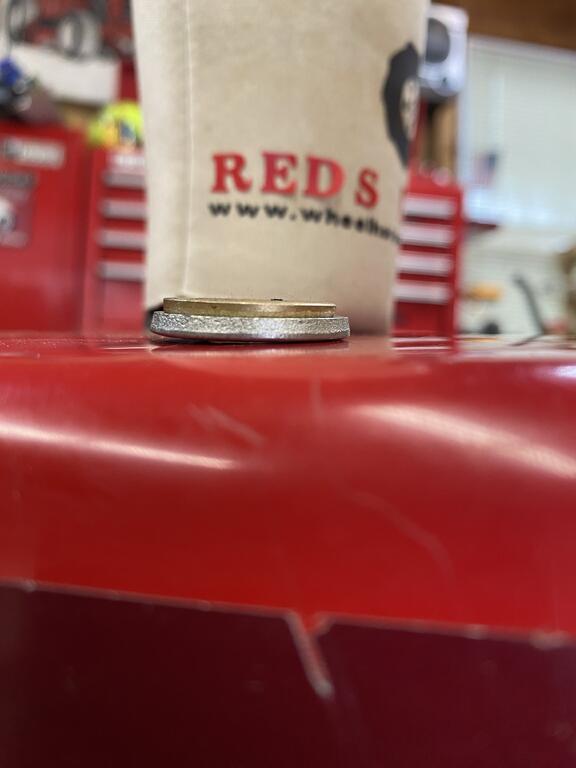

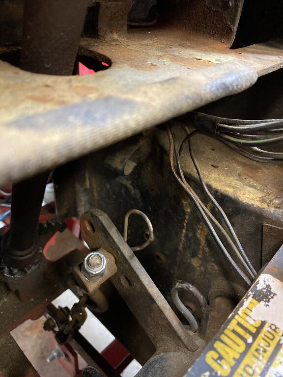

Sparky-(Admin) 25,934 #23 Posted November 27, 2022 So I tried all three lift holes with no change. Backed off on the eyebolt chain thingy, it might have been a bit better after that. It just seems that everything is sloppy and worn out (dang thing isn’t really all that old being a 1987 ). I ended up adding thin washers under this piece (see picture) and saw improvement. Took it apart and added a thicker washer and it improved even more. Still drops but not as much. 1 Share this post Link to post Share on other sites

Jeff-C175 7,209 #25 Posted November 27, 2022 31 minutes ago, Sparky said: added Leads me to believe that detent is rounded over. Can you see where the rod drops into the detent? Share this post Link to post Share on other sites
