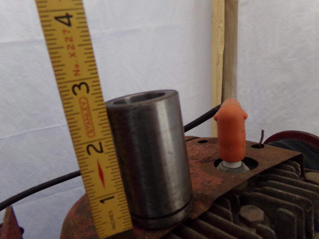

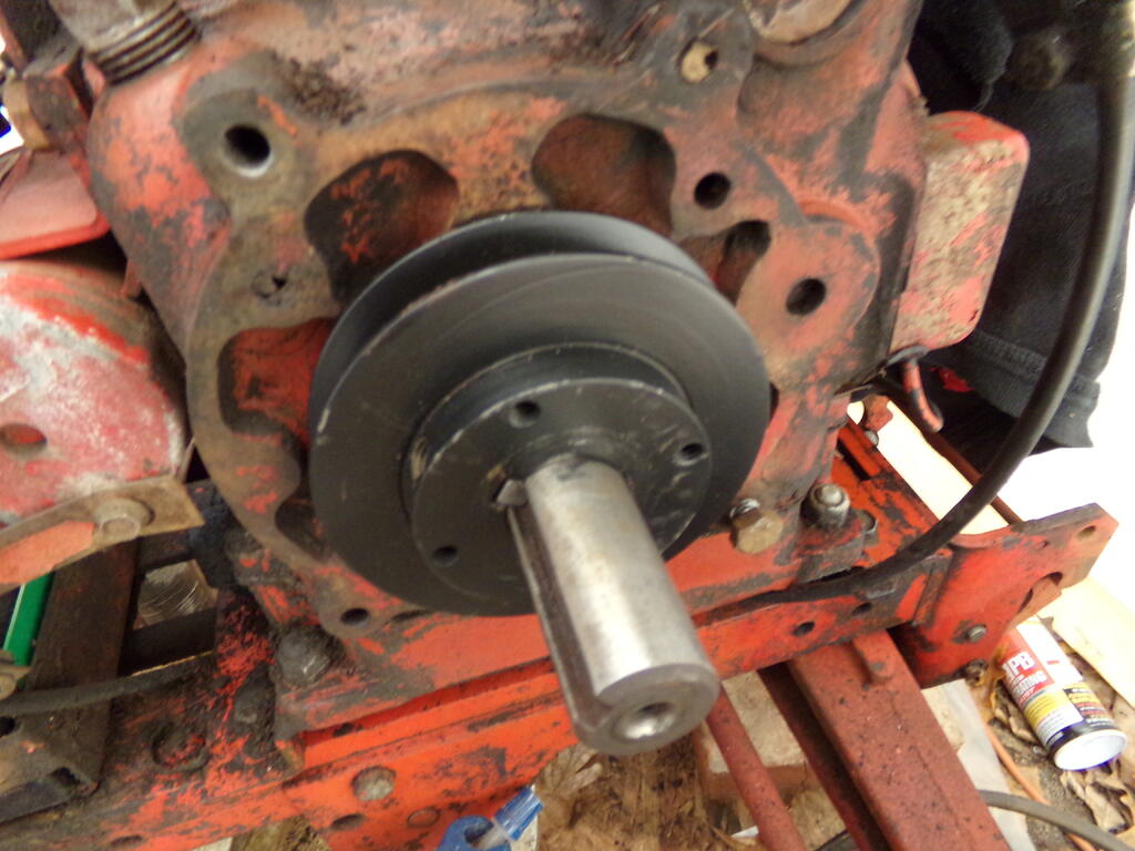

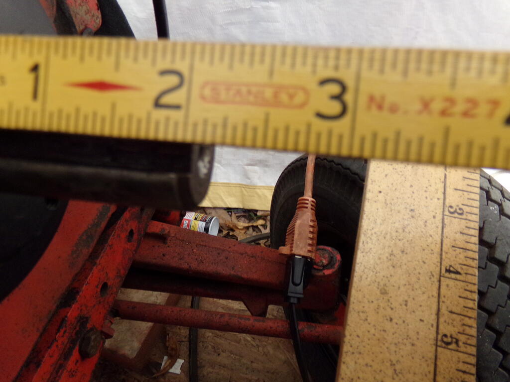

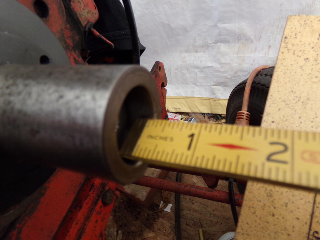

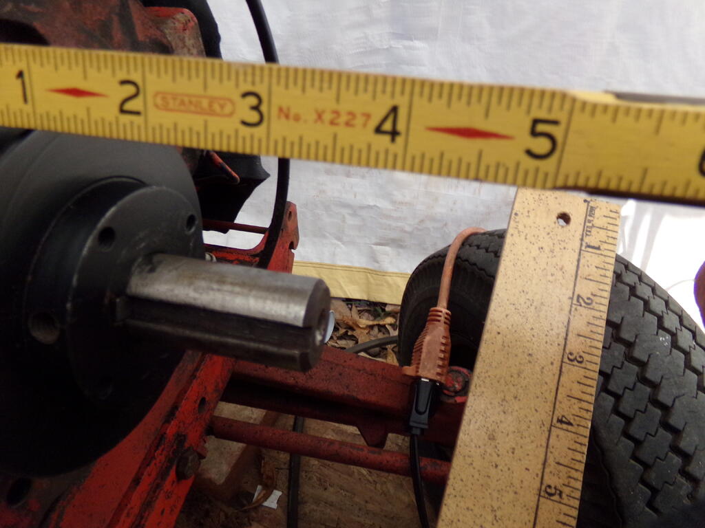

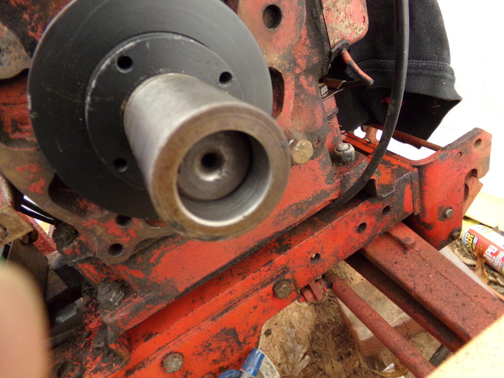

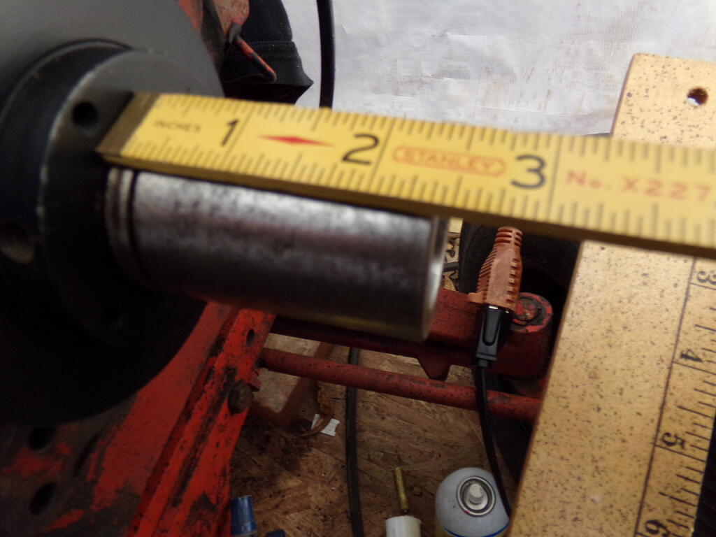

elcamino/wheelhorse 9,362 #1 Posted November 24, 2022 I installed the new drive pulley on the Waldomobile by aligning the outside edge of drive pulley and trans pulley with a straight edge . The bearing sleeve extends 1 1/4 inches beyond the end of of the crank shaft . Does that sound right ? The instructions for the PTO does not give any measurements. Help ! 1 Share this post Link to post Share on other sites

elcamino/wheelhorse 9,362 #4 Posted November 24, 2022 It is a 8 hp K181s with a 3 1/2" crank . I checked the bearing sleeve on my c-120 1974 and it is even with the end of the shaft. I checked the original drive pulley with the new pulley and they are exactly the same size. The old drive pulley was only a 1/16 off the block so I adjusted the new pulley to that measurement and the bearing sleeve is 7/16 inched from the end of the crank. I have several old bearing sleeves and they are all the same length. I can't remember if the bearing sleeve extended on the crank when I went to remove it and pulley but I have a vague memory of the sleeve being longer than the crank. Any suggestions would help. 1 Share this post Link to post Share on other sites
Snoopy11 5,718 #5 Posted November 24, 2022 I second what Pete said. We need pictures. I think I understand what you are saying Jim... but I need to see it before I give advice... Don 1 Share this post Link to post Share on other sites
elcamino/wheelhorse 9,362 #6 Posted November 24, 2022 Okay pictures are attached I hope . The 3 rd picture is with the pulley attached. I measured crank shaft before installing pulley. 3 Share this post Link to post Share on other sites
Snoopy11 5,718 #7 Posted November 24, 2022 41 minutes ago, elcamino/wheelhorse said: vague memory of the sleeve being longer than the crank Other members can chime in but that looks fine/right to me... If you didn't like the look of how it extends, you could probably hack some of the sleeve off with a band saw... but personally, I'd leave it alone. Don 3 1 Share this post Link to post Share on other sites

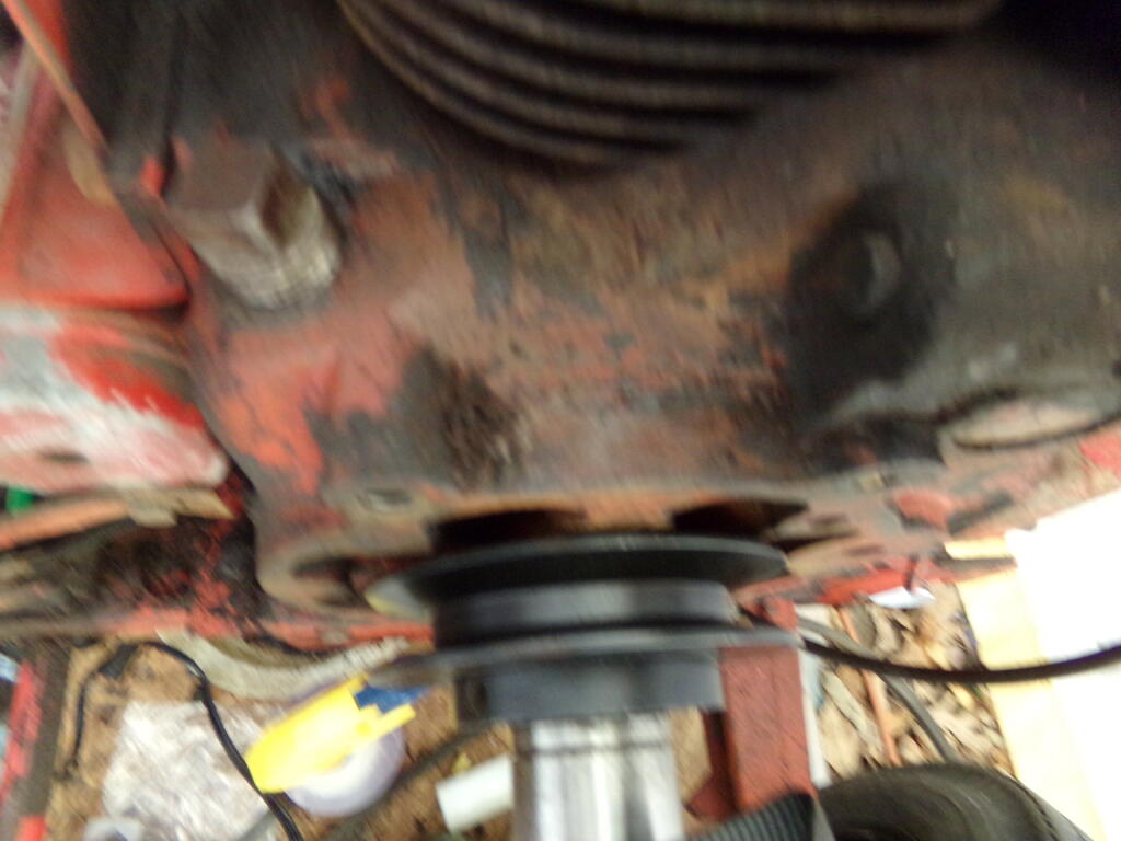

elcamino/wheelhorse 9,362 #15 Posted November 25, 2022 (edited) The dogs sleeping on you ? The bearing sleeve I installed is the same as the one I took off. I am going to try to see how it runs tomorrow. I am concerned about the pulley clearage to the block . Only about 1/16 inch. Edited November 25, 2022 by elcamino/wheelhorse Share this post Link to post Share on other sites
