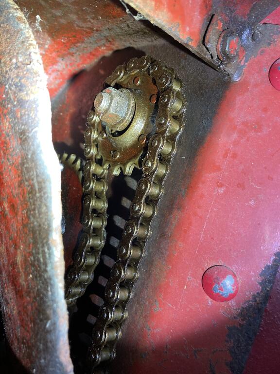

JerryLook 84 #28 Posted December 23, 2022 Ok I’ll attach a spring to it there. Another little question. I’ve noticed the chain on the snowblower has gotten a lot looser recently. Is there a way to tighten it, or do I need to replace it? 1 Share this post Link to post Share on other sites
JerryLook 84 #29 Posted December 23, 2022 Ok I found another thread where it says the bottom pulley should be in a slotted hole. So it sounds like I loosen that and move it to tighten the chain. When I was using the blower just now it started making a rumbling sound. The only thing I can see wrong is the chain is really loose. 1 Share this post Link to post Share on other sites
lynnmor 8,899 #30 Posted December 24, 2022 4 hours ago, JerryLook said: Ok I found another thread where it says the bottom pulley should be in a slotted hole. So it sounds like I loosen that and move it to tighten the chain. When I was using the blower just now it started making a rumbling sound. The only thing I can see wrong is the chain is really loose. While you have that sprocket loose to adjust it, check both sprockets for excess movement or roughness. The chain should have chain lube applied after every use. If the chain is rusted or worn, replace it before it takes out the sprockets. 1 Share this post Link to post Share on other sites

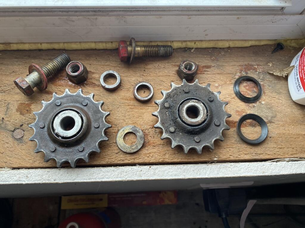

lynnmor 8,899 #38 Posted December 24, 2022 1 hour ago, peter lena said: @JerryLook MERRY CHRISTMAS ! use a small putty knife to remove bearing side shields , wipe out existing grease , would use a RED GREASE in those , hi temp / stress rated , also get a specific open gear / chain / cable lubricant spray on that chain. lubricate it before and after use , never let it dry out , also lubricate the drive belt idler pulley frame set up , so it responds to spring pull tension . hope santa brings you all the lubricants , springs , ideas , to improve areas , greasy pete Those bearings are recessed and rather difficult to grease by opening the seal. I've never tried it, the sprockets were rather cheap in past years, now you need to search for a sensible price. Search for 520-103243 or just 103243, be sure to check hole size, the number covers multiple bores. 1 Share this post Link to post Share on other sites

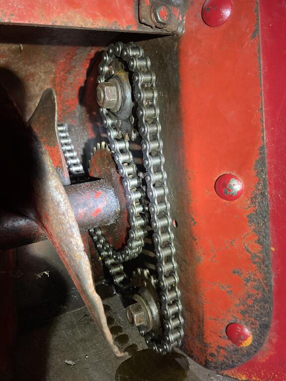

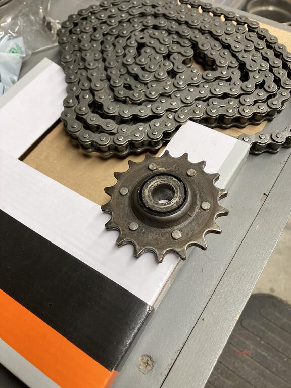

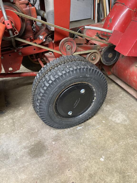

Blasterdad 3,167 #39 Posted December 24, 2022 35 minutes ago, JerryLook said: Also what are you guys using to install the new chain? Do you need like a big chain pin pusher? I have one that’s the size for bicycle chains, but not big enough for this chain. I notice the chains online that are sold for this model include a master link. The chain sold at TSC is just a 10’ piece. Maybe it has a master link also. I just replaced mine, 10' piece from TSC comes with master link in the box. It was #40, $25.00 I think mine was 100 links, count the links on the old chain, it will be stretched out so the same number of links on the new chain will be shorter. If it's still too long remove 1 link & try again until it in it's adjustability range. I just route the chain wih gloves on until both ends are at the front, pull together & slip the master link in. As stated check your idler sprockets, my top one was shot. You can also put your old chain on one of your front tires, should be the perfect length. New chain & sprocket. Old chain & bad sprocket on blower. New chain & sprocket on blower. Old chain on front wheel. 1 1 Share this post Link to post Share on other sites

JerryLook 84 #41 Posted December 24, 2022 Got the sprockets off and the seals out of one side. The bearings still feel decent, but definitely need grease. 3 Share this post Link to post Share on other sites
JerryLook 84 #42 Posted December 24, 2022 I went to TSC and picked up their last roll of #40 chain. Going to pull the old one off and count the links. 1 Share this post Link to post Share on other sites

JerryLook 84 #44 Posted December 24, 2022 I use either the Lucas red and tacky or the Lucas blue marine grease. Right now I have red and tacky in the grease gun. I got the new chain installed, and the greased sprockets reinstalled. I tested out the blower and it does sound quieter. I’ll probably replace the sprockets in the spring. One more question. How do you grease the bearings that hold the auger shaft? There are no zerks that I can see. And it looks like I’d have to take out the bearing plates to get to the bearings. 1 Share this post Link to post Share on other sites
JerryLook 84 #45 Posted December 24, 2022 Btw, the old chain was stretched, but maybe not as bad as I thought. It was about half a link longer than the new one. I was able to get the new chain tight enough and still be in the middle of the adjustment slot 1 Share this post Link to post Share on other sites
