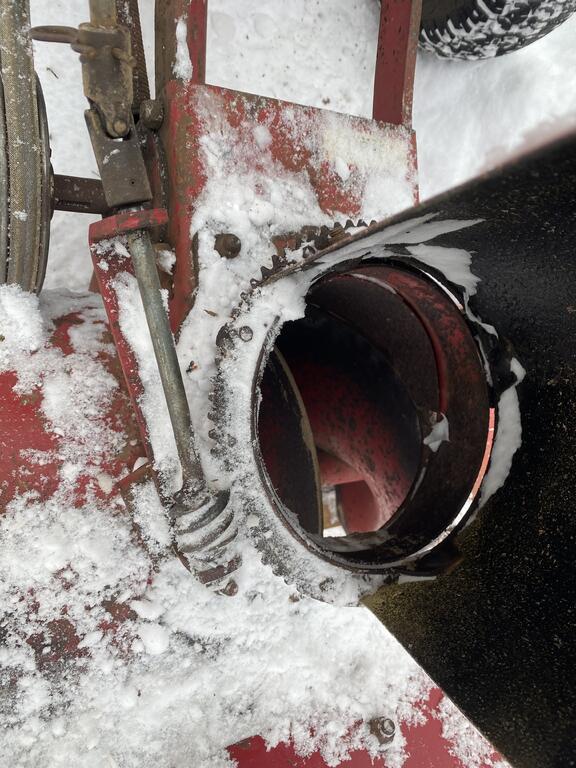

JerryLook 84 #1 Posted November 21, 2022 (edited) I have a Toro 0642ST07 snowblower on my 416H tractor. This is my first time using it this year. I noticed that when you turn the chute tiller (no idea what the actual name is for this thing. The handle that changes the chute direction) it will slip most of the time. It does turn it eventually. I was wondering if there is an adjustment I can make, or do I need a new ring gear etc? Thanks Edited November 21, 2022 by JerryLook 1 Share this post Link to post Share on other sites
doc724 925 #2 Posted November 21, 2022 the worm gear is not close enough to the ring gear. There has to be some adjustment somewhere. I never had this problem with any of my blowers. BTW, slather both with plenty of grease. 3 1 Share this post Link to post Share on other sites
JerryLook 84 #3 Posted November 22, 2022 Ok thanks. I’ll clean the snow off them and see if there’s a bracket I can adjust or something. Both sides seems to be in decent shape, and not worn etc. Btw, the snowblower is awesome. I do need to put some chains and wheel weights on my tractor as well, but it does a good job for now. I have the chains and weights in the shed, just waiting for me to have to time to put them on. 2 Share this post Link to post Share on other sites
wallfish 20,001 #4 Posted November 22, 2022 There's a nut directly under the worm gear holding it with a carriage bolt to the bracket. Loosen that and tap the worm gear towards the chute but don't wedge them tight as possible. When it's too tight it will bind the chute on the blower housing. 5 1 Share this post Link to post Share on other sites
JerryLook 84 #5 Posted November 22, 2022 Ok thanks. I just took a look at it and found the nut. I was able to move it around a little and it does work better. I think another issue I have is some excess friction in the chute base where it rotates. It probably needs to be taken apart and cleaned/lubed. I’ll have to check that out tomorrow and see how it comes apart. 1 Share this post Link to post Share on other sites

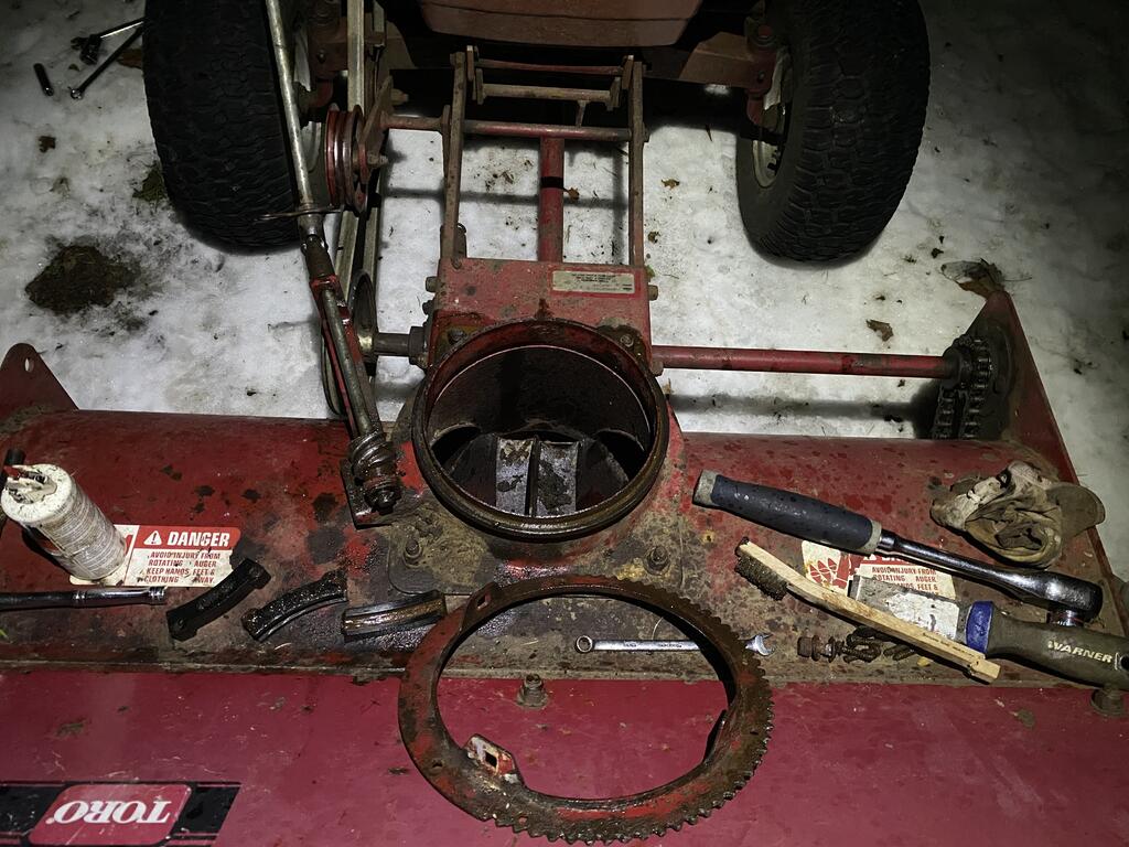

WHX?? 56,631 #9 Posted November 22, 2022 There are three plastic or nylon chute retainers around the chute. They are known to wear and break so check those. A guy here has replacements. Clean the ring gear of old grease & rust and grease good when reassembling. 2 Share this post Link to post Share on other sites

JerryLook 84 #12 Posted November 23, 2022 I took the chute base apart tonight and cleaned everything. Those 3 sliders mentioned above, and the ring they spin on. There was some rust and built up gunk in the area. I scraped/cleaned it well, and then used a good bit of grease and reassembled. It does work pretty good now. In regards to the snowblower height.... My driveway is not paved. There are some sections of uneven ground. I’ll look at the height adjusting feet, but it might not help in some spots of the driveway. I have to bump it up a 1/2” or so in some spots. Just to go over a hump etc. Thanks for the help guys. And have a happy Turkey day. 2 1 Share this post Link to post Share on other sites

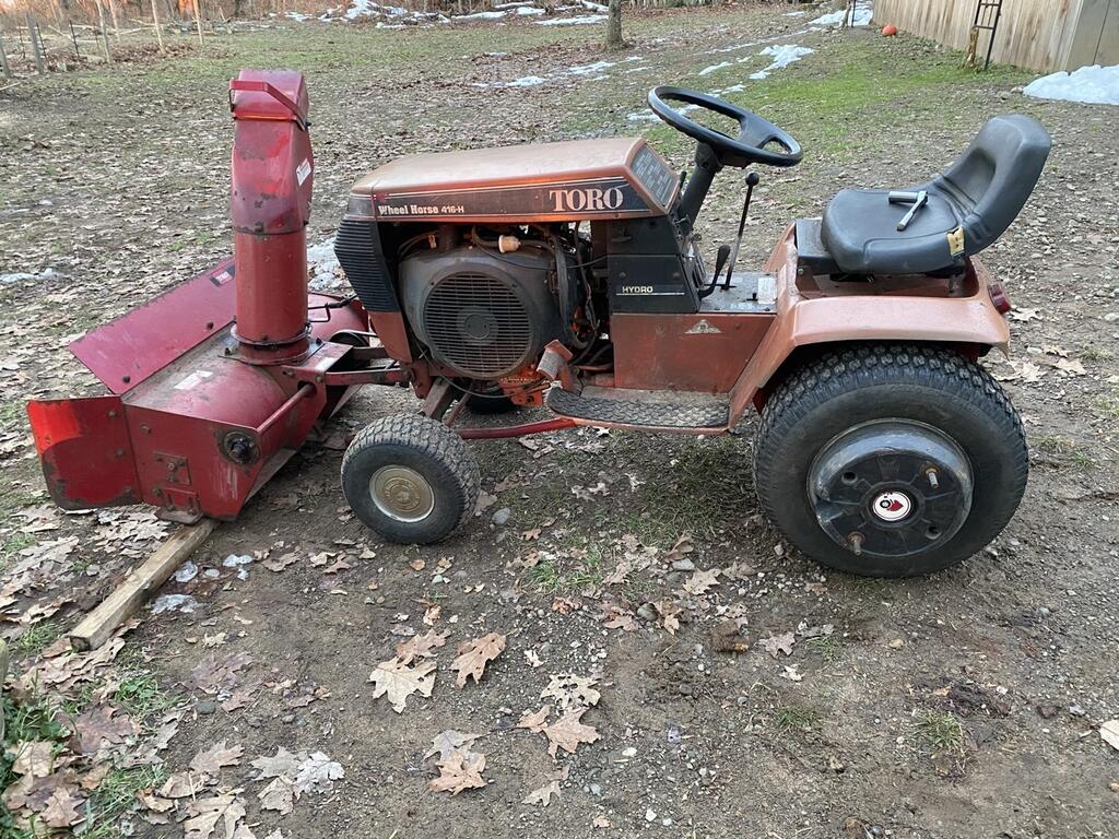

JerryLook 84 #16 Posted November 26, 2022 i got the wheel weights off my C-105 and onto the 416H today. The wheel weights were installed with the carriage bolts facing in. It looked nice, but the bolt heads just spun when I tried to remove them. I got 6 out, and had to drill/cut the other two out. When I reinstalled them on the 416H, I put the bolt coming from the wheel side. So the square of the bolt head sits in the square of the rim like it’s supposed to. I still need to trim the bolts a little. They stick out about 2”. Haha I’m only using two bolts per wheel right now. If it’s a problem at some point I’ll buy more carriage bolts and install 4 per wheel like where there originally. I’m going to see how it does with just the wheel weights, and add the tire chains if I need them. A side note. This is a hydro trans. I’ve noticed since the weather has gotten colder it takes the trans longer to warm up. Meaning it won’t lift the snowblower for about 1-2 minutes after starting. It sounds like the pump primes at that point. The tractor would drive immediately, but the lift doesn’t work for a couple minutes. Is this normal? The trans fluid and filter was changed this summer. 2 Share this post Link to post Share on other sites
