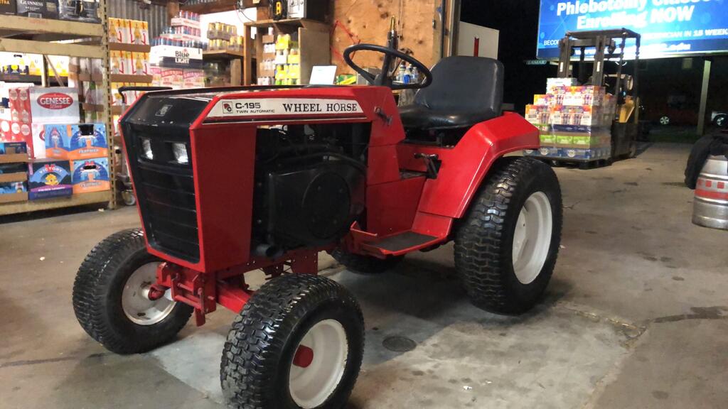

t_furl43 78 #1 Posted November 21, 2022 What is the largest size tire that will fit on my C-195 without any modification? Tia fellas 2 Share this post Link to post Share on other sites
Achto 31,467 #2 Posted November 21, 2022 Factory size is a 27x9.50x15 (27" outside diameter x 9.5" wide x 15" rim) You can always go wider but it does not look like there is much room to go taller. A wider tire on a narrow rim will also cause the side walls to compress some making the tire slightly taller. 1 Share this post Link to post Share on other sites
Thor27 856 #3 Posted November 22, 2022 @Skipper would be the man to ask... He's got 31-15.50x15s on his. 1 1 1 Share this post Link to post Share on other sites
8ntruck 8,728 #4 Posted November 22, 2022 Near as I can tell, the 27x9.5x15 is no longer made - at least, I have not found any listed. I'm thinking about something in the 30x10x15 for mine. 1 Share this post Link to post Share on other sites
t_furl43 78 #5 Posted November 22, 2022 17 hours ago, 8ntruck said: Near as I can tell, the 27x9.5x15 is no longer made - at least, I have not found any listed. I'm thinking about something in the 30x10x15 for mine. My thing is all the tires on it are all original theyre the ones that came on it in 1982, and I love using my 195 so I would like to keep those tires for as long as I can so while I’m still using my 185 I’d like to dismount those tires and keep them in storage until the day comes that I retire it so I’m just looking at different options for different sizes and different tread, I really like the tread of R4 tires 1 Share this post Link to post Share on other sites
t_furl43 78 #6 Posted November 22, 2022 18 hours ago, Thor27 said: @Skipper would be the man to ask... He's got 31-15.50x15s on his. Thank you that thread was absolutely amazing and very informative and pretty much told me exactly what I need to know 3 Share this post Link to post Share on other sites
