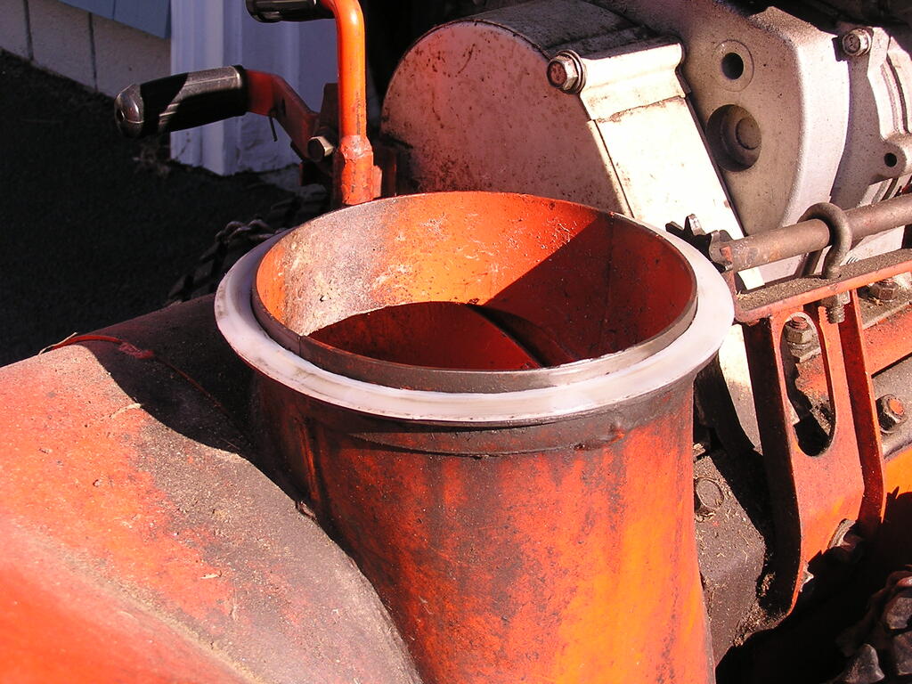

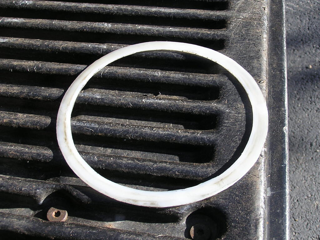

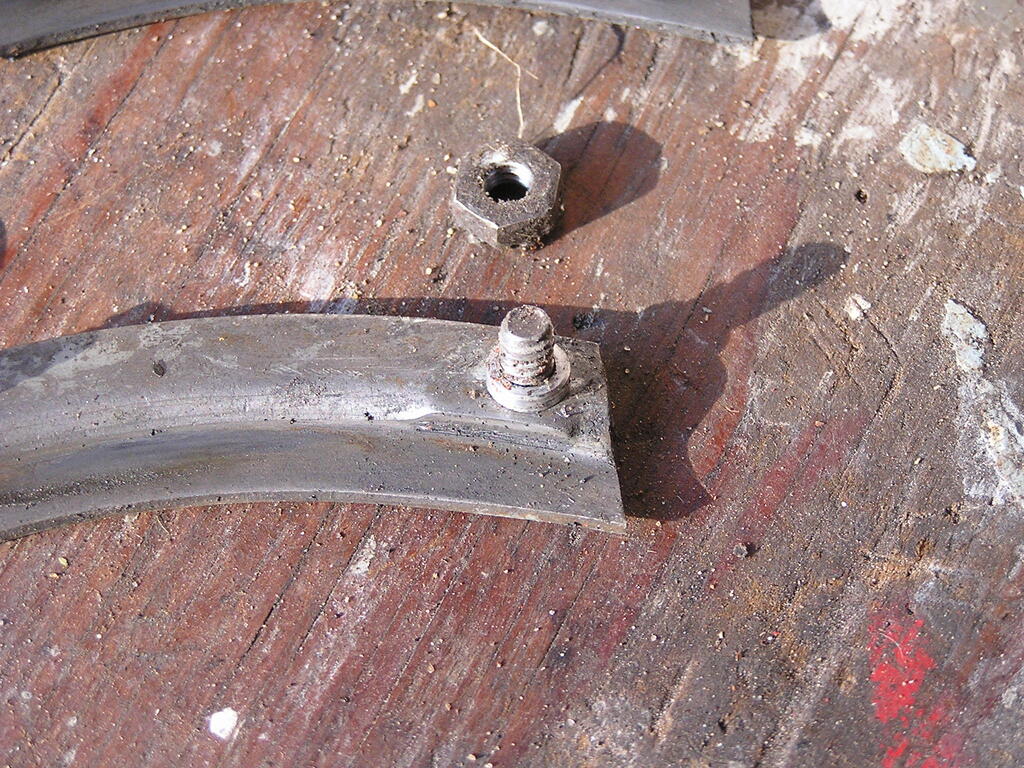

ri702bill 11,408 #5 Posted November 20, 2022 Pictures, as requested. The plastic ring, the ring installed, and one of the three chute retainers with the small spacers installed. 1 1 Share this post Link to post Share on other sites
ri702bill 11,408 #6 Posted November 20, 2022 The plastic sheet material does not cut well with a coping saw, but can be cut without distorting of fracturing it with a pair of good sharp tin snips. I used a 1-1/2" holesaw inboard in the middle to allow the snips to get to a good working angle - cut the ID first, then the OD. Had a short length of 3/8 diameter aluminum on the stock rack to make the spacers... I also had to adjust the drive gear bracket seen in the 2nd picture up a tad to better engage the chute ring. Bill Share this post Link to post Share on other sites
