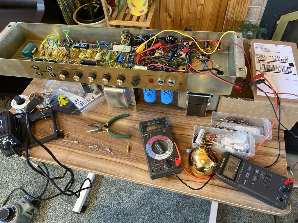

Reddart 213 #13 Posted November 18, 2022 1 hour ago, 953 nut said: Glad to hear you have already taken care of your grounds, too many people seem to think they are unimportant. If the problem goes away with a hot wire it is probably not a ground since that would crop up with a hot wire too. Oh yeah, grounds are very important. I have learned that from my other hobbies: 1 Share this post Link to post Share on other sites
