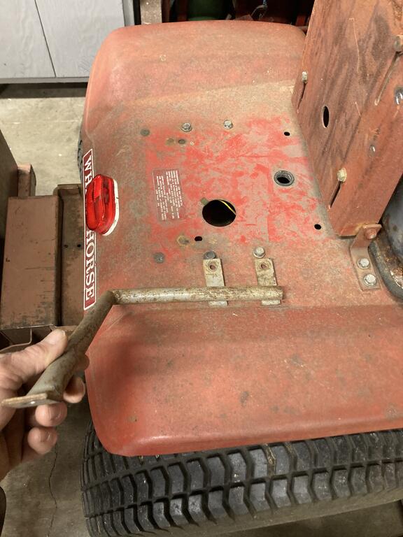

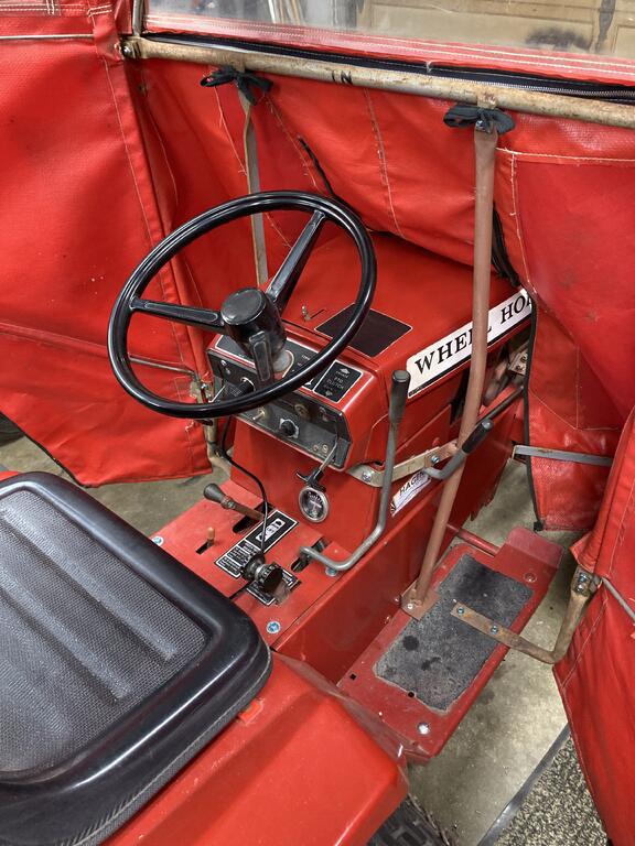

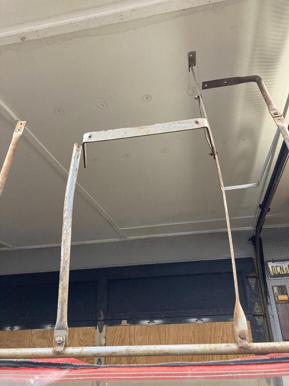

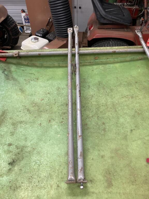

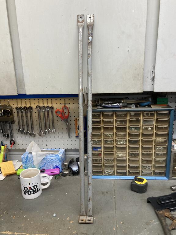

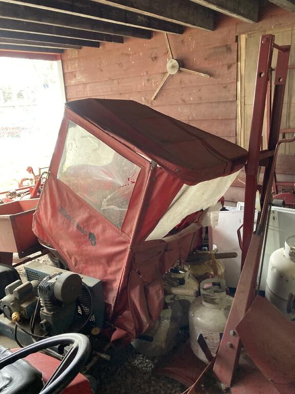

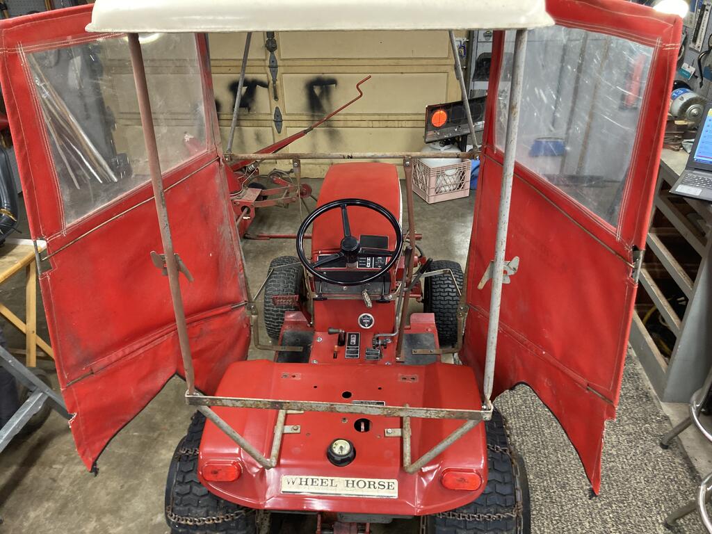

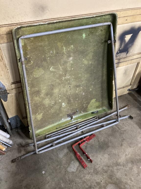

Blasterdad 3,167 #1 Posted November 13, 2022 Over this summer I managed to acquire 3 snow cabs in various states of condition / completeness / & PO "modifications". Between the 3 I can make a fairly nice one with only a couple of parts I have to fix. The cab I will be using only had one rear upright / door latch support, parts donor is about an inch longer because of different model #, easy enough to shorten... I love the back mounts on this model, no drilling, bolts on under seat pan. Next is the right fornt crossbar support, PO had cut it for whatever reason, once again, easy enough to make a new one... I'll be using the windshild & lower front panels from the donor cab. PO had taken lower front panel to an upholstry shop where they removed the lift arm bump out & chute rod zipper which is perfect because the snow beast has hydro lift & electric chute control. The doors from the cab I'm using have some mouse nibbles on the bottom, but in otherwise good condition & the Wheel Horse printing is in great shape. The doors from the donor are in great shape but the Wheel Horse logo was dyed over, PO had put it on a little IH. Gotta go with mouse nibbles, gotta "represent" ya know ! Odd man out is an older model soft top cab, windows are shot, but otherwise pretty much complete & in fairly good condition. I'll have quite a few leftover parts & "odd man out" available when I'm done if anyone is interested, just PM me 5 4 Share this post Link to post Share on other sites

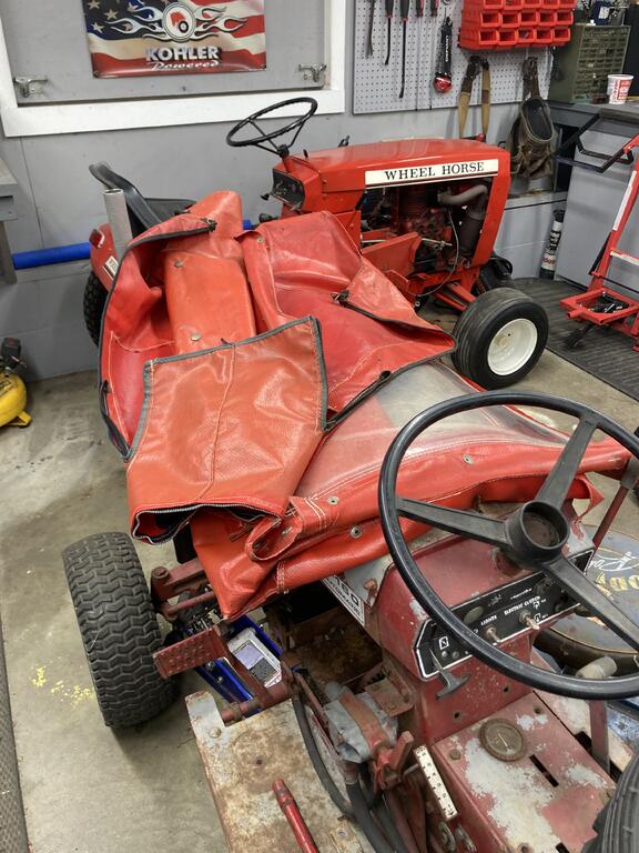

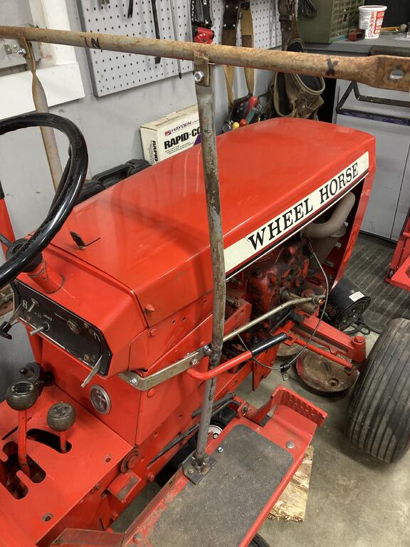

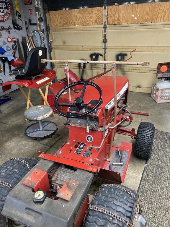

Blasterdad 3,167 #2 Posted November 18, 2022 Shortened the door latch leg & made the missing piece of the front inner mount today. Test fit the on the C-81 in the shop, it'll be going on the C-161 after some paint tomorrow. 1 4 Share this post Link to post Share on other sites

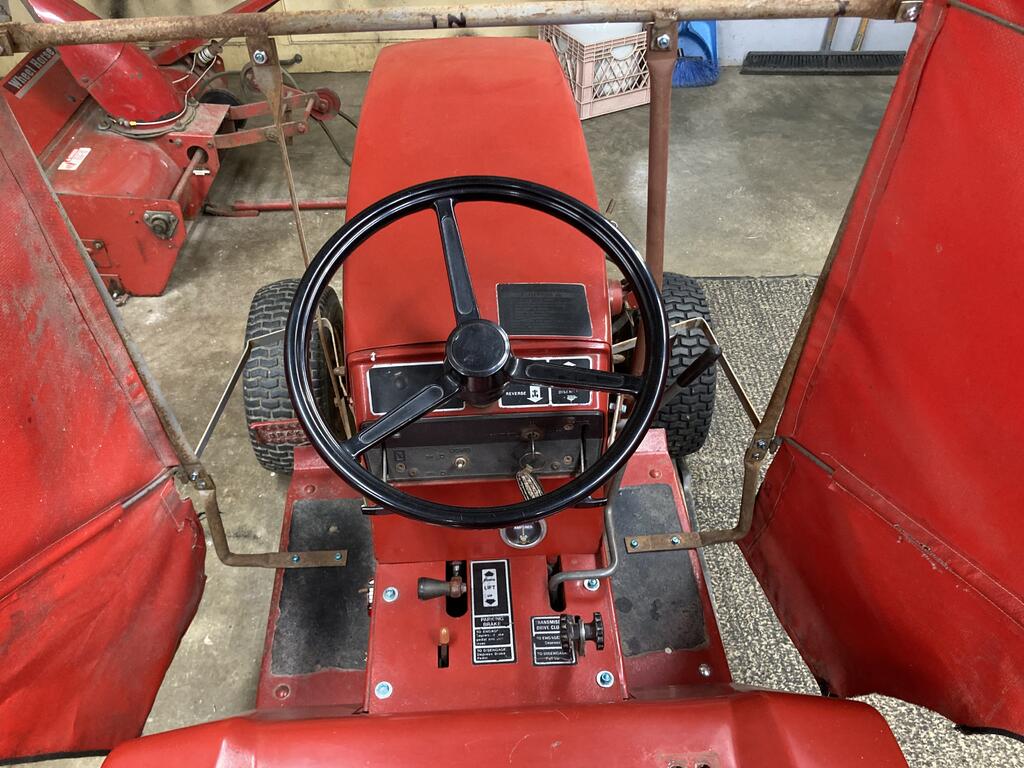

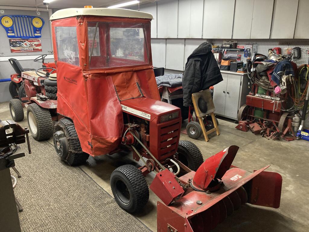

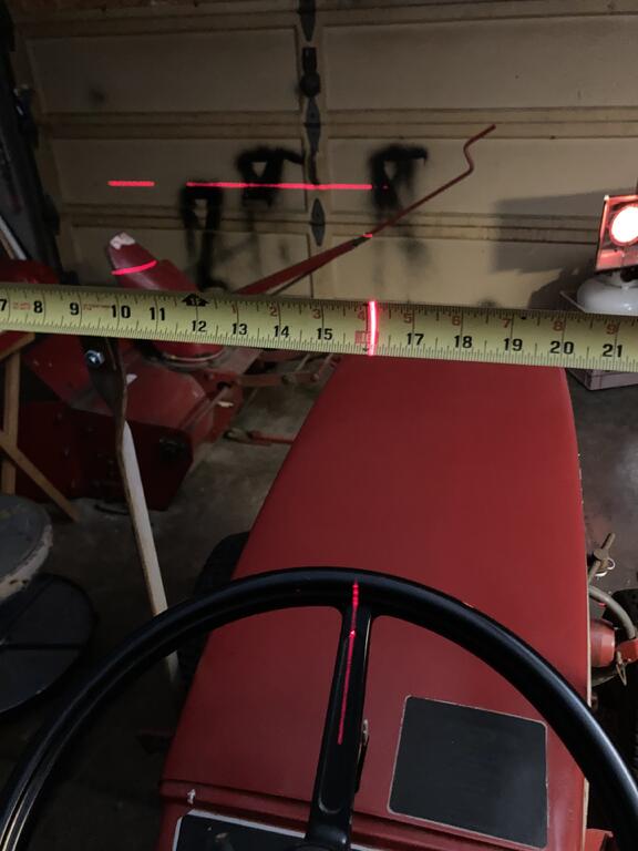

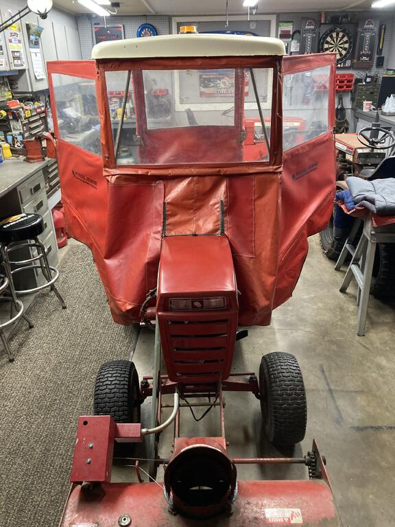

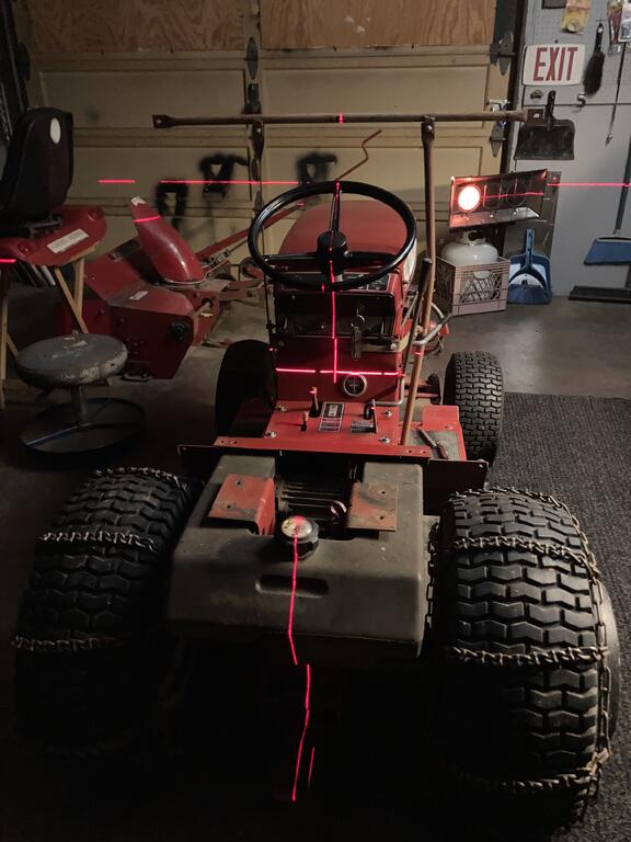

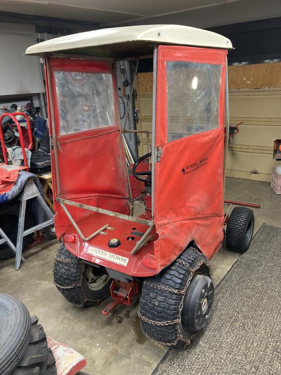

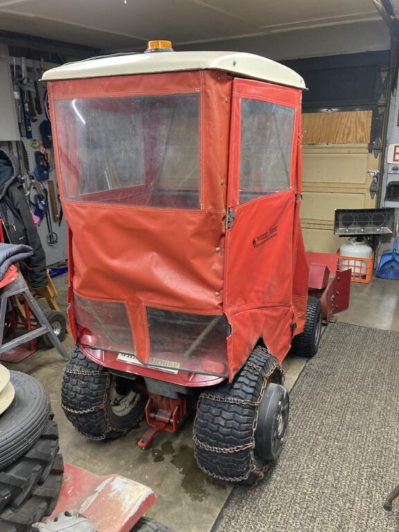

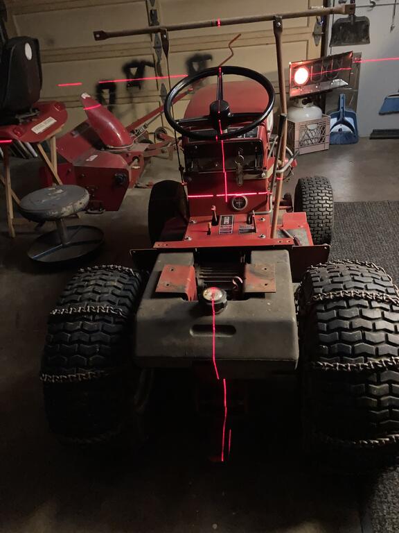

Blasterdad 3,167 #4 Posted November 28, 2022 Started to put the snow cab together tonight. I got the front inside windshield mounts bolted on & centered with my laser. Beam is through the center of the gas cap, up the center of the steering shaft, & through the center of the wheel to the center of the cross bar. The cross bar is 32 & 1/4" so 16 & 1/8" is the target. I love my playing with my laser, both diagnal measurements from underside of hood to the center of the outside mounting holes a perfect 17". From foot rests to the bottom of both sides 1/8" different, oh well, can't win 'em all... Have to leave a little play in my OCD. 2 2 Share this post Link to post Share on other sites

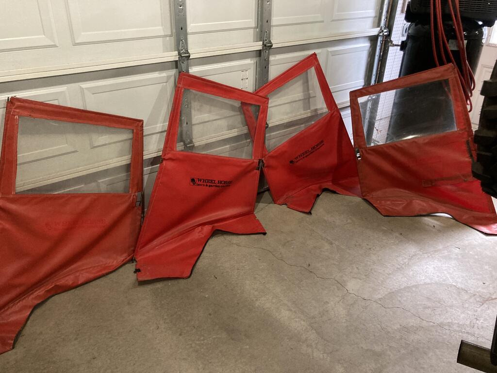

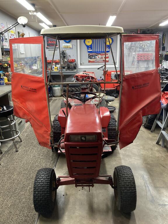

Blasterdad 3,167 #5 Posted December 1, 2022 Made some more progress tonight. Assembled the rest of the frame, lined up the doors & mounted the front outside frame posts to the foot rests. Now I can take the doors back off & clean them & the rest of the vinyl. While the vinyl is off it's time for wiring, fabricating a control panel for the electric chute control, caution strobe, led's & rock lights. 7 2 Share this post Link to post Share on other sites

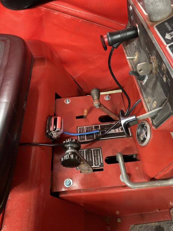

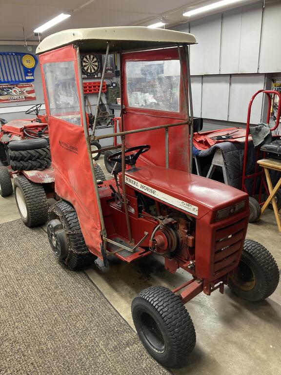

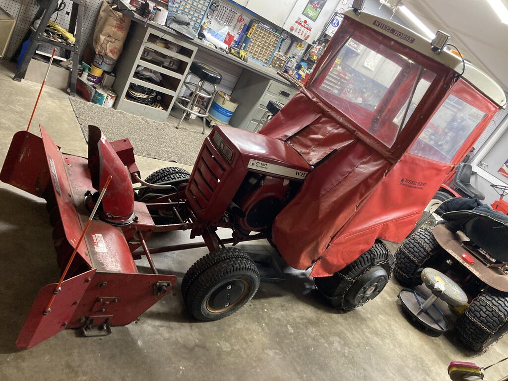

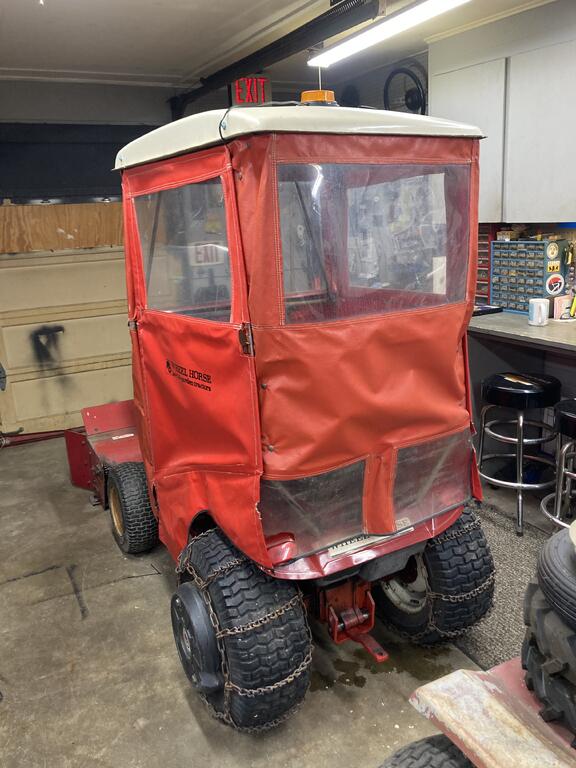

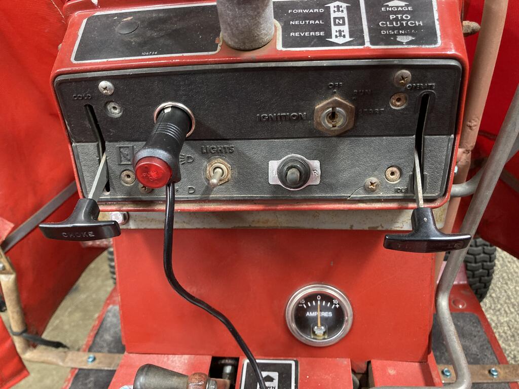

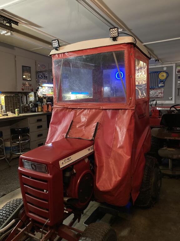

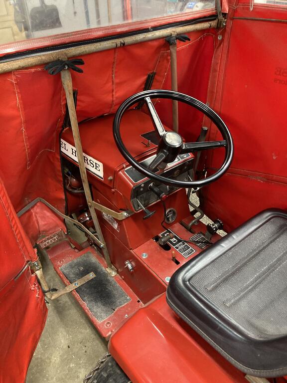

Blasterdad 3,167 #6 Posted December 5, 2022 Finished the cab today, I decided to go simple ( stock looking ) with the wiring instead of a control panel. LED's hooked up to factory light switch, ( brand new in the box harness was broken, returning them ). Put a cigarette lighter in the factory hole for the beacon & used the factory electric clutch hole for the chute control, nice & neat. Still have to put on the front wheel weights & chains & wait for the snow, hopefully it will be a while... 3 5 Share this post Link to post Share on other sites

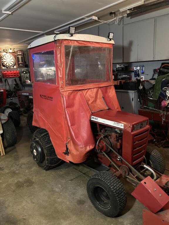

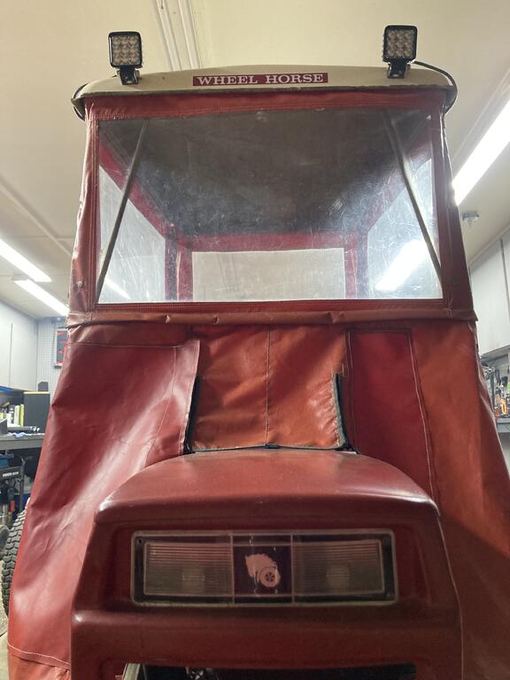

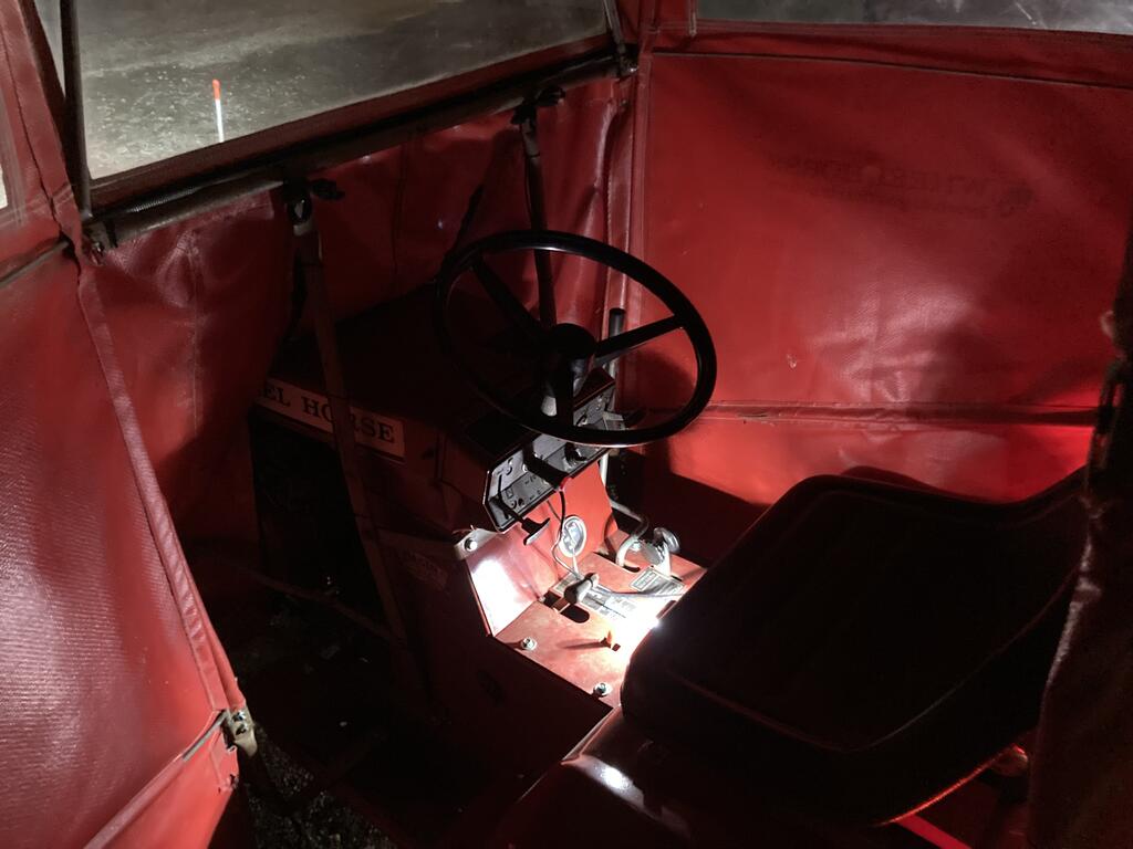

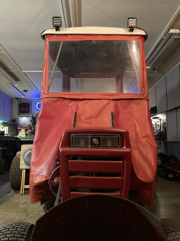

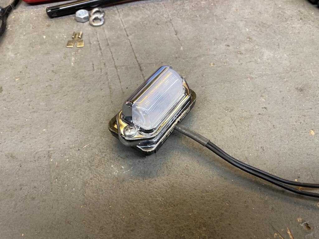

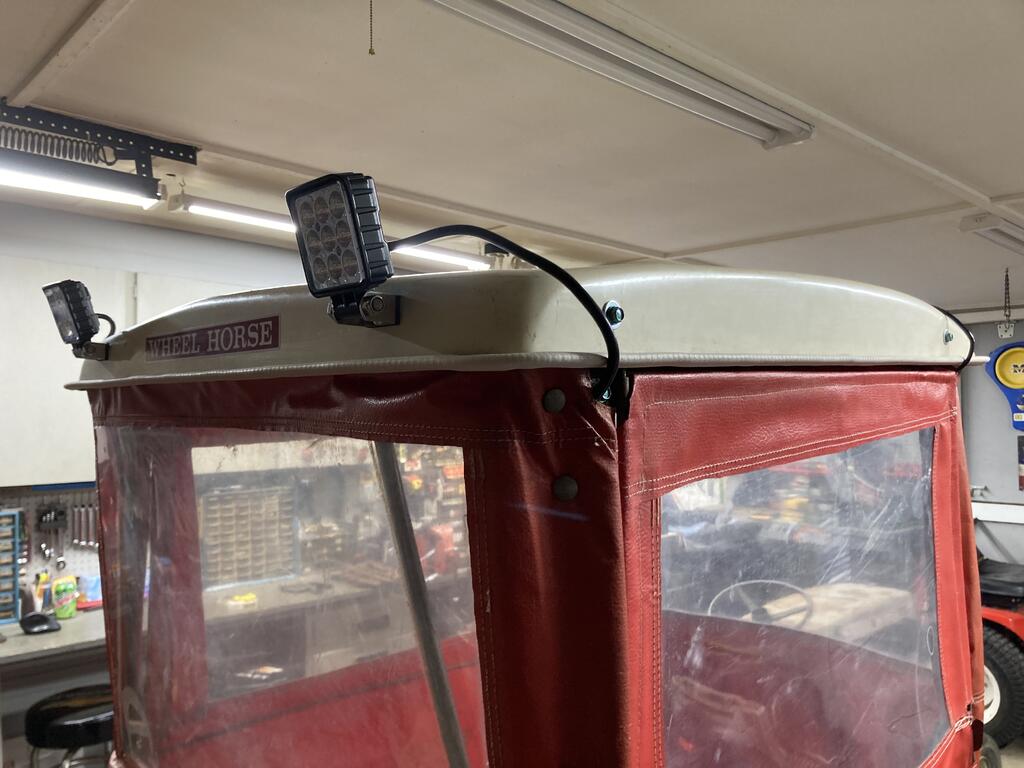

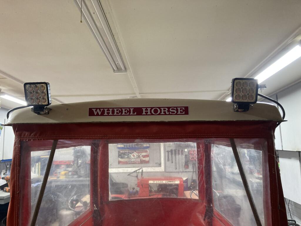

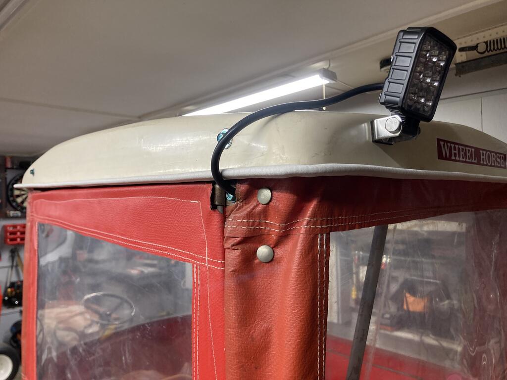

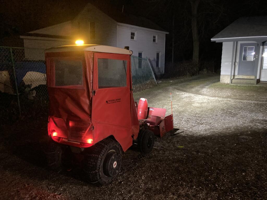

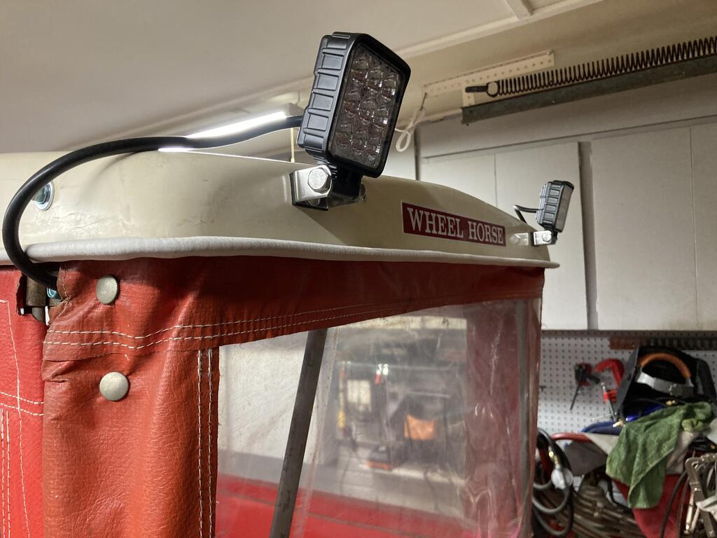

Blasterdad 3,167 #11 Posted December 10, 2022 Got the cab lights & dash light mounted & wired yesterday. I drove it outside to see if just the stock headlights with led bulbs in them would be enough & couldn't see S*** inside or out. The led's I finally picked out definitely solved that problem & to me don't look overly big or stupid & will look even better when when I get the WHEEL HORSE sticker I ordered from Terry to go in between them. Since I really don't like drilling holes in my 's I mounted a led license plate light to an old Hide-A-Key box I had laying around for the dash light. The amount of light inside the cab is just right, without causing a reflection on the windows. 3 2 Share this post Link to post Share on other sites

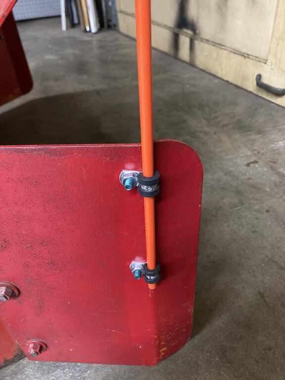

Blasterdad 3,167 #12 Posted December 10, 2022 Tonight's progress, made a pair of markers out of Home Cheapo driveway markers. Mounted them with 1/4" wire clamps. 4 2 Share this post Link to post Share on other sites

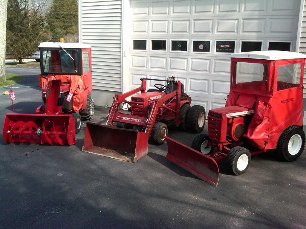

c-series don 12,382 #13 Posted December 10, 2022 (edited) I just started following this thread, and found out that you and I think a lot alike! Great job I must say, and on one of my favorite tractors. Once you blow snow with a warm cab and lights at night you’ll never want to be without a cab. To me the C-161 Automatic is one of the best tractors Wheel Horse ever made. I have most of the ‘78-‘79 C-series. Here’s an older picture of my snow fleet. I put the plow on my C-160 Auto when I got a Sweepster C-48 broom for the C-141 which works great in light, dry snow. Since this picture was taken I’ve added LED lights to the snowblower tractor (417-A) and use it in the dark just because I can 😜 Edited December 10, 2022 by c-series don 1 2 1 Share this post Link to post Share on other sites
Blasterdad 3,167 #14 Posted December 10, 2022 1 hour ago, c-series don said: you and I think a lot alike! 1 hour ago, c-series don said: To me the C-161 Automatic is one of the best tractors Wheel Horse ever made. Agreed! My first was a '78 C-81 Eight speed my Grandfather bought new in '79, ( Which I still have ). I grew up always wanting a C-161 Automatic & finally picked this girl up from @jay bee about 10 years ago. Payed my dues many a frozen winter with the blower on the C-81 & manual lift. & yes, '78-'79 C's are my favorites. Your collection is AWESOME btw.... 3 1 Share this post Link to post Share on other sites

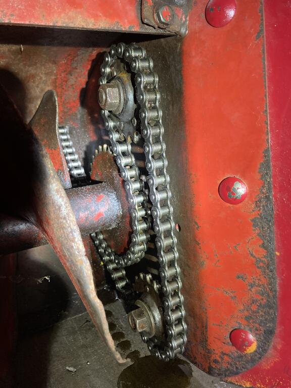

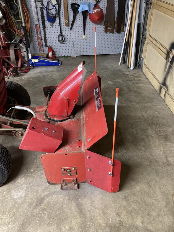

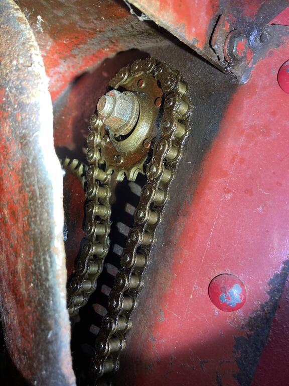

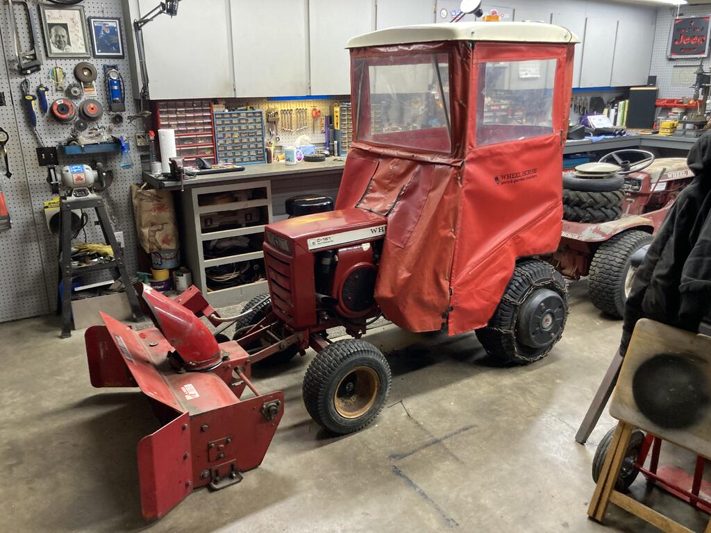

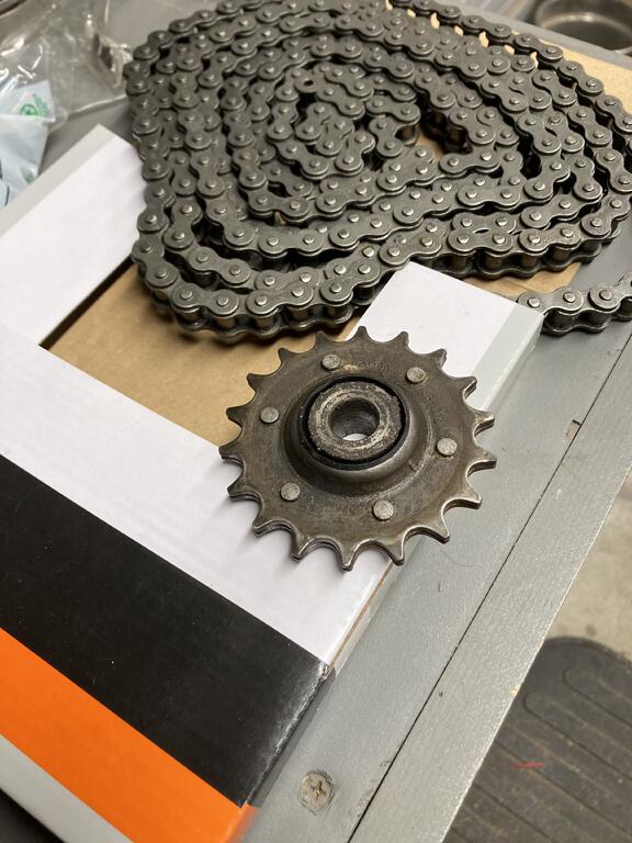

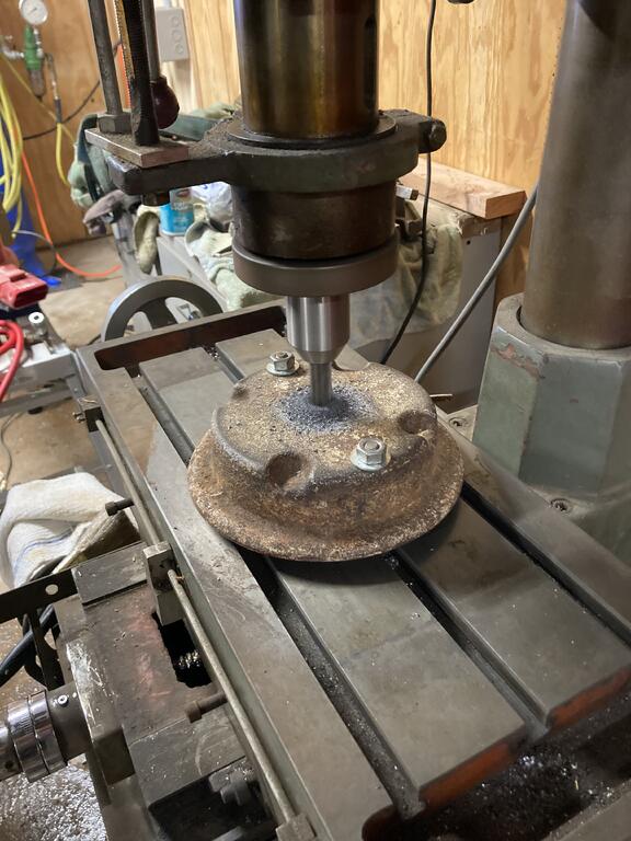

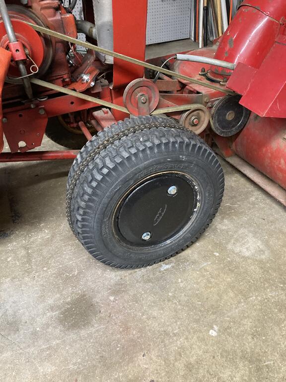

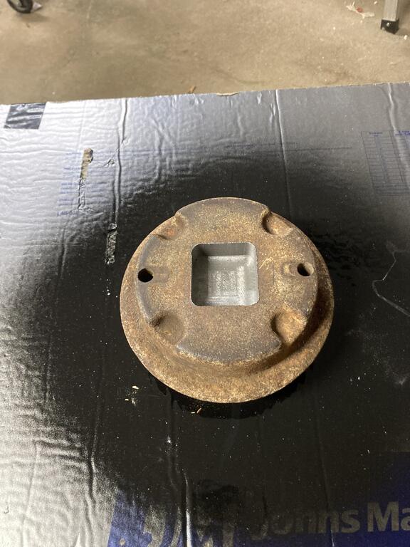

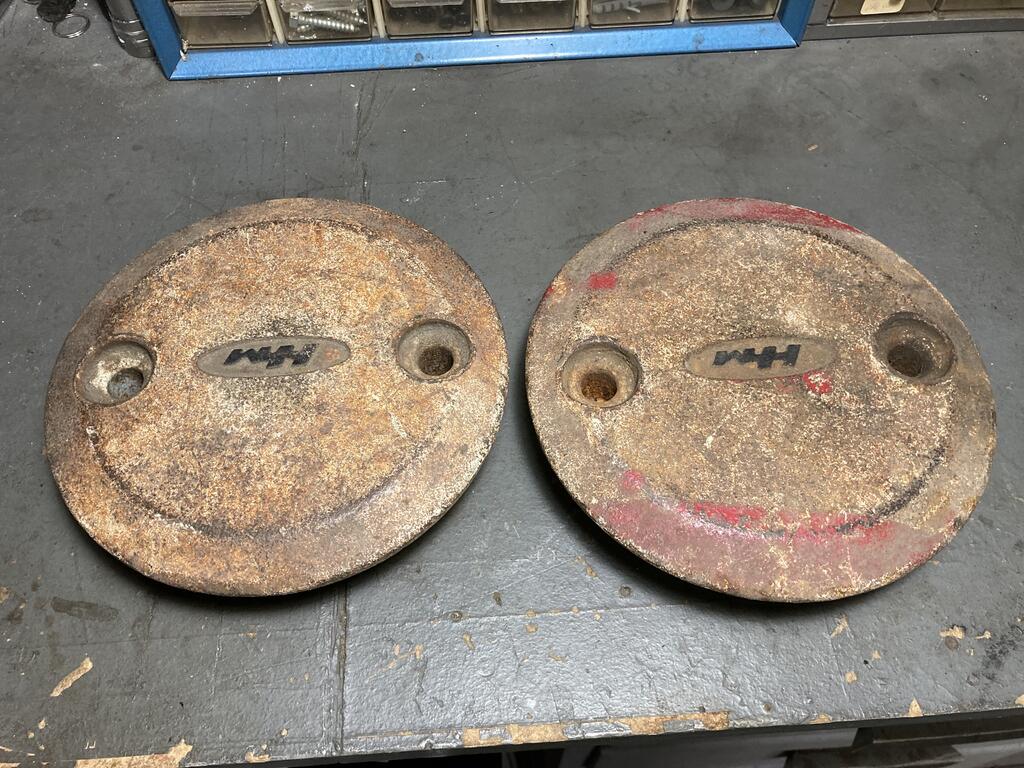

Blasterdad 3,167 #15 Posted December 12, 2022 I picked up a pair of cast iron front wheel weights this summer but they were too deep & hit the end of the axle & hub. A little time on a friends milling machine & good to go. ( notice upside down they say WH, lol ). Went to Tractor Supply & bought 10' of #40 roller chain & new bolts. I had parted out a snowblower a few years back & thought I'll use the chain from that for the right tire, put a new chain on my blower & put the old chain on the other tire, that way I end up with another new spare chain. The plan is going great, the parts chain was the perfect size. Put it & the weight on... Started to take the chain off the blower & noticed this right away...Top idler sprocket bearing is shot, so far the plan is working to my advantage, probably wouldn't have noticed otherwise. Spare parts to the rescue... The paint is still drying on the other weight anyway so I'll change out the sprocket & chain tomorrow. Accordind to USPS tracking my sticker for the cab should be here tomorrow too, & hopefully I'll be finished. 4 2 Share this post Link to post Share on other sites

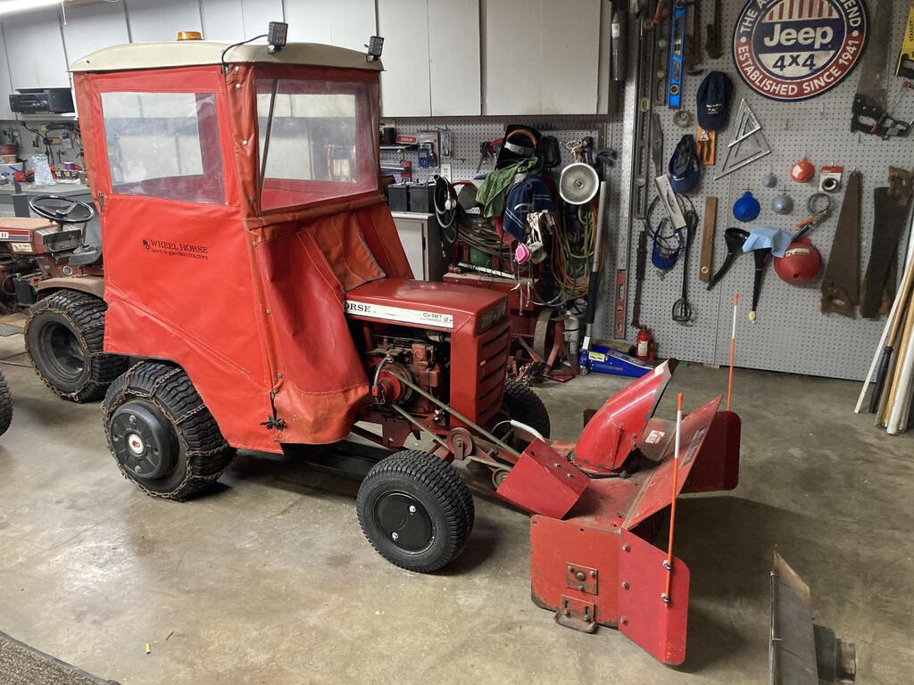

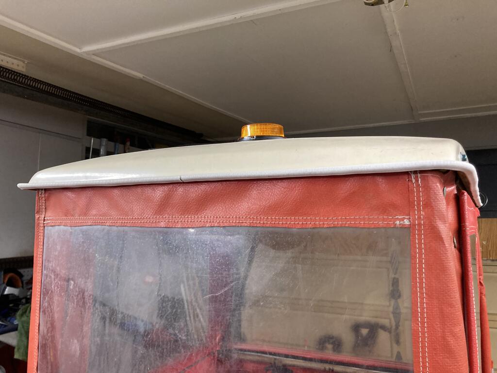

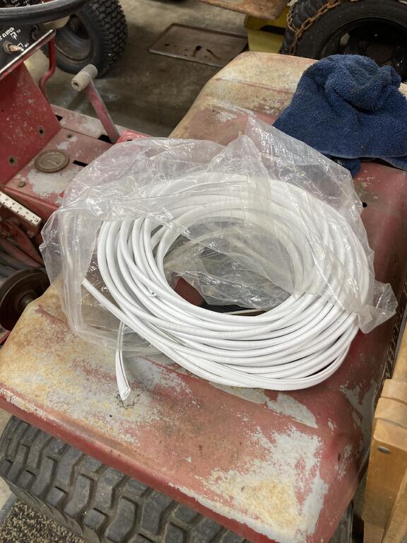

Blasterdad 3,167 #16 Posted December 13, 2022 She's done for now, I will take the cab off in the spring & paint the frame. Until then, let it snow. Idler sprocket & new chain on... Left side weight & & chain on... & for the final touch I got my sticker in the mail today... Oops, forgot about this, leftover vinyl edging from the carport to go around the fiberglass edge. Oh well, tomorrow night... 3 2 Share this post Link to post Share on other sites

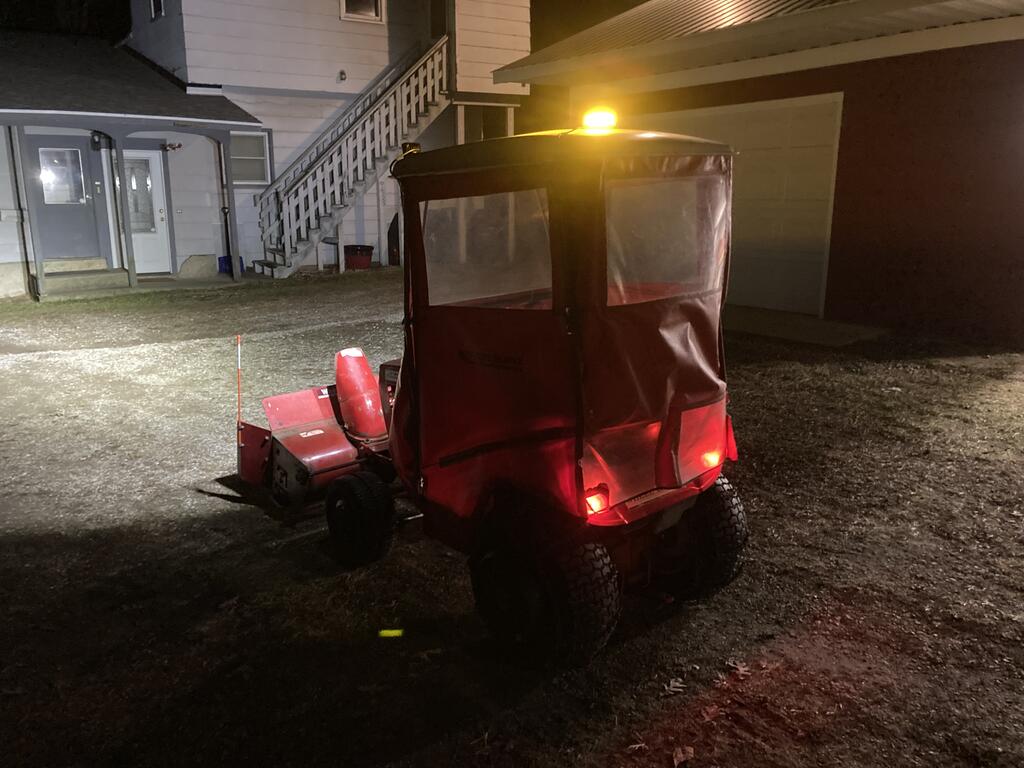

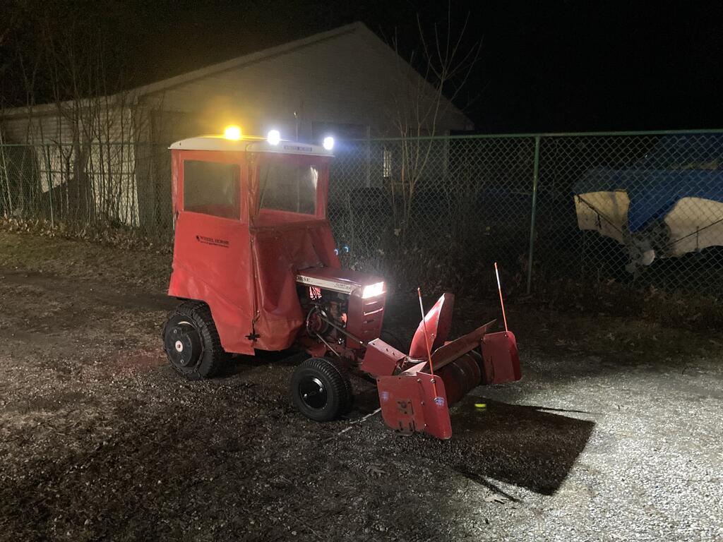

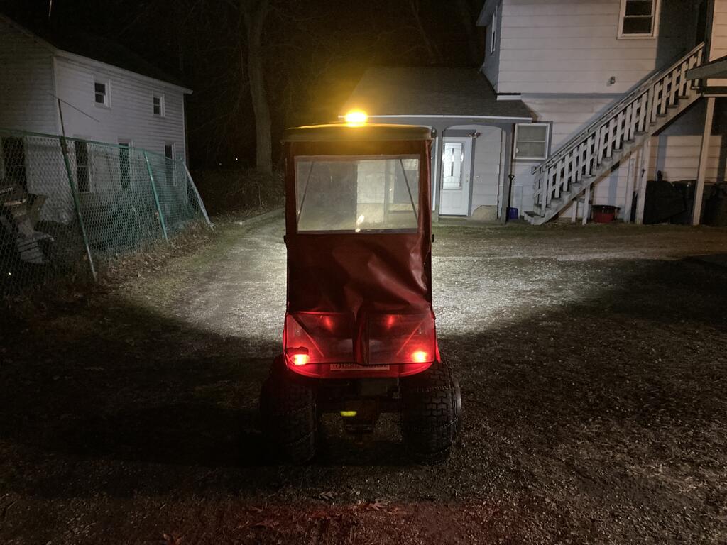

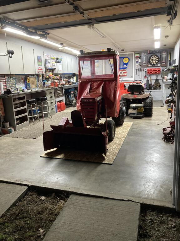

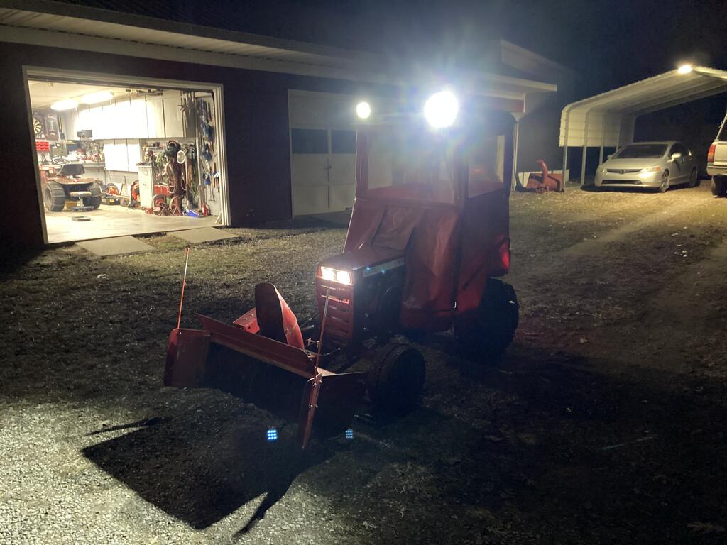

Blasterdad 3,167 #18 Posted December 14, 2022 Got home from work tonight & put the trim on the cab, looks much better, that raw edge was working my OCD. Waited till dark & pulled her out to try out / aim the lights, no aiming necessary, spot on, (pun intended), all I can say is WOW !!! 2 5 Share this post Link to post Share on other sites

peter lena 10,030 #22 Posted December 20, 2022 @Blasterdad nice job on that ! knocking off all the details , suggest some kind of hood to cab fit anti / scratch protection . that blower sprocket , / chain specific chain / open gear lubricant , would also touch up related sprockets , I typically re grease those , with red grease or green grease . lighting looks killer , 303 vinyl boat spray , for vinyl refresh . scary , we are on the same thought page , what is going on ? stay on it , pete 1 Share this post Link to post Share on other sites
