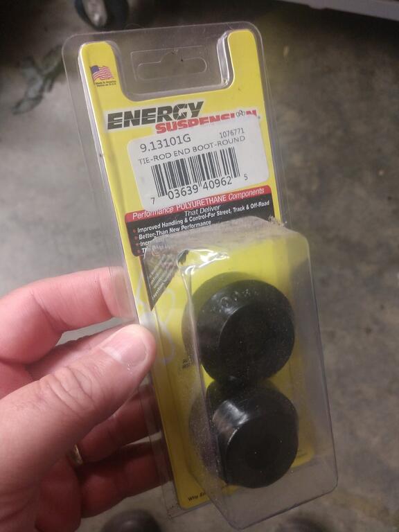

kpinnc 18,940 #3 Posted November 9, 2022 6 hours ago, RITEK said: tie rod ends I've never seen the 520 tie rods worn out- they are beefy. BUT you may need new boots for them. I've been using the ones below and they hold up well. 1 Share this post Link to post Share on other sites
