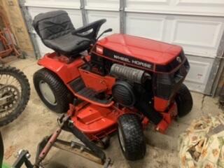

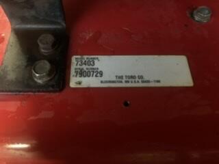

case442 132 #1 Posted November 8, 2022 Hello All, would anyone be able to give an axle seal part number and availability. Toro 314 with hydro 1 Share this post Link to post Share on other sites

gwest_ca-(File Mod) 12,489 #3 Posted November 8, 2022 Here is the ipl. Once you have the Toro number go to the top of our Transmission section to some pined topics on alternative seals. Napa and SKF are popular sources. Item #12 on this page https://www.partstree.com/models/73403-314-h-toro-garden-tractor-sn-079000001-079999999-1997/hydrostatic-transmission-27/ Toro # 6449 Napa & SKF/CR # 11124 - The original seal is wider. 1 Share this post Link to post Share on other sites
953 nut 69,475 #4 Posted November 8, 2022 https://www.ebay.com/itm/142042768245 Replacement TORO Wheelhorse Axle Seals Replaces 6449 (Set of 2 These seals are for Hydros with 1 1/8" axles. I have used them and the are a great fit. Share this post Link to post Share on other sites
JoeM 10,294 #5 Posted November 8, 2022 My best luck has been with the SKF seals. Stay away from old stock stuff. I have got some bargains and the seals failed after a running a while. Just think they were old and not pliable. The metal housing on SKF seals are half the thickness of the OEM seal, and this allows the seal to be installed into the housing deeper and lets the seal run on a better part of the shaft. Plus if no thrust washer is used the seal will not be rubbed by the hub cause the axle floats a but in and out. Share this post Link to post Share on other sites
case442 132 #6 Posted November 8, 2022 Thank you very much everyone. I will order them up. you are the best, Mike Share this post Link to post Share on other sites
