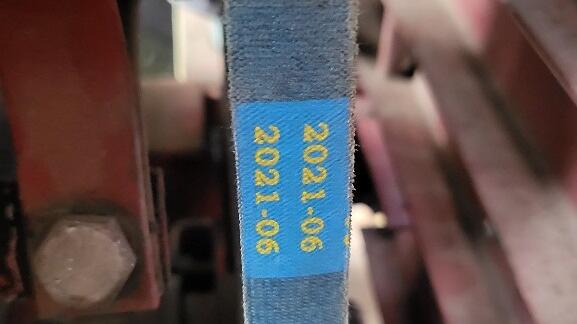

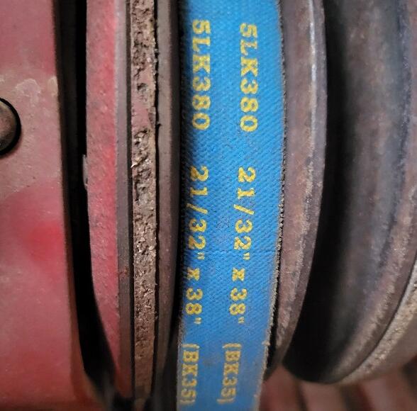

tractorhogg 667 #1 Posted November 8, 2022 (edited) I thought this was a OEM belt, not sure now, the belt seems to slip some. It could be rusty pulleys, its doing a little better since I adjusted the clutch rod Edited November 8, 2022 by tractorhogg Share this post Link to post Share on other sites
Blasterdad 3,168 #2 Posted November 8, 2022 What model tiller / tractor is it for? The belt number & length will be listed in the Manuals section... https://www.wheelhorseforum.com/files/category/20-ground-engaging/ Share this post Link to post Share on other sites
tractorhogg 667 #3 Posted November 8, 2022 (edited) 35 minutes ago, Blasterdad said: What model tiller / tractor is it for? The belt number & length will be listed in the Manuals section... https://www.wheelhorseforum.com/files/category/20-ground-engaging/ Its for a D160 Kohler K341. I thought I ordered this from using the IPL manual I have. I'll check again. This is the belt I ordered. https://www.ebay.com/itm/172131463261 Edited November 8, 2022 by tractorhogg Share this post Link to post Share on other sites
tractorhogg 667 #4 Posted November 8, 2022 51 minutes ago, Blasterdad said: What model tiller / tractor is it for? The belt number & length will be listed in the Manuals section... https://www.wheelhorseforum.com/files/category/20-ground-engaging/ So here's the deal, the OEM belt was 37.5" x 5/8", but you cant buy a belt in half increments, that I know of, so the service manual shows you can loosen the middle rear PTO pillow block shaft bearing, then you can adjust the front bearing to add or remove belt slack. Note: you always have to loosen the mid PTO shaft bearing or else it will put the shaft in a bind Share this post Link to post Share on other sites
Blasterdad 3,168 #5 Posted November 8, 2022 Sounds like you're getting it figured out... I've ran into fractional sizes before too, one of my drive belts calls for an 84.22" belt. Unless you're lucky enough to find a NOS belt with the original part #, ( and be willing to take out a second mortgage on your house to buy it ) they will all be in even number increments. Share this post Link to post Share on other sites
