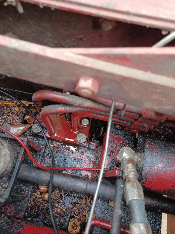

gmushnick 0 #1 Posted November 6, 2022 (edited) Need to know where I can purchase the o-rings and sealer washer for my 1975 d200. Just purchased it, 5 minutes into my first use, it pumped all the oil onto the ground. Hoping one of the tubes isn't cracked. If anyone can tell me of a reputable place for parts, I'd appreciate it. Thanks Edited November 6, 2022 by gmushnick Share this post Link to post Share on other sites

gmushnick 0 #3 Posted November 6, 2022 (edited) Thanks for the response. I don't believe it's been apart. The tractor has a loader and while trying to scoop some dirt, I hit a buried stump. I'm thinking one of the tubes may need to be rebraized. But while I have it out, I'm gonna change all the o-rings Edited November 6, 2022 by gmushnick Share this post Link to post Share on other sites

gmushnick 0 #5 Posted November 6, 2022 Trans.fluid, it came out of the flat plate with the 4 lines going in. After it stopped moving, I took the seat off and started it real quick, and could see bubbles and hear air from around a tube. And all the fluid was running down from that area Share this post Link to post Share on other sites
gmushnick 0 #6 Posted November 6, 2022 Just went out and started it and oil came out of the big tube towards the front, leading me to believe that it's gonna need a rebraize. Share this post Link to post Share on other sites

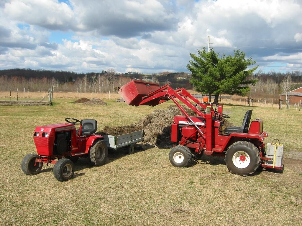

JoeM 9,323 #7 Posted November 6, 2022 I had a loader on my D160 and could not keep that plate sealed. I think it was the frame twisting slightly when using it with loads. I was on the verge of flaring and putting JIC nuts on the tubes and making it tube to hose. Ended up putting the loader on a 520H and it performed just as good if not better. Steered way better with the reduction steering on the 520 The high pressure tubes have o-rings and backer rings and only go in one way. 1 Share this post Link to post Share on other sites

pfrederi 19,278 #10 Posted November 6, 2022 (edited) A to Z tractor in the vendor section may have a manifold... https://www.a-ztractor.com/ I have a loader on my D200 no issues with leakage Edited November 6, 2022 by pfrederi 1 Share this post Link to post Share on other sites

JoeM 9,323 #13 Posted November 6, 2022 Kind of went back and looked at my old loader pics. I had the weight box mounted to the three point. This may have been my flex issue?? I know I ran it a couple years no issues. Even changed out the tubes, and the problem was still there, not a leak but a seep. When I do a loader subframe now, I extend it out from under the rear axle and put the rear weights on the the subframe. 1 Share this post Link to post Share on other sites
pfrederi 19,278 #14 Posted November 6, 2022 37 minutes ago, JoeM said: Kind of went back and looked at my old loader pics. I had the weight box mounted to the three point. This may have been my flex issue?? I know I ran it a couple years no issues. Even changed out the tubes, and the problem was still there, not a leak but a seep. When I do a loader subframe now, I extend it out from under the rear axle and put the rear weights on the the subframe. May be... My subframe runs the length of the tractor and holds the counter weight 1 1 Share this post Link to post Share on other sites
