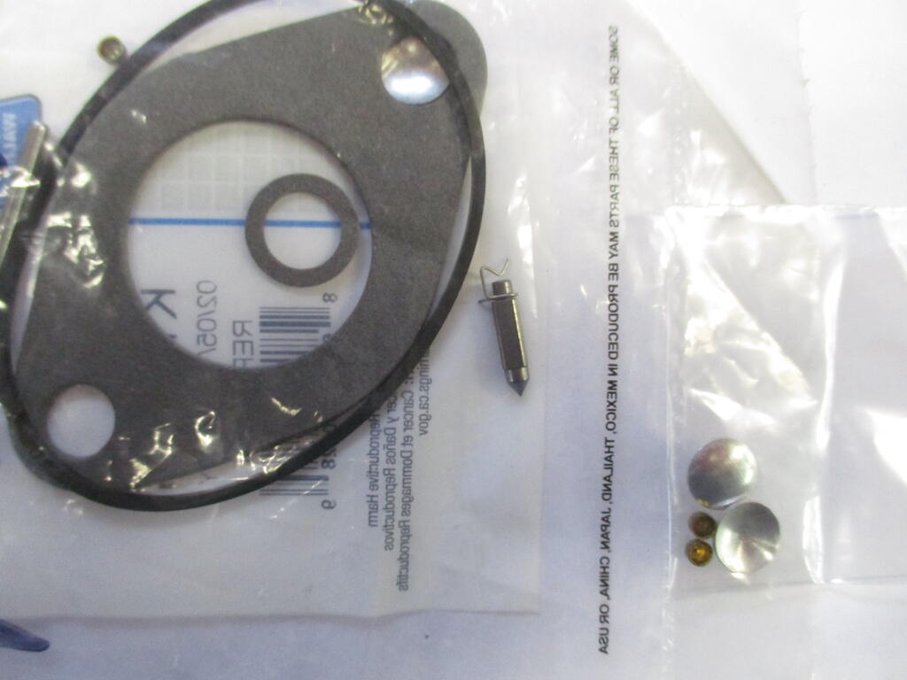

pfrederi 21,050 #14 Posted November 6, 2022 (edited) 8 minutes ago, squonk said: I have a Walboro on a K341 that I can't seem to find a kit Do you need Walbro K1-WHG ?? Fixed jet?? Edited November 6, 2022 by pfrederi Share this post Link to post Share on other sites

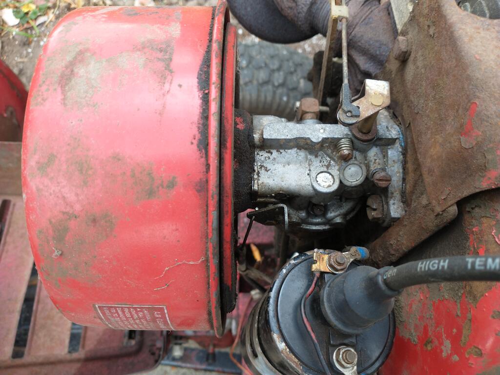

squonk 47,888 #15 Posted November 6, 2022 (edited) 14 minutes ago, pfrederi said: Do you need Walbro K1-WHG ?? Fixed jet?? Not sure yet. This is on my neighbor's tractor. Kohler engine. Started running like crap. There is what looks like a mixture screw and an idle mix screw. If I take what looks like the mixture screw out gas comes out. I'm wondering if the float is shot Edited November 6, 2022 by squonk Share this post Link to post Share on other sites
pfrederi 21,050 #16 Posted November 6, 2022 Looks like this Share this post Link to post Share on other sites
squonk 47,888 #17 Posted November 6, 2022 This is the carb 1 Share this post Link to post Share on other sites
pfrederi 21,050 #18 Posted November 6, 2022 It is adkustabke but I wonder if the float valve and little spring are the same... 1 Share this post Link to post Share on other sites
