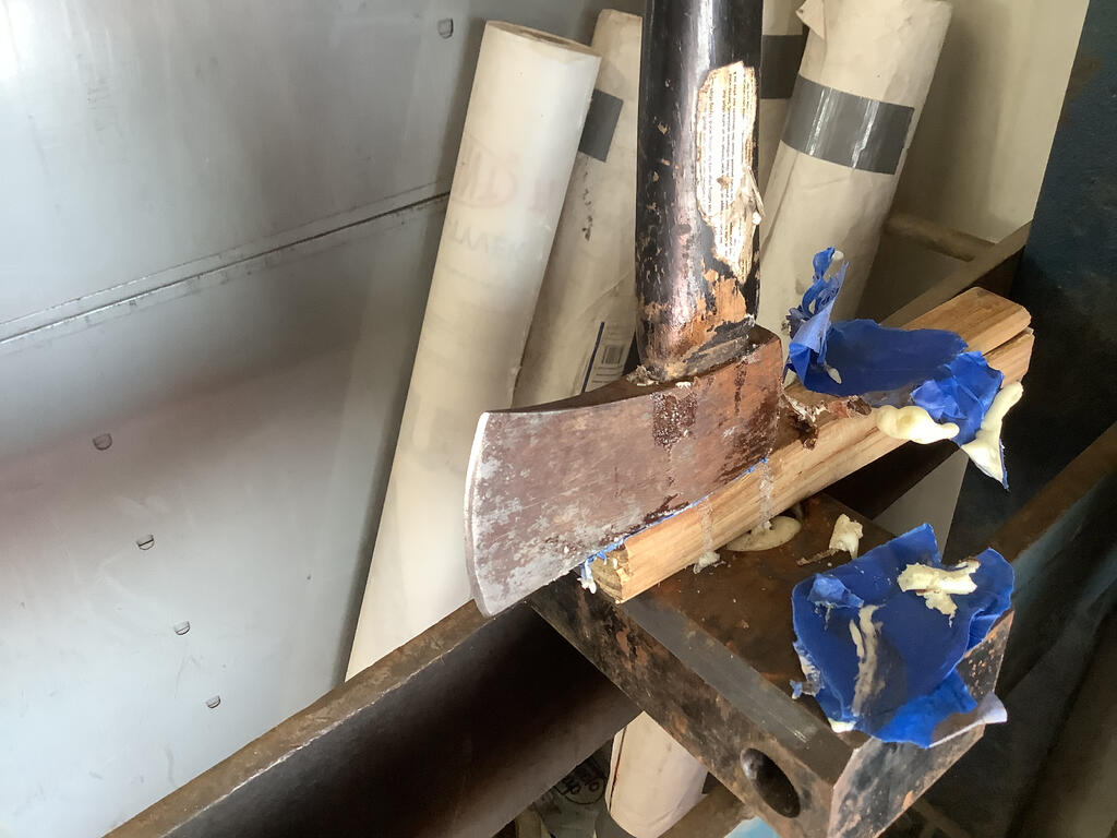

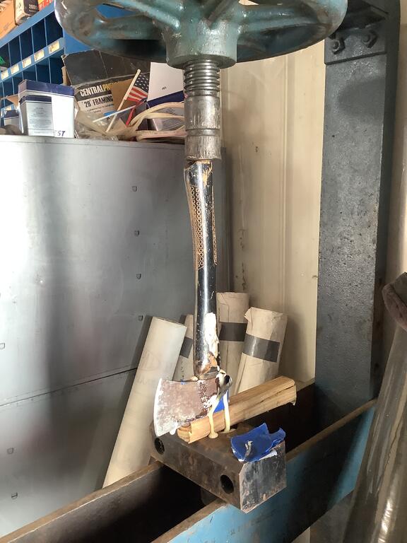

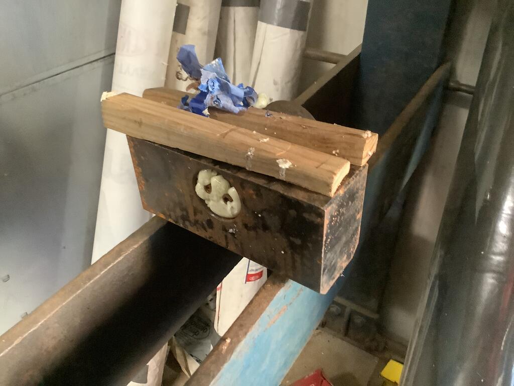

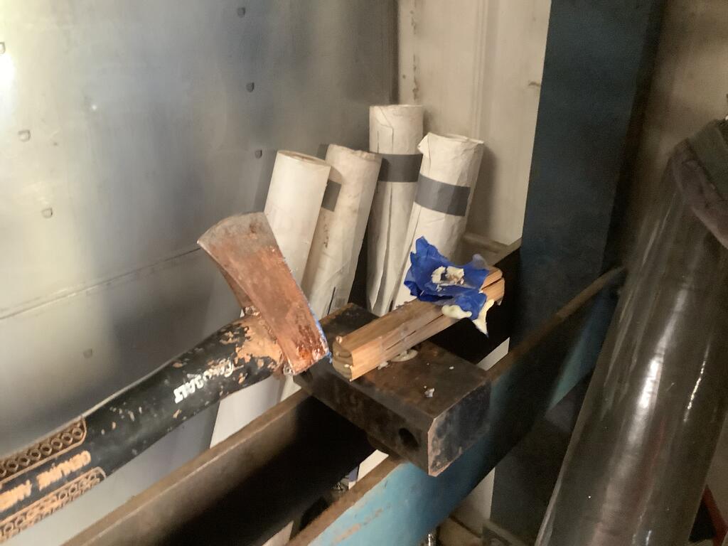

Pullstart 70,195 #1 Posted November 2, 2022 I’m more of a Hone Depot guy, but I’ve had this Kobalt (Lowe’s) hatchet for the better part of 15 years or so. I generally touch up the edge on a cinder block or rock wherever I’m working. Occasionally, it’ll get a file. I’m no @formariz but I get stuff done. Today, I decided to take back my barn from a bit of nature. There are trees and grapevines growing too close and I decided to clean ‘em up a little. The handle here had some funky epoxy capping it off and after all these years, the head was a tad loose. I ran the head up and down a bit (3/8” travel maybe?) by hand and blew out all the loose stuff. Then, I filled the cap with “Sticky A$s Glue” kind of like Gorilla Glue and taped it off. I then set it in the press and forced the handle down until glue came through and gaps between the handle and head. The glue is expanding and making a terrible mess, but there’s a belt grinder for that. 5 2 Share this post Link to post Share on other sites

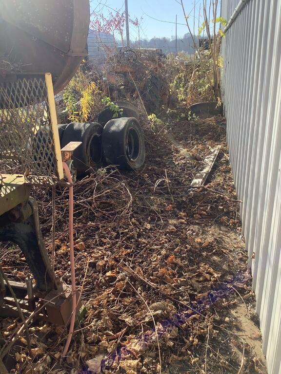

Pullstart 70,195 #2 Posted November 2, 2022 For reference, here’s some of my war path.. I am finding lots of treasures from the previous owners too 4 1 Share this post Link to post Share on other sites

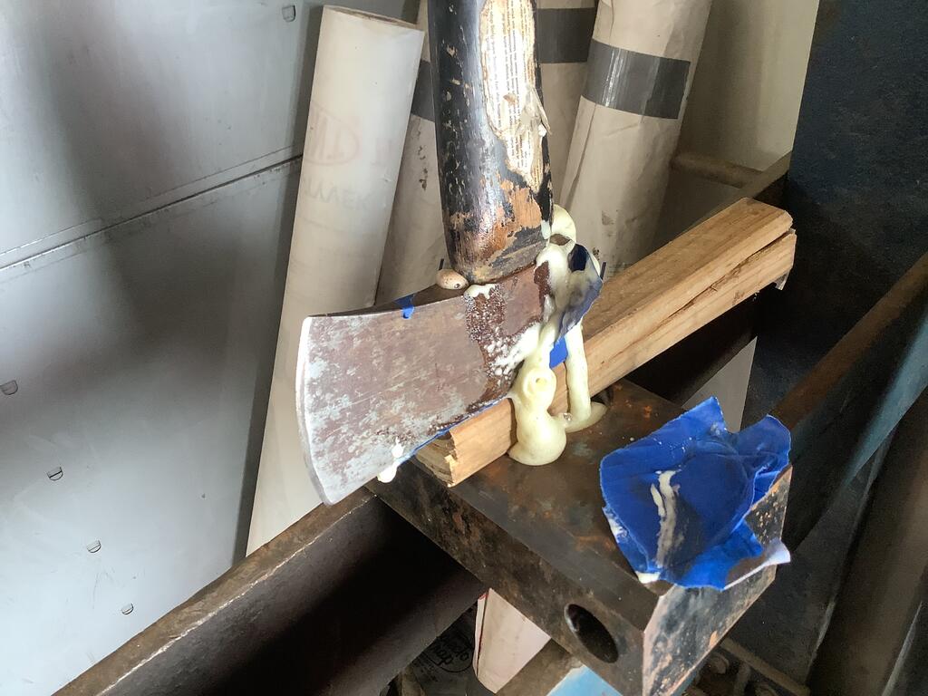

Pullstart 70,195 #11 Posted November 2, 2022 Back to the discussion on topic… The glue continues to expand, about 2.5 hrs later. I’ll keep the pressure on the handle until it is done changing. 2 Share this post Link to post Share on other sites

Pullstart 70,195 #13 Posted November 2, 2022 3 minutes ago, stevasaurus said: I was expecting Kevin in a thong with his privates glued together and a hatchet between his legs. Sorry to let you down Dino! I decided it might be a good time to scrape some excess glue and tape from the head. 1 Share this post Link to post Share on other sites
Snoopy11 5,731 #14 Posted November 2, 2022 9 minutes ago, stevasaurus said: I was expecting Kevin in a thong with his privates glued together and a hatchet between his legs. Patience, Steve. That will come... particularly if the glue on that hatchet handle doesn't hold... Don 3 Share this post Link to post Share on other sites

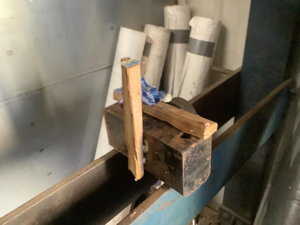

oldlineman 1,742 #15 Posted November 2, 2022 Is that piece of wood now glued to your hatchet Kevin? 2 Share this post Link to post Share on other sites
Pullstart 70,195 #16 Posted November 2, 2022 2 minutes ago, oldlineman said: Is that piece of wood now glued to your hatchet Kevin? the blue tape was surrounding the hatchet head originally… but if it is stuck, I have a saw for that. 2 Share this post Link to post Share on other sites
Pullstart 70,195 #17 Posted November 3, 2022 @oldlineman if only I had used a little more blue tape in my setup… The hatchet came right off the block, the block was lightly glued to the steel “anvil”. 2 Share this post Link to post Share on other sites

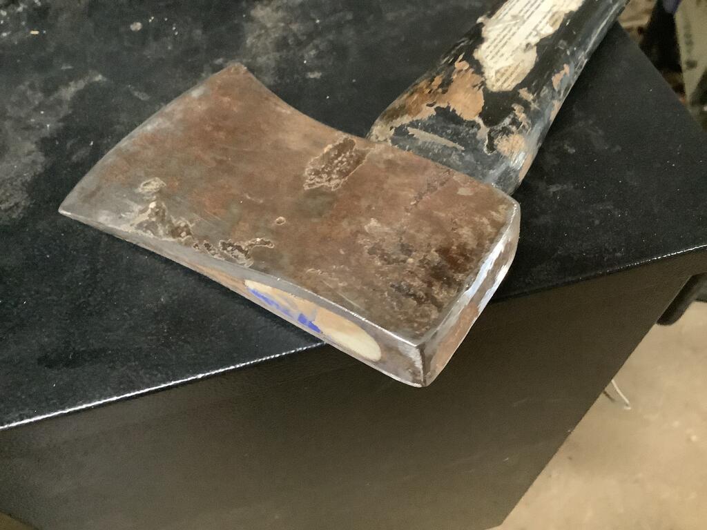

Pullstart 70,195 #18 Posted November 3, 2022 I cleaned up some excess with a wire wheel and the belt sander, and now it’s time to try it out. 2 Share this post Link to post Share on other sites

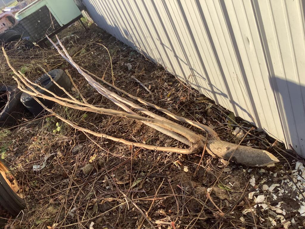

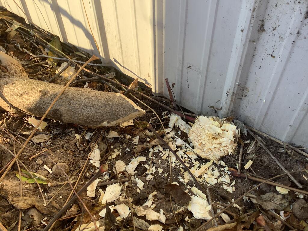

Pullstart 70,195 #19 Posted November 3, 2022 I’m not sure if it was stubbornness, or the eager beaver attitude of the hatchet, but the tree is down! You can see that I’ve cut this tree down once before. I’ll have to keep after new growth and maybe get some stump killer if it takes off again. 4 Share this post Link to post Share on other sites
Snoopy11 5,731 #20 Posted November 3, 2022 Judging from the amount of smack lines in that wood... you should sharpen the blade on that hatchet... Don 1 Share this post Link to post Share on other sites
