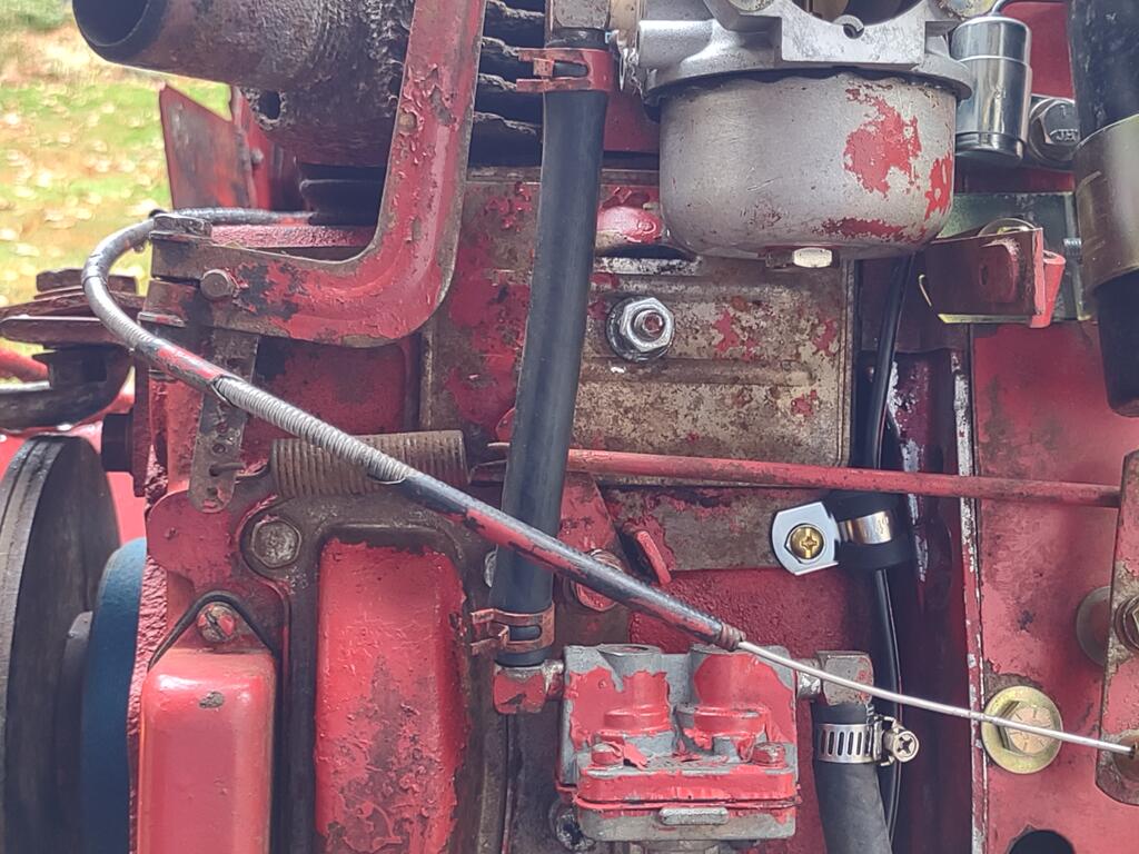

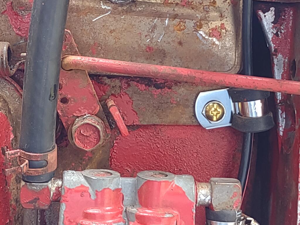

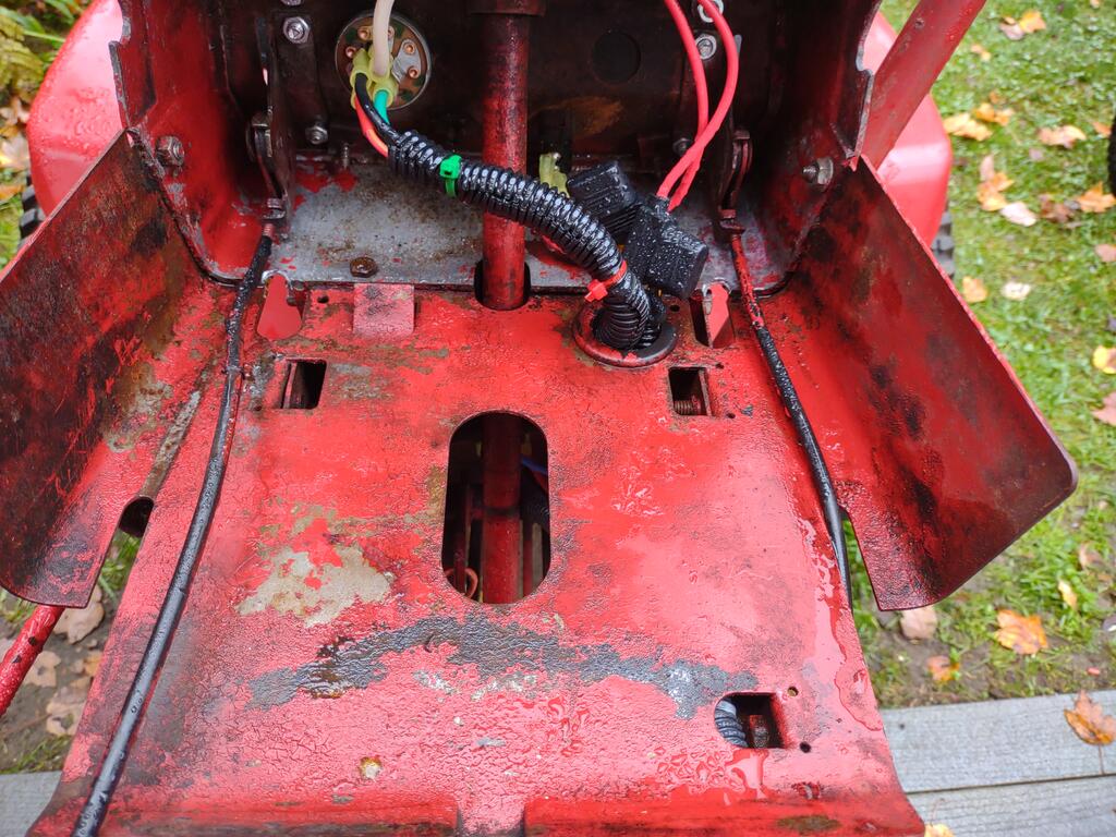

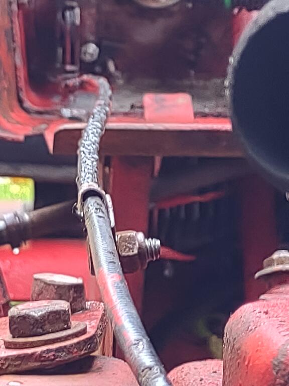

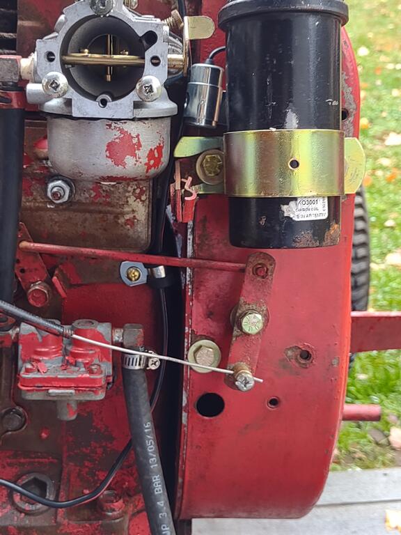

rmaynard 17,422 #7 Posted November 1, 2022 (edited) I apologize in advance for the watermarks on these pictures, but you should be able get what you need from the images. These pictures are from a B-100. Routing is the same on a C-100. Edited November 1, 2022 by rmaynard 1 1 Share this post Link to post Share on other sites

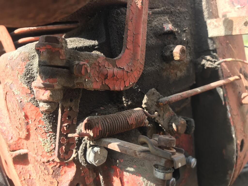

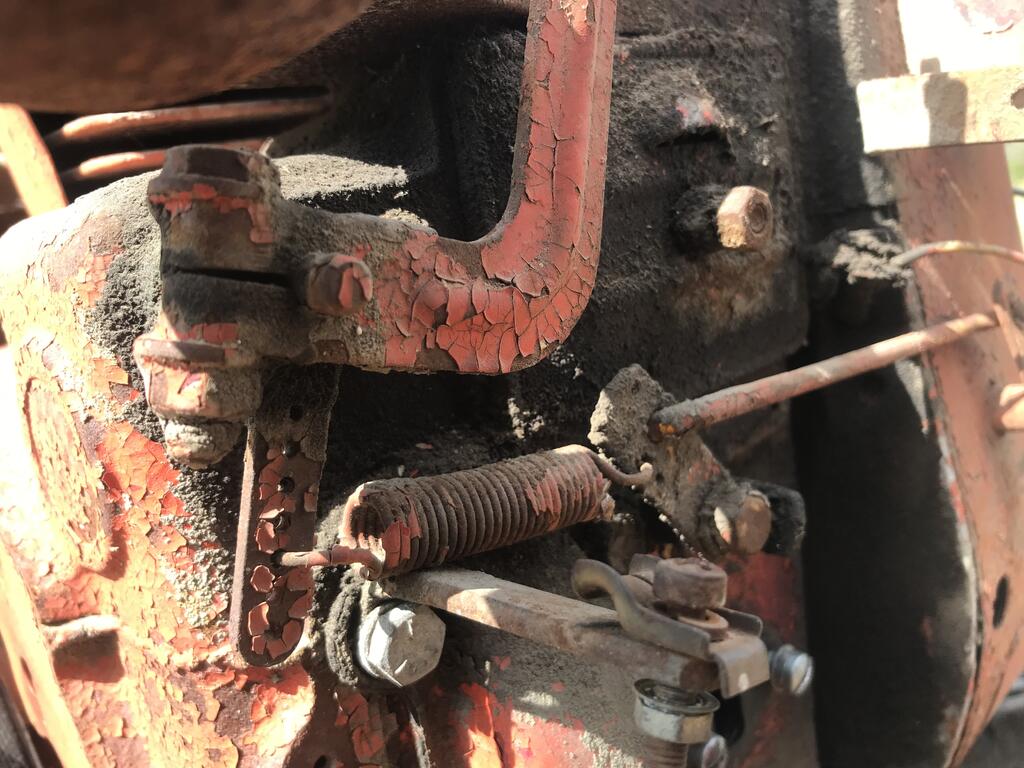

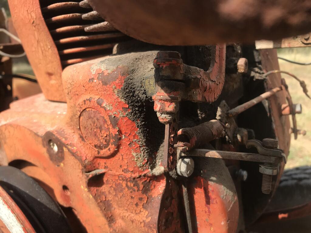

oliver2-44 11,626 #18 Posted November 5, 2022 @JP56 Sorry for the delay. This weekend is our deer season opening weekend so I’ve had things to get ready at the farm/camp This is a 1969 Raider parts machine I just got trading some parts. I have the carb off cleaning it to see if engine will run. So the throttle cable is not in place. Notice the bracket arm sticking out below the governor spring. It is mounted with one bolt on the top left cam gear cover. So instead of the throttle cable curving tightly around the corner of the engine at the muffle and throttle arm area it goes forward and turns at this bracket then goes to the bell rank like normal. This bracket gets the cable out in front of all the governor linkage nice and clear. I’ve never seen one like this before. The bracket looks factory made. Here another picture @Ed Kennell Your a Raider guy, have you (or anyone else) ever seen a throttle cable bracket like this? I like it! Share this post Link to post Share on other sites
JP56 42 #19 Posted November 5, 2022 58 minutes ago, oliver2-44 said: @JP56 Sorry for the delay. This weekend is our deer season opening weekend so I’ve had things to get ready at the farm/camp have you (or anyone else) ever seen a throttle cable bracket like this? On 10/31/2022 at 8:53 PM, JP56 said: Thanks Jim, No problem! I have never seen one like that but I sure wish I had that bracket right now! Share this post Link to post Share on other sites
Ed Kennell 46,557 #20 Posted November 5, 2022 11 hours ago, oliver2-44 said: @Ed Kennell Your a Raider guy, have you (or anyone else) ever seen a throttle cable bracket like this? I don't have a Raider now, but I don't believe any of the 6-8 that have passed thru my barn had that bracket. Share this post Link to post Share on other sites
Jeff-C175 7,209 #21 Posted November 5, 2022 Looks homemade to me... and you can see that 'extra' loose bolt on the valve cover stud where the bracket should be... Share this post Link to post Share on other sites
JP56 42 #22 Posted November 6, 2022 10 hours ago, Jeff-C175 said: Looks homemade to me... and you can see that 'extra' loose bolt on the valve cover stud where the bracket should be... I got mine up & running tonight, called it quits about 5:45. Still has a miss in it & you would not believe what I went thru trying to set the point gap! I am not positive but I am suspecting that maybe a key snapped of on the flywheel shaft it there is one there, because after watching the videos & trying to set the gap according to those, both with a meter or by eye thru the peep hole, I could only get the gap to set & send spark by setting the gap almost 1/2 way between the S & T marks on the flywheel. I opened it yesterday 7 cleaned the heck off it so I could see it. I probably should have done the points while I still had it apart ! Tomorrow I will take pics & post how I ended up doing the throttle cable & attaching it where that bracket was missing. Now I am trying to find a good adhesive to glue my new brake lining into the band. That will be tomorrows project & I started adapting a 5HP push around leaf blower to attach to the front of the tractor so I don't have to walk that bugger all over my 1 acre yard with those stupid 2" swivel casters on the front of it. Got things laid out today, just a couple of cuts & some holes to drill for attaching it tomorrow ! I am putting it on a swivel on the deck drive belt tensioner in that center hole above the adjusting knob. If that works out as well as I hope, I will post that too. Maybe put it under "What did you do to your Horse today" 1 Share this post Link to post Share on other sites
