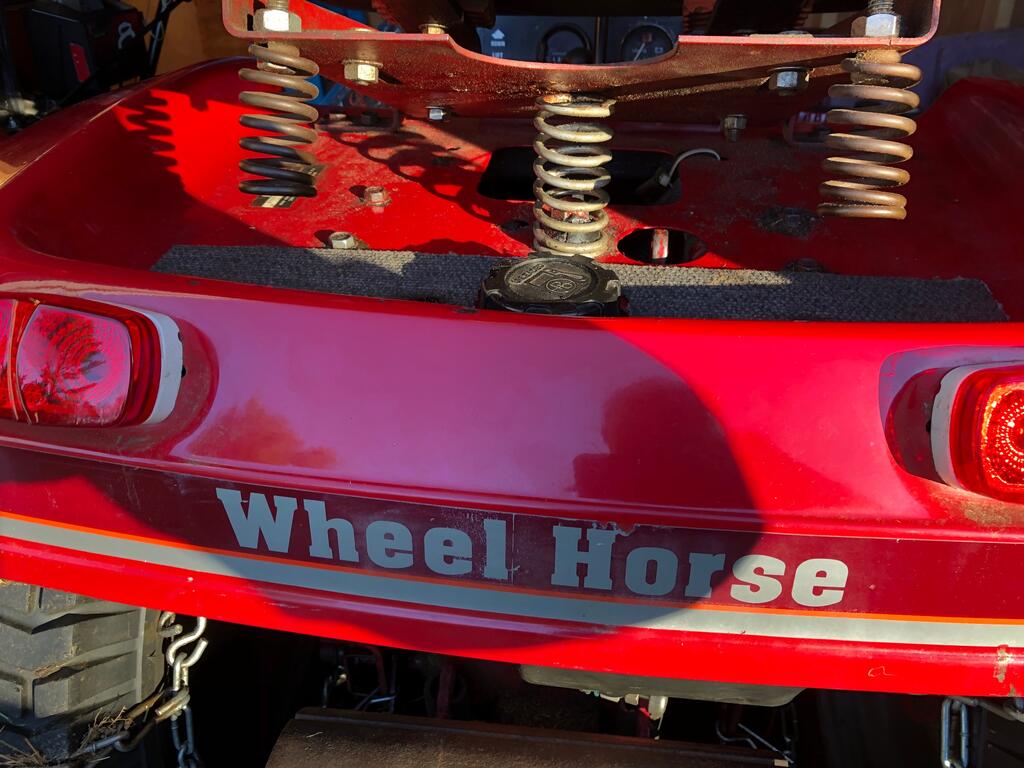

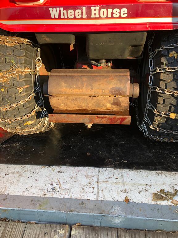

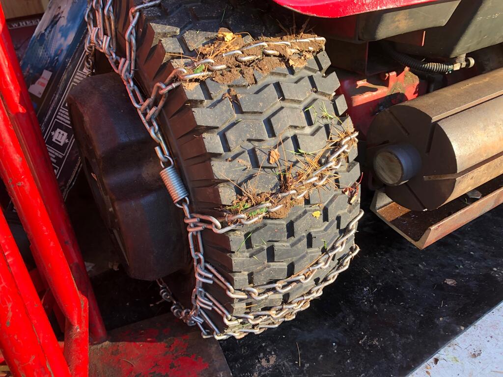

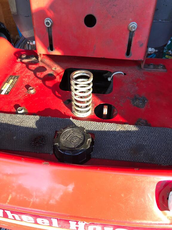

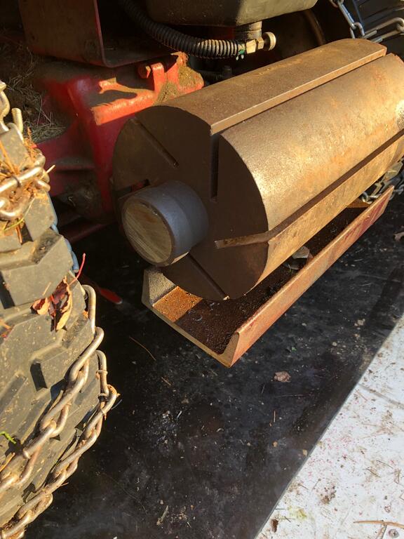

peter lena 9,471 #1 Posted October 30, 2022 just added , chains , my vacuum weight rotors , on to 6" angle steel to slot fit on rotor , lubricate the slot fit and its instantly trapped , use sweco sifter vibrator pad spring on my seat center , bolt on a size to size fit rubber snubber to trap and hold spring . another experiment , also regularly use springs to chase / maintain tire chain installation and use . 100 lb rotors , works for me . pete 1 2 Share this post Link to post Share on other sites

peter lena 9,471 #7 Posted October 30, 2022 @Pullstart BUSCH VACUUM PUMPS were used to vacuum draw product from industrial exchangers , we had buildings that were always using them , the slots on the rotor held a carbon fiber . food grade insert , unit was horizontally mounted in a water jacketed steel sleeve , as it spun the carbon blades, would fling out to the sleeve and make a vacuum seal . allowing you to extract tons of product . PFIZER made many food grade concentrates , like caffeine , artificial hoops for beer , penicillin . we had metal bins for every kind of metal . and glass , running non stop 24/7 , being in maintenance , we were constantly rebuilding and replacing equipment . getting a pass for used metal was not a problem , used to regularly dive glass lined tanks , 2000 k size , for inspection and patch work . what I used to do , pete 1 1 Share this post Link to post Share on other sites
