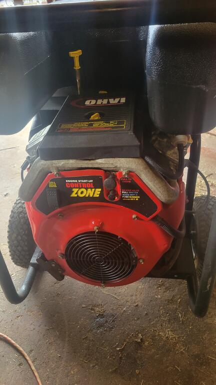

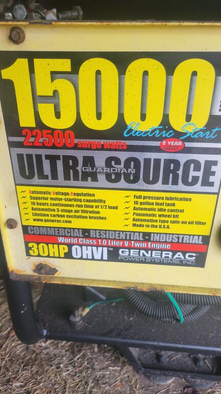

RED-Z06 2,718 #64 Posted November 30, 2022 3 minutes ago, RED-Z06 said: Its the best method, run it dry...tank, lines, carb...stuff can sit years bone dry and fire right up out of hibernation...thats how we do it in the south with generators when we dont need them for 8 years then suddenly need them to run for a couple weeks straight I ran this dry in 2020, didnt need it this year or last so i rolled it out to out a pint in it and exercise it. Cranked up on 2 or 3 seconds of cranking...ran a few minutes on a pint...shes a thirsty girl 1 1 Share this post Link to post Share on other sites
