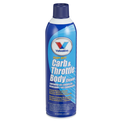

Lagersolut 797 #36 Posted November 30, 2022 I have a different method for starting one sitting awhile - just take the air cleaner off 1 or 2 small shots of carb cleaner - choke - crank - they always take right off . I like Valvoline . 2 Share this post Link to post Share on other sites
Jeff-C175 7,207 #37 Posted November 30, 2022 7 minutes ago, Lagersolut said: different method How nice would it be if you didn't have to do that though? 1 Share this post Link to post Share on other sites
Lagersolut 797 #38 Posted November 30, 2022 51 minutes ago, Jeff-C175 said: How nice would it be if you didn't have to do that though? It would - I have a new electric fuel pump in my parts box - first fuel pump to go out wins it but I won't change things up until something goes out . 1 2 Share this post Link to post Share on other sites
