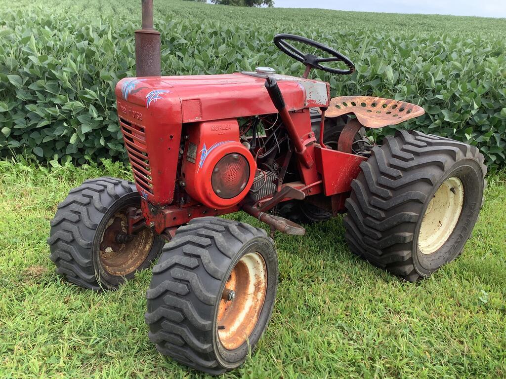

Pullstart 71,100 #5 Posted October 28, 2022 Keep in mind, you’ll need either a recoil or a starter/generator for the battery to fit right. A normal starter gets in the way. 2 2 1 Share this post Link to post Share on other sites
Snoopy11 5,731 #6 Posted October 28, 2022 Nice rubbers bro... Bet that mochine pulls like a gorilla aye' @Pullstart Don Share this post Link to post Share on other sites
Pullstart 71,100 #7 Posted October 28, 2022 23 minutes ago, Snoopy11 said: Nice rubbers bro... Bet that mochine pulls like a gorilla aye' @Pullstart Don Two of them (opposite corners) kept going flat, so I took the valve cores out and let them all run flat. There is zero air pressure in ‘em! It crawls, but doesn’t have the MOST pulling ability. Just fun. 1 Share this post Link to post Share on other sites
