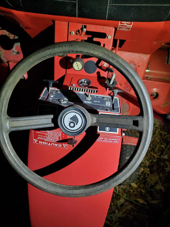

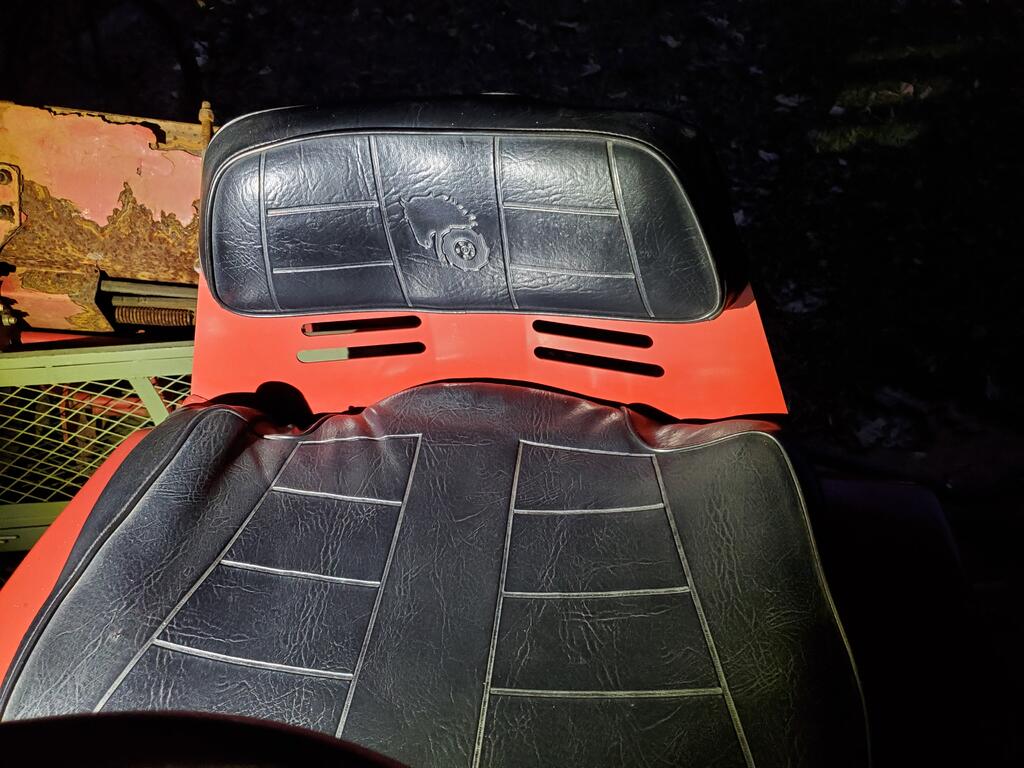

GAJoe 852 #51 Posted November 20, 2022 I like the seats better also. They look like a well broken in leather; they're not are they? What should be applied to keep it looking good and not crack? And that steering wheel cap tops it off. 3 3 Share this post Link to post Share on other sites
GAJoe 852 #52 Posted November 20, 2022 (edited) 8 hours ago, ebinmaine said: That should be a 1974 or 5. Looks to be in good solid overall condition. The absolute beast of the vintage. The holy grail of Wheelhorses to many. I have 6 of them here in our herd. You've done VERY well. Yes It's a '74. He gave me the manuals and some notes that I haven't had time to review yet. Edited November 20, 2022 by GAJoe 2 2 Share this post Link to post Share on other sites

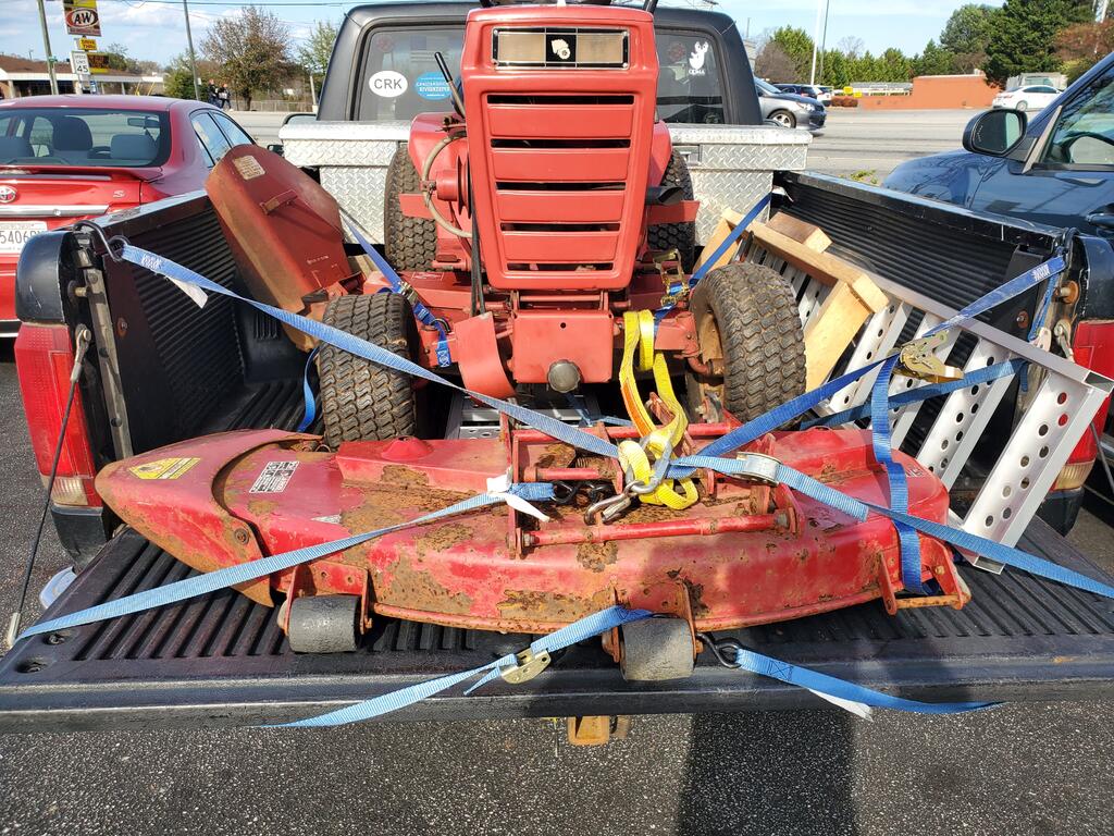

GAJoe 852 #53 Posted November 20, 2022 (edited) I had recalled seeing a add for a deck that had surface rust so I got in touch with the seller. It was less than 20 minutes from the tractor location. I went by and bought it. And had room to take it with me. Can some one tell me if a 300 series deck will work on the C-160 also? Both are the "Attach a Matic" quick connect. Edited November 20, 2022 by GAJoe 3 Share this post Link to post Share on other sites
ebinmaine 79,148 #54 Posted November 20, 2022 13 minutes ago, GAJoe said: Can some one tell me if a 300 series deck will work on the C-160 also Yes it do. 1 1 Share this post Link to post Share on other sites
ebinmaine 79,148 #55 Posted November 20, 2022 1 hour ago, GAJoe said: They look like a well broken in leather; they're not are they? Should be vinyl. Not sure what to wash/treat it with. 1 Share this post Link to post Share on other sites
953 nut 66,600 #56 Posted November 20, 2022 11 hours ago, GAJoe said: I like the seats better also. They look like a well broken in leather; they're not are they? What should be applied to keep it looking good and not crack? Great buy, the C-160 is a great tractor and yours looks well cared for. You have the best looking three piece seat I've seen in a long time. What ever you do don't use Armorall spray, the seat will be so slippery you can't drive it. Keep it clean and out of the sun and you should be fine. 3 1 Share this post Link to post Share on other sites
sjoemie himself 3,112 #57 Posted November 20, 2022 I've read that vinyl is best cleaned with water and a bit of dish soap. 2 1 Share this post Link to post Share on other sites
WHX?? 56,847 #58 Posted November 20, 2022 You do realize a 160 -8 is on many a bucket list here! Nice score There are vinyle cleaners and protectors out ther. Any big box should have it. 2 Share this post Link to post Share on other sites
