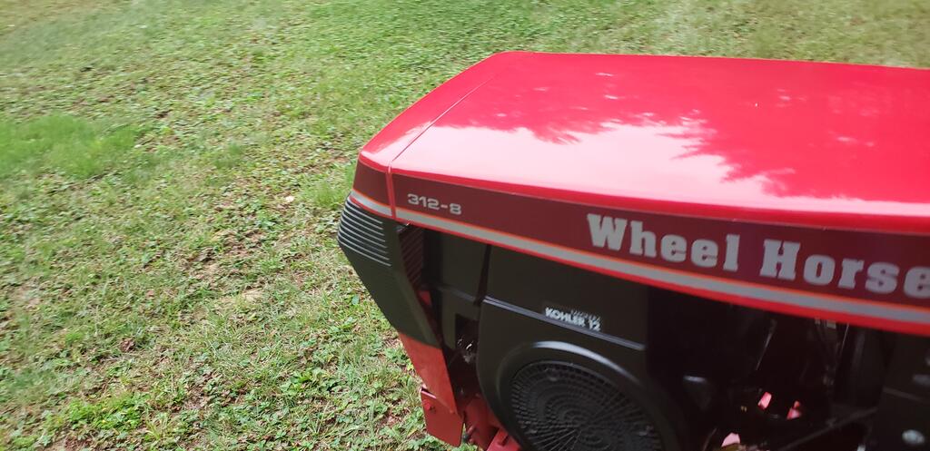

GAJoe 852 #1 Posted October 26, 2022 Hellow from NE GA, with Currahee Mtn. out my breakfast window. I'm 59 and been using a self propelled walk behind until the personal pace wore out for the second time a couple years ago and been pushing it sense. I started looking for a rider to pre retire with and remembered that years ago I had discovered Wheel Horse machines that were 40 years old and still going strong. I told myself then that when it came time to get a rider I want to get a Wheel Horse that will last the rest of my life with some maintenance and proper use. I'm looking to get my first Wheel Horse; favoring a pre Toro 312-8. Can you guys/gals guide me in making a check-list? I don't expect a flawless tractor as I see so many of that are stored indoors up north. But I hope to get a solid functioning machine that isn't in need of a major repair that I discover once I get it home. I don't mind having to do some minor fixes; things wear in forty years of use. What are the signs that tell you that it's wore slap out? Please list your experiences that you hate to remember to help a fellow Wheel Horse fan avoid that same sinking feeling that you once had. Thanks for your help, Joe 3 2 Share this post Link to post Share on other sites
