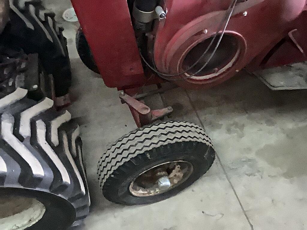

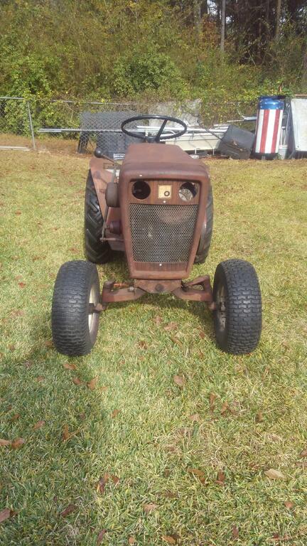

Docwheelhorse 2,847 #1 Posted October 24, 2022 Hello All, I'm posting here as I think more eyeballs will see it versus the "wanted" section of the classifieds... if the admins want to move it I understand. My 953 has 16x6.50x8 front rims with the full tapered roller bearings. I swear I've seen narrow front rims for the 953 out there... I have narrow rear tires and really would like 4.80 x 8 fronts... Anybody have a set of rims and tires or just rims they would part with? I'd be more than willing to pay shipping---that's if they actually exist and i'm not all confused to heck. Thanks in Advance Tony Share this post Link to post Share on other sites

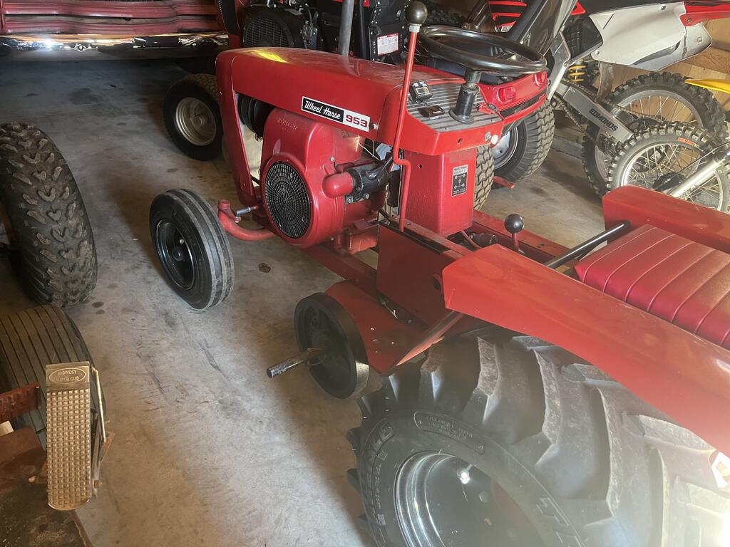

stevebo-(Moderator) 8,604 #2 Posted October 24, 2022 Puller 953 but I also have the narrower ones on my original 953 1 Share this post Link to post Share on other sites

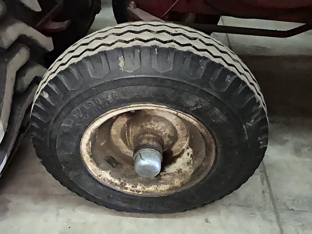

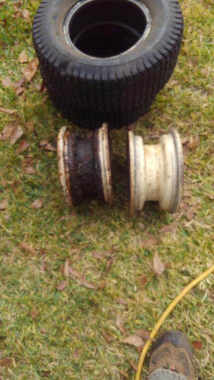

Pullstart 68,801 #3 Posted October 24, 2022 16 minutes ago, Docwheelhorse said: 16x6.50x8 front rims with the full tapered roller bearings that’s the tire size. You might want to measure the rim width to be sure. A 4.8x8 might just fit your stock wheels.. 3 Share this post Link to post Share on other sites
Pullstart 68,801 #4 Posted October 24, 2022 I’ve got no reason to believe these are not stock wheels.. The tires are 4.80/4.00-8 1 Share this post Link to post Share on other sites
Docwheelhorse 2,847 #5 Posted October 24, 2022 41 minutes ago, Pullstart said: I’ve got no reason to believe these are not stock wheels.. The tires are 4.80/4.00-8 Thanks.... maybe I'll just get a set of 4.80x4's mounted up and see what happens. 1 Share this post Link to post Share on other sites

Skwerl58 783 #8 Posted October 24, 2022 My 1054 has narrow ones and they need replaced. When I get rims I am going with thin rims and tri rib tires because it has ags on the rear and this combo looks good. Share this post Link to post Share on other sites

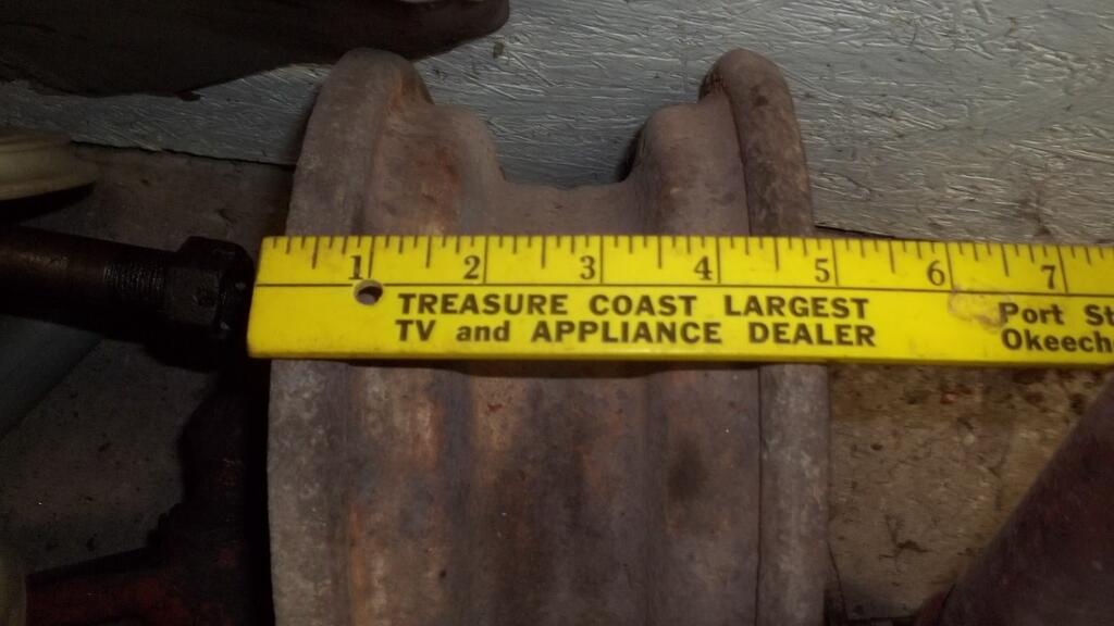

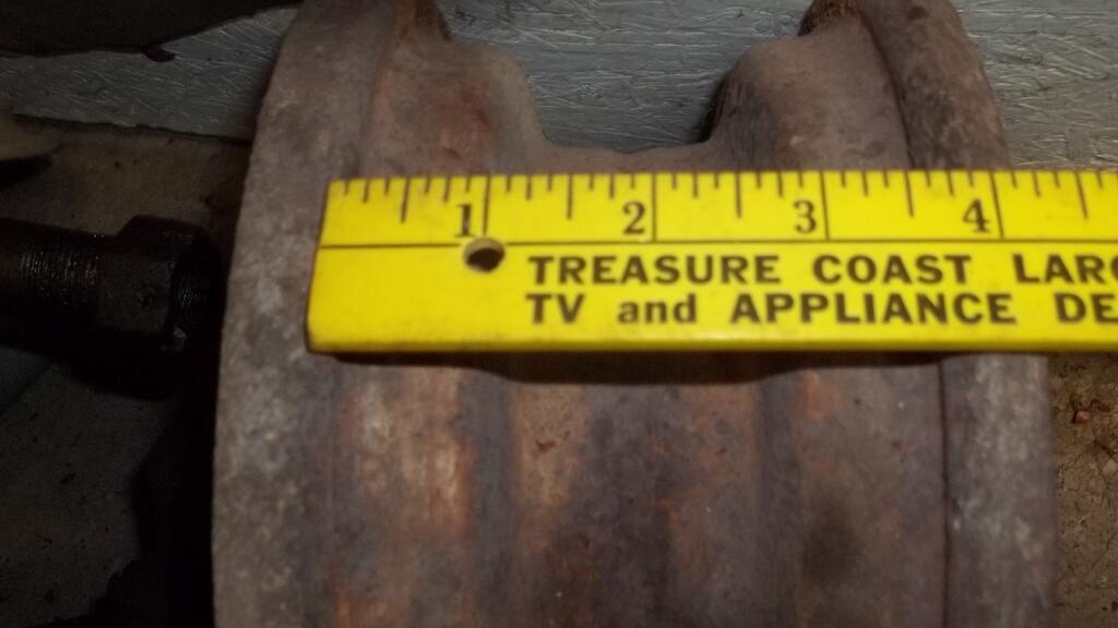

953 nut 64,015 #9 Posted October 25, 2022 All 953, 1054 and 1045-A front rims were WH part number 3369. The inside bead width is about 3 3/4" and overall width of just under 5". 1 Share this post Link to post Share on other sites

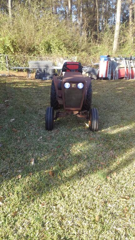

Lee1977 7,547 #10 Posted October 26, 2022 I used WH trailer wheels that were 3" wide with 400x 8 trieibs. The hubs were 4 1/2" had to cut 3/4" off to get the to fit on the 312. It's a worker so I cut the out side to get the front track wider. 1 Share this post Link to post Share on other sites

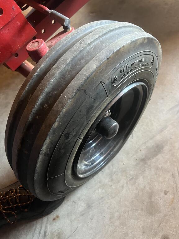

JPWH 6,542 #11 Posted October 27, 2022 I removed the 6.5 from the wheels cleaned them up and installed 4 tri rib. 3 Share this post Link to post Share on other sites
