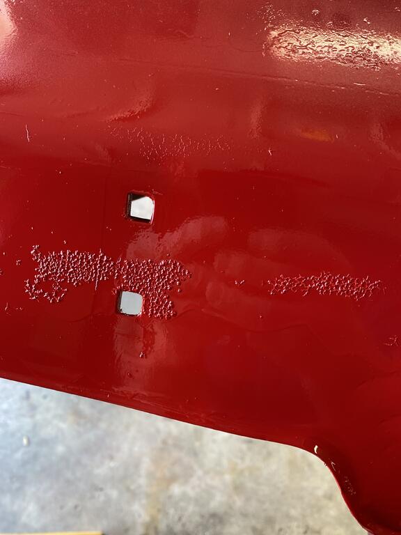

bo dawg 637 #1 Posted October 23, 2022 What causes this to blister up when I spray the clear coat? It was a smooth coat of paint I put on yesterday and put hot it today with the clear and it does this? 1 Share this post Link to post Share on other sites
kpinnc 18,259 #2 Posted October 23, 2022 You have to clear coat immediately after base coat, or wait several days or longer until the base cures. The clear reactivates the base and causes it to lift otherwise. Sometimes full curing takes weeks. 7 1 Share this post Link to post Share on other sites
SPINJIM 1,997 #3 Posted October 23, 2022 I've had that happen even after leaving a couple of weeks between coats. Rustoleum seems very slow to cure completely. Even do a second coat within an hour, or wait until next year, like I do after some bad experience. Jim 3 Share this post Link to post Share on other sites

kpinnc 18,259 #5 Posted October 23, 2022 1 hour ago, kpinnc said: The clear reactivates the base and causes it to lift otherwise. Sometimes full curing takes weeks. One more thing- even if the base has been on for a year. If you wet sand or lightly scuff the base coat, wait at least a couple days before ANY other overcoat. 5 Share this post Link to post Share on other sites

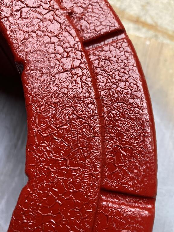

Sparky-(Admin) 25,309 #17 Posted October 24, 2022 Same thing happened to me on these wheel weights. Super annoying! 1 2 Share this post Link to post Share on other sites
