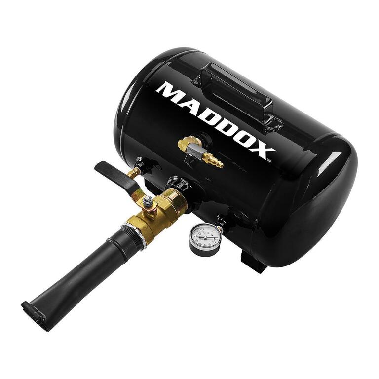

Most tire shops have a bead sealer similar to the pic below. They should be able to do it fairly cheap, and will use sealer on the beads as well.
That being said, the ratchet strap definitely works. Just be careful. There tends to be a whole lotta pressure on that strap when you break it loose.

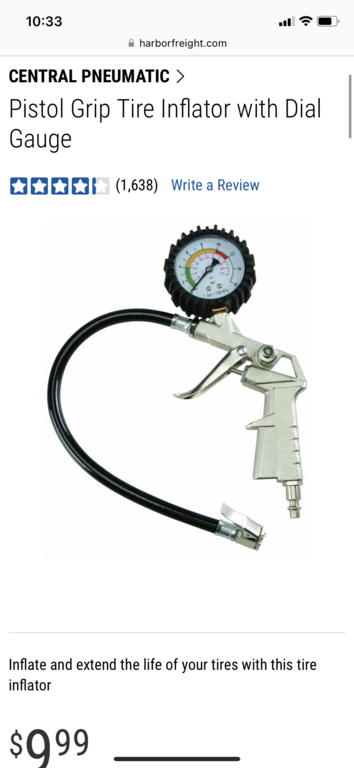

Heatingman
The tire stem should be replaced. You can order a tire stem tool and some stems cheap on Amazon. Maybe 10 bucks.
If the rim is bad, just get some tubes.
But,
In lieu of a bead blaster;
To seat beads, take the valve core out of the stem, and use an air chuck that will clip into place.
while holding the air on, bounce the tire up and down, and change the point of bounce on the tire, IE rotate and bounce.
once the bead takes, fill to 10 psi or so, remove the air hose and insert the core, then pressurize to proper fill.
This is the type of air chuck I use:
