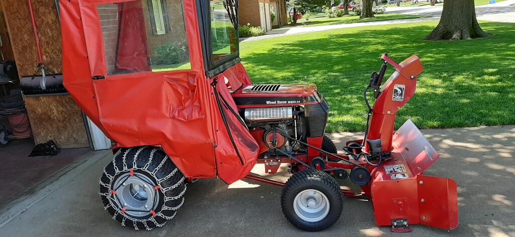

WHX?? 58,194 #7 Posted October 18, 2022 Tight... I jack one side up and lay it over the top on a deflated tire then connect at the bottoms. Makes it easy to roll through tire to get it to lay just right. These nifty keepers @dclarke had on but those rubber tie downs work too. 1 2 Share this post Link to post Share on other sites

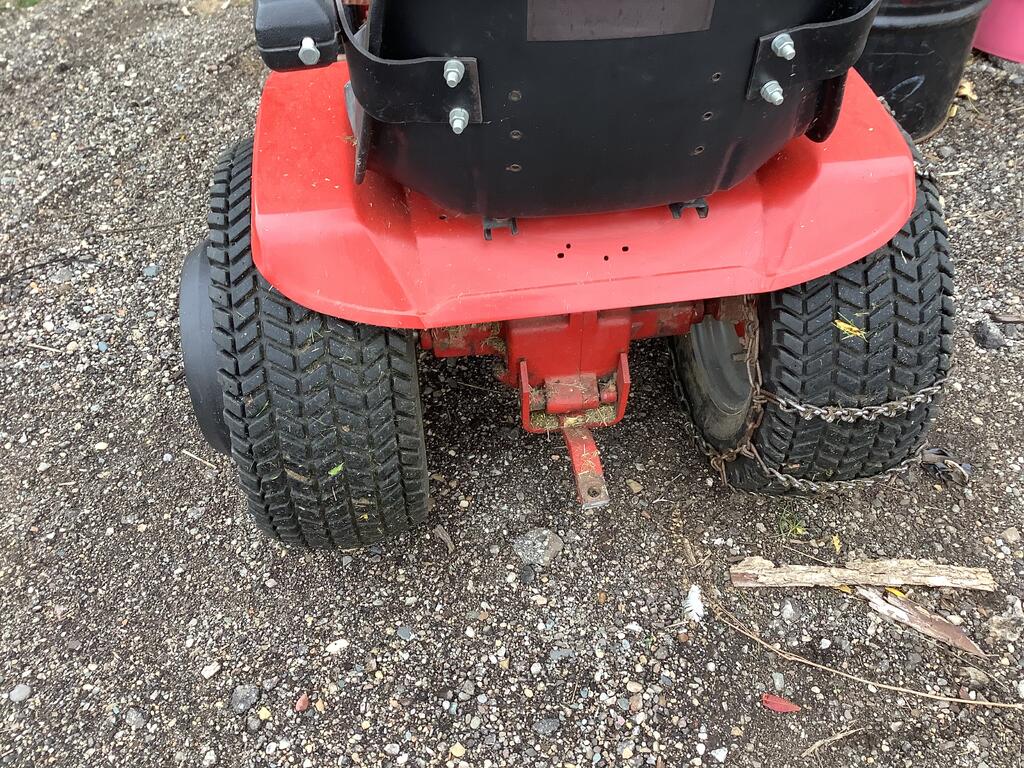

Snoopy11 5,731 #11 Posted October 18, 2022 7 hours ago, Gregor said: do you want them tight, or a little loose? 1 hour ago, Jeff-C175 said: Tight as I can gettem. I made my own custom springs to keep mine tensioned. I may make more tensioning springs to go on the back side, once I get spacers on the machine and have more room to work with... I really think... with a gravel driveway, having the chaines loose would certainly destroy chains (just my thought though)... Don 2 Share this post Link to post Share on other sites
