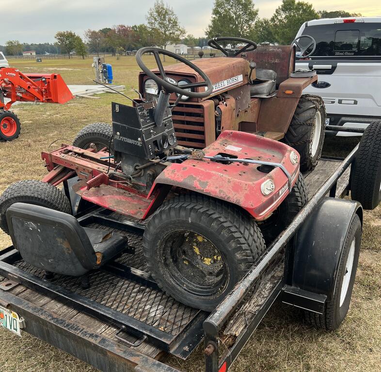

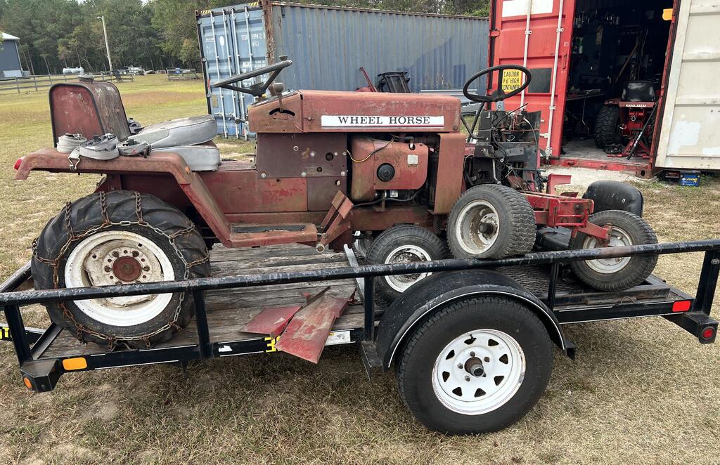

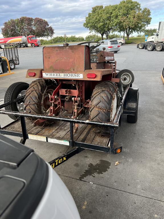

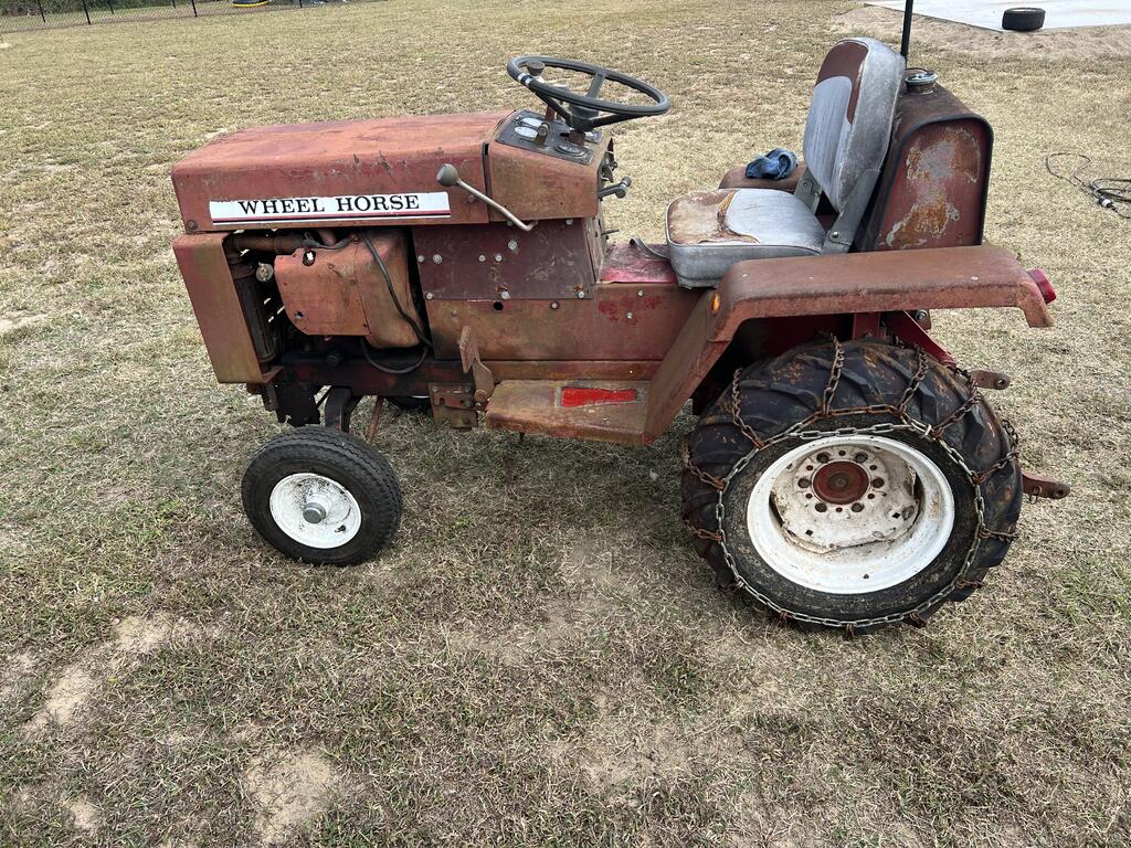

19richie66 17,770 #1 Posted October 17, 2022 I told my wife this is it. And it will be unless a Pond senior drops in my lap for next to nothing Yeah, like that’s gonna happen. So I was offered this D200 and some misc parts. I drove to Pine Grove, Pa and met up with Brian (SuperC4me) to get my treasure. Unloaded and reloaded, ate some lunch and hit the road. Left my house at 3am and got home at 9:40 pm. Very tiring but beautiful scenery. I ended up with a D200, 418-A roller, spare D transmission and pump, a Kohler M10 engine and two steering columns from different brand tractors. A good haul. A big thanks to Brian for making it happen. I got it running this morning but she won’t move. I see some transmission work is in my future. 8 9 1 Share this post Link to post Share on other sites

19richie66 17,770 #4 Posted October 17, 2022 23 minutes ago, Pullstart said: Sorry Karen, there’s no fix for Wheel Horses Anonymous! Nice find Richie! What size are those rear tires, they seem smaller than the normal 24x12’s on a D. Plans for it? Worker on the farm? Those are actually the 15” wheels. Not sure what the size is. Just got around to messing with it today. Will look tomorrow. Took the snow chains off and the tires are toast. I have another set of tires just like what’s on Skittles but need 10” wide wheels to run them. 2 Share this post Link to post Share on other sites

19richie66 17,770 #8 Posted October 17, 2022 (edited) The tow valve is closed. I did back it out and reseat it. The hydraulics do work. Not sure how fast the lifts are supposed to work. It seems slow but both cylinders do work. When I move the motion lever, it does move a hair forward or backwards and then stops. Makes a strange gurgling/grinding noise. I checked the parking brake lever to make sure it was off. Fluid is full and clean with newer filter. Thinking something inside the drive motor has wet the bed. I’ll pull the drive motor and check it. Edited October 17, 2022 by 19richie66 3 Share this post Link to post Share on other sites

19richie66 17,770 #18 Posted October 18, 2022 @Pullstart 27-8.50x15 is what’s on here. 2 Share this post Link to post Share on other sites
