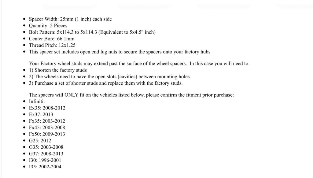

Snoopy11 5,731 #30 Posted October 17, 2022 @ebinmaine... @Pullstart ...whatchya guys think about these here...? Ya' think they will work? https://www.ebay.com/itm/191156083019?epid=11003838384&hash=item2c81ca594b:g:j1AAAOSwFWdbHy-k&amdata=enc%3AAQAHAAAA4HDgorKovvDkjUJkgeFhNTn28YQA1LijT7JCIt2EepmQIof6nN3rrHRz3R11LvqgeaeMlQ4Bp%2FhOlvTCwPwfj%2Bh1qk0jQ9oO021qXgEib0Mrq%2BS3KyeY125mtNuGWaM9pCKziG%2Fk7L8C6cak8z7u7I42ectb8qWMDBpxj1RSUi31k4q4CIWd5rXKS23xbCrPoNLmTb1awqvajCpWGidR4D3bIODWaAcRdU8W16OPm8m2AHI88Mzh1qXtcxf%2F3Q7DHl%2FxZTw3CHfqxbBKmyRGV2uT349nbFhWgfgx4IpBAmUm|tkp%3ABk9SR6jH8oH9YA Don Share this post Link to post Share on other sites
Pullstart 71,088 #31 Posted October 17, 2022 @Snoopy11 so long as the hub bore fits… 1 Share this post Link to post Share on other sites
ebinmaine 80,275 #32 Posted October 17, 2022 33 minutes ago, Snoopy11 said: Ya' think they will work? I buy ONLY flat surface spacers because I've fought a battle with the hub centric rings in the past. As long as your own wheel fits that ring and that spacer inside diameter fits your hub you're ok. 1 Share this post Link to post Share on other sites
Snoopy11 5,731 #33 Posted October 17, 2022 (edited) @ebinmaine... @Pullstart So, I did some engineered scaling... (in other words, I took the wheel off and measured... just sounds cooler to say it the other way)... and here is what I found out. The rims on the L-157 are 3.5" bolt circle... 2-3/8" center bore. So... that makes things a good bit more difficult. I wonder why they used such strange rims in '67? Don Edited October 17, 2022 by Snoopy11 Share this post Link to post Share on other sites
