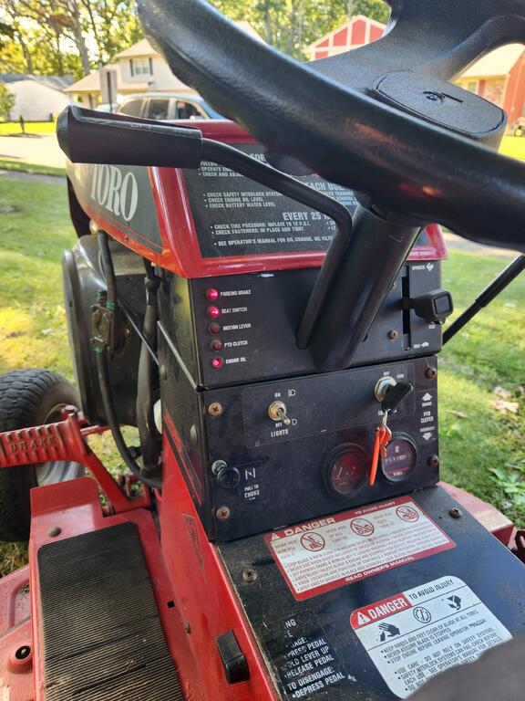

ReelFaster 53 #1 Posted October 8, 2022 Hi folks newer WH owner here, been going well since I bought her a few months back. Was pulling my firewood trailer around to the garage to load up some barn doors I built to haul around back. Left the tractor running and started loading the barn doors into the trailer when it suddenly died. Had it running earlier that day with no issues. Finished loading and tried to restart and the engine oil light just keeps blinking. Oil is clean and full, engine kicks over everything electrical works but just won't start. Couldn't have happen at a worse possible time, stuck on the lawn with two 60"x94" barn doors and a trailer attached to it. Any idea's what to look for? Just sold my craftsman riding mower I used to use to do this, Dang it! 1 Share this post Link to post Share on other sites
Bill D 3,193 #2 Posted October 8, 2022 Welcome. That light is flashing because the engine is not running and making oil pressure. Check for melted fuses in the fuse holder. Check the 9 pin connector between the engine wiring harness and tractor wiring harness for burnt pins and signs of overheating. If you have a jumper with small alligator clips, you can jump from the positive terminal on the battery to the positive terminal on the coil and see if it starts. If it starts, check the items above, also check the connections on the PTO safety switches and seat safety switch. If you post a picture of the model and serial number @gwest_ca can provide you with a wiring diagram for your machine. 3 Share this post Link to post Share on other sites
gwest_ca-(File Mod) 12,533 #3 Posted October 8, 2022 Download this file. Each major circuit has it's own diagram making it easier to follow Warning - the wire colors between the engine connector and the engine may not be correct. 2 Share this post Link to post Share on other sites
ReelFaster 53 #4 Posted October 8, 2022 Just want to say thank you for the replies first and foremost. What I am about to say is extremely embarrassing and if the moderators feel compelled to ban me or suspend me for a period of time I would completely agree. It had no gas! There I said it, my apologies to all, didn't mean to panic and run asking for help. I tend to do that when I don't know much about something. I am not the best with small engines, I know very basics but always eager to learn and learned much over the years to folks like yourselves on this forum. To my very small defense, rough busy day, lots of things going on and then got to building to those barn doors, they took a lot of out of me and were pretty heavy to move. Also was sick with Covid this past week so not 100% just yet. Swore I put gas in the WH just a week or so ago, but I think she drinks a lot more gas then my Craftsman did and I am learning that the hard way today. Again thanks for the quick replies and awesome info, I think I'll go lick my wounds! Thanks again to all! 2 8 Share this post Link to post Share on other sites
