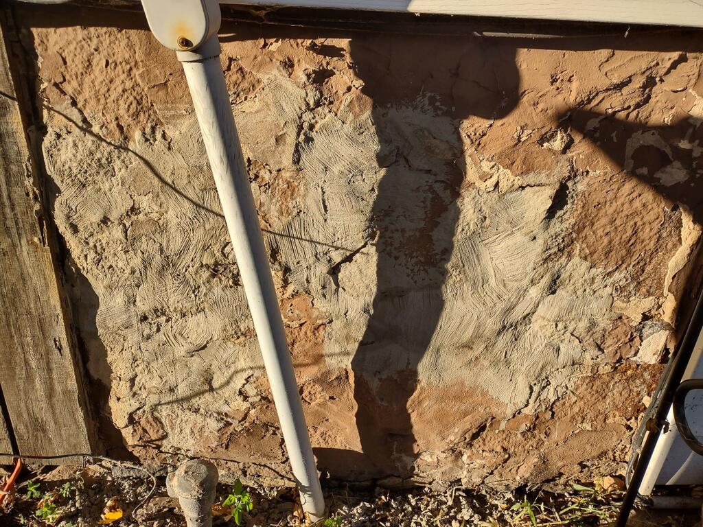

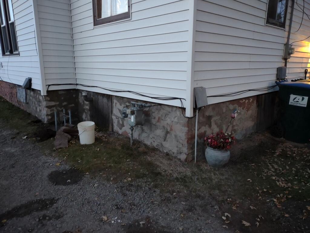

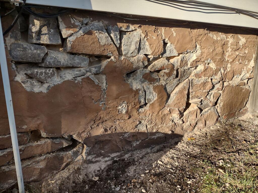

Achto 31,133 #1 Posted October 7, 2022 Today on "This Old Corn Crib" I'm doing some repairs on my basement walls and I gotta admit that I am out of my realm but I think that I'm goin' about it the right way. I'm digging out all of the loose mortar to at least a depth of 2" and using a type S mortar with an adhesion promoter in place of water for the mud mix. Not a fun job but is gotta be done. I am very open to any advise from those who know more on this subject. Here is a pic of one wall that I have dug out. Still need to pressure wash this wall before mudding it back up again. One short wall that I have already repaired. Needs a little touch up yet. 6 Share this post Link to post Share on other sites

stevasaurus 23,627 #7 Posted October 7, 2022 An air chisel would make short (more fun) work out of loose mortar. 3 1 Share this post Link to post Share on other sites
stevebo-(Moderator) 8,604 #8 Posted October 7, 2022 You need to wait for a period for all moisture to dry out and then you should use a masonry sealer on it. 1 1 Share this post Link to post Share on other sites
Lane Ranger 11,822 #9 Posted October 7, 2022 Dan: One thing I would recommend in additiona to spraying on or brushing on a sealer before doing the motar is to get a motar additive that resists water and water absortion since you are doing this on ground level application. Something like this. https://www.kryton.com/products/krystol-mortar-admixture-kma/#:~:text=Krystol Mortar Admixture™ (KMA) Krystol Mortar Admixture (KMA),by reducing permeability and absorption of the mortar. I used something about ten years ago on my old house (maybe 15 years now) that had similar properties as this. You can see the water bead up after motoar dries. Most of these products can just be added to the motar mixture. 1 Share this post Link to post Share on other sites
Achto 31,133 #10 Posted October 7, 2022 (edited) 17 minutes ago, Lane Ranger said: in additiona to spraying on or brushing on a sealer before doing the motar is to get a motar additive that resists water and water absortion This is the adhesion promoter that I am currently using. https://www.amazon.com/SIKA-Corporation-187782-Concrete-Fortifier/dp/B000RUMZ6K/ref=asc_df_B000RUMZ6K/?tag=hyprod-20&linkCode=df0&hvadid=167152358566&hvpos=&hvnetw=g&hvrand=12109510134515856116&hvpone=&hvptwo=&hvqmt=&hvdev=c&hvdvcmdl=&hvlocint=&hvlocphy=1028137&hvtargid=pla-305060479619&th=1 Not sure if I can add a sealer in the mix along with it. I will contact Kryton for some advice, Thanks Edited October 7, 2022 by Achto Share this post Link to post Share on other sites
Achto 31,133 #11 Posted October 10, 2022 I'm about 24hrs and a little over 240lbs of mortar mix into this job. I'm learning as I go but there is one very important piece of advise that I have learned. If you need to do a job like this, call "The Guy". There is a reason why mason's get paid what they do. This job sucks!! Making progress though. 7 1 1 Share this post Link to post Share on other sites

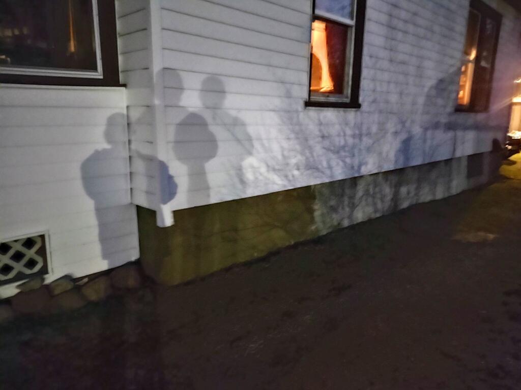

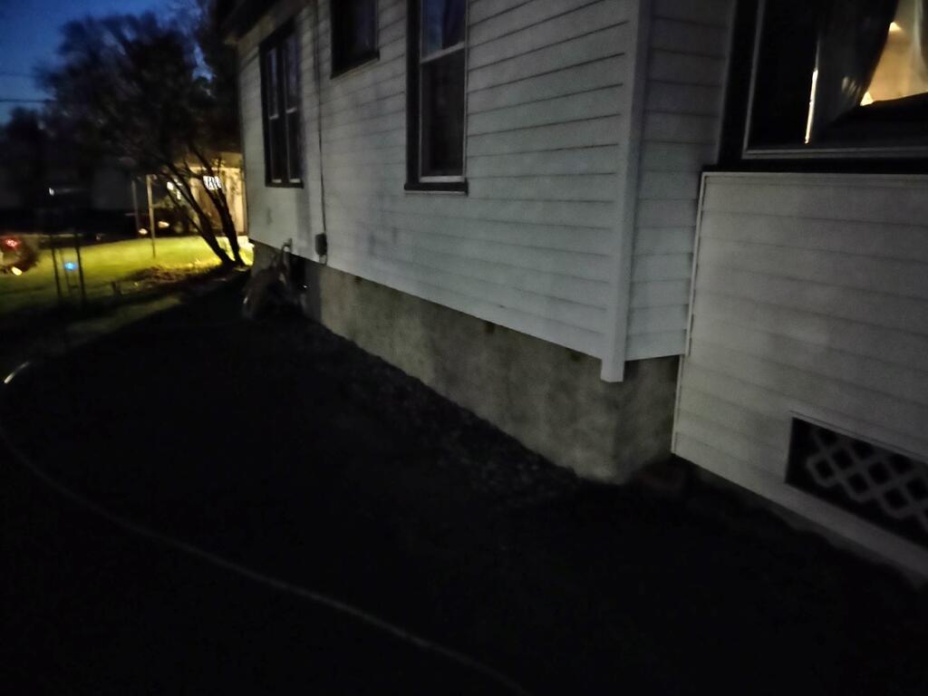

Achto 31,133 #12 Posted November 9, 2022 (edited) @953 nut Unlike the TV shows that make our wives think that you can build a house in one 1/2 hour episode. Well, here we are 1 month later. Weather permitting, this job has consumed most of my after work & weekend life. Warm weather last week allowed me to finish up the East side of the house. Tonight finally put the finishing touches on the West side of the house, by candle light. Out side of the house is done. Finally!!! Edited November 9, 2022 by Achto 2 1 Share this post Link to post Share on other sites
