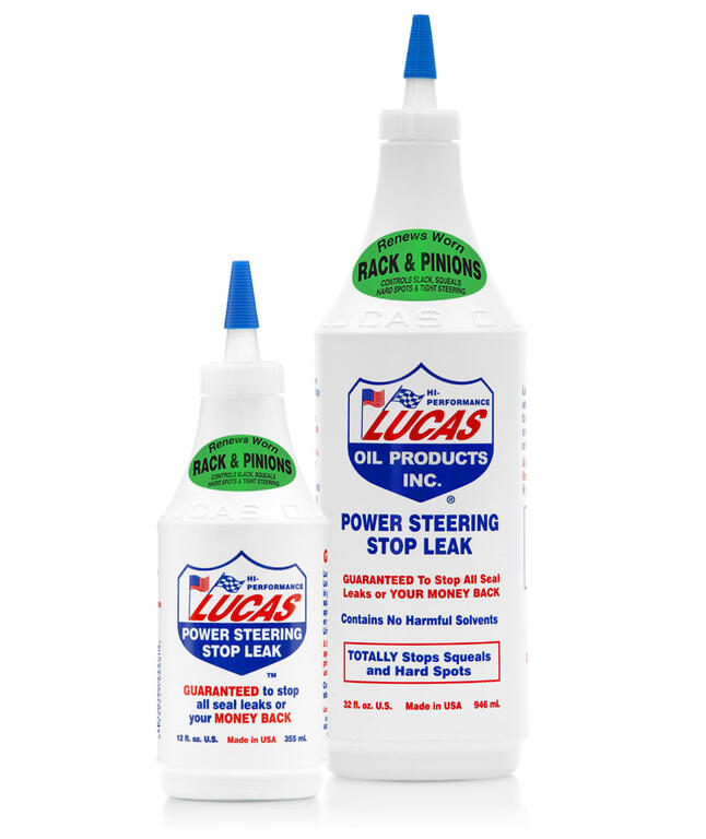

WHX?? 58,303 #4 Posted October 2, 2022 (edited) Power steering rams peed out fluid regularly out of the cylinder seals on the Massey MF-40. Mike Rowe would have liked to film a dirty job on rebuilding them. Selling the tractor but dumped a half a small bottle of Lucas power steering stop leak in just for Ss & Grins and they stopped leaking. Well bottle says money back guarantee. Guess I'm a believer. Who knew they also have fishing reel lube. What say you greasy Pete? @peter lena Edited October 2, 2022 by WHX?? 1 Share this post Link to post Share on other sites
wallfish 20,664 #5 Posted October 2, 2022 I'm guessing they just put some DOT 3 Brake fluid in some oil and sell it as stop leak. The DOT 3 brake fluid (Not Synthetic stuff) will the swell certain types of seals. I use brake fluid on old 2 stroke NLA case seals to swell them in place. Works pretty good but it won't fix any dry rotted or damaged seals or if a bearing is shot. Old mechanics used that stuff like Franks Red Hot sauce. 3 Share this post Link to post Share on other sites

andyk 83 #9 Posted October 3, 2022 23 hours ago, WHX?? said: Power steering rams peed out fluid regularly out of the cylinder seals on the Massey MF-40. Mike Rowe would have liked to film a dirty job on rebuilding them. Selling the tractor but dumped a half a small bottle of Lucas power steering stop leak in just for Ss & Grins and they stopped leaking. Well bottle says money back guarantee. Guess I'm a believer. Who knew they also have fishing reel lube. What say you greasy Pete? @peter lena I used this on a Dodge Pickup steering box. Slowed down the leak enough to pass the state inspection. Share this post Link to post Share on other sites
