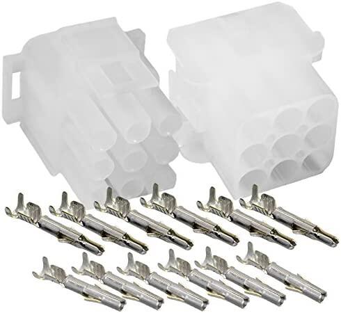

RED-Z06 2,718 #3 Posted September 27, 2022 24 minutes ago, RED-Z06 said: On my 93 416 the plastic plug that connects the engine to the harness has melted pins and now it randomly dies or won't start without fiddling with it. Short of individually pairing each plug or doing multiple 2pin Waterpak connects...is there a replacement with pins? Sounds right. I ordered a thing called a molex connector this morning but i dont know if it fits Share this post Link to post Share on other sites

RED-Z06 2,718 #5 Posted September 28, 2022 This is what i ordered...hard to tell what mine used to look like Share this post Link to post Share on other sites
WHX?? 57,641 #6 Posted September 28, 2022 That will work. Share this post Link to post Share on other sites
