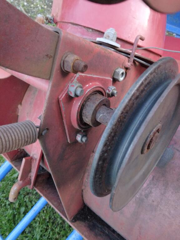

matt monte 232 #1 Posted September 27, 2022 did a search, didn't find anything. gonna start messing with this next week, picked it up for my 312-8. 1st off i noticed slop in this bearing. Not sure pn. is there any manual on how to replace? the sticker is very worn-out so im at a loss on how to correctly identify Share this post Link to post Share on other sites

Blasterdad 3,168 #4 Posted September 27, 2022 Tractor Supply usually stocks them, on shelf item, just bring old one with you & compare. Share this post Link to post Share on other sites
Pullstart 71,366 #5 Posted September 27, 2022 If you pul the pulley off the shaft, that bearing should be able to follow. Share this post Link to post Share on other sites
peter lena 10,090 #7 Posted September 27, 2022 @matt monte do yourself a favor , look up flange bearings , for a probable match up , with that solid base go to , you might even switch to a 4 bolt flange , critical to this is hi temp grease lubrication at every movement point . lucas red / or prefered green grease . make every rotating point easy / smooth to function , also detail in your chain drive auger set up , use specific , chain / cable lubricant , never let it dry out / rust , my 36x42 single stage spins up by hand , 12 hp runs that without effort , pete Share this post Link to post Share on other sites
gwest_ca-(File Mod) 12,510 #8 Posted September 27, 2022 I recall there being a problem finding a bearing with the correct OD and ID. The 3/4" ID bearings usually have a 7/8" OD. What they were doing is using the 7/8" ID bearing with a 7/8" x 3/4" bushing to fit the 3/4" shaft. 1 Share this post Link to post Share on other sites

lynnmor 9,051 #10 Posted September 27, 2022 43 minutes ago, peter lena said: @matt monte critical to this is hi temp grease lubrication at every movement point . lucas red / or prefered green grease Since a snowblower operates in a cold environment with plenty of water and ice, I would think that a marine grease would be the best choice if one wants to open a sealed bearing for grease replacement. 1 Share this post Link to post Share on other sites

peter lena 10,090 #12 Posted September 27, 2022 @matt monte agree with the marine grease , also has a very extended range of protection. temp amd durability , those needle point grease tips , are also very good in tight spots . when I fist installed my snowblower years ago , used , neglected . was amazed that it worked at all , their was so much collective drag on it . just broke it down for function , kept gaining on it , up for sale now , it easily spins by hand , no screaming shuddering attempt to function , it just works like it should , done that on all my related problems , go grease , pete Share this post Link to post Share on other sites
matt monte 232 #13 Posted September 27, 2022 thanks for all the responses. im gonna mock it up 1st then i will attempt to run it. ill post a better pic, using list i was able to figure out missing digit. 0642ST04. Share this post Link to post Share on other sites
