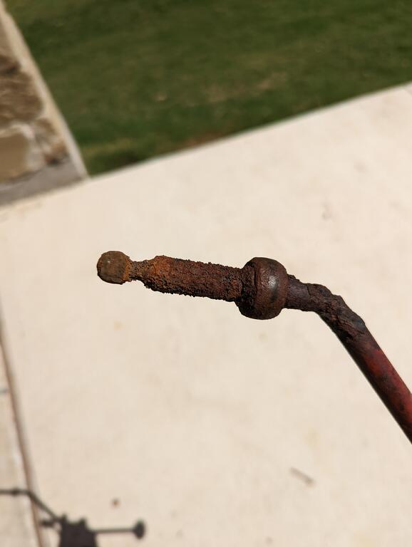

Jimmy66 47 #1 Posted September 25, 2022 My 606 shifter wasn't in bad shape till I flushed the trans with diesel, them the shifter knob that extends below the dogpoint screw got all crystalized with rust. I buffed it and coated it with grease. My Raider 12 I just got, was abandoned outside, and the shifter is pretty et up. Wondering what the best way to fix and prevent this is, and if it is even worth saving 3 Share this post Link to post Share on other sites
wallfish 20,387 #2 Posted September 25, 2022 Wire brush all that rust off and it should be fine. The rust rot might have compromised the bend but it's hard to tell from the rust and just a pic. If it fails replace it or weld it Moisture evaporates from the warm oil and attacks the upper parts in the trans. Pretty common to see shifters covered with rust on old tractors. Coat'm in grease like you did already. 3 1 1 Share this post Link to post Share on other sites

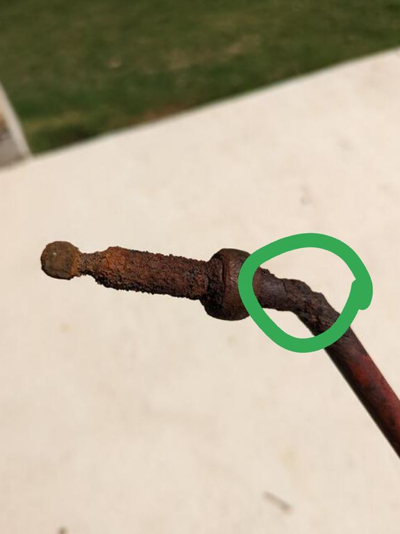

rmaynard 17,495 #3 Posted September 25, 2022 What I'd be concerned about is this area. Is it my imagination or that rusted pretty bad at the bend? 3 Share this post Link to post Share on other sites
Jimmy66 47 #4 Posted September 25, 2022 Yeah it's got a bit missing there I'll get it welded. No urgent need as of yet I'm gonna have to crack into the trans. It won't shift...part of me was hoping it was due to poor set screw adjustment. Would like to fill her up with evaporust and then kerosene to see if anything loosens up. I never opened up a trans before, but I have a Craftsman with a seized Dana to practice on before I get onto the raider 12 1 Share this post Link to post Share on other sites
