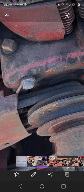

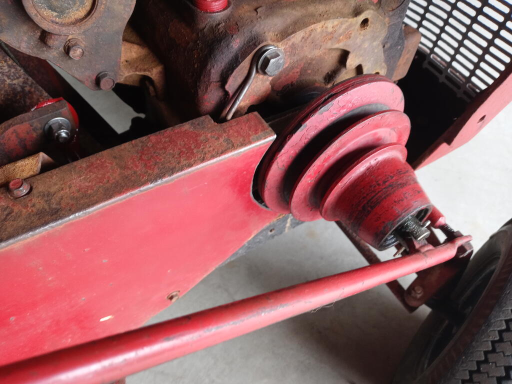

marreque 218 #91 Posted June 1, 2023 I know that there isn't a guard on the PTO. When I slide the PTO onto the crank shaft it hits the belt guard that's on the rig now. My question was is there 2 different styles of guards? 1 Share this post Link to post Share on other sites
marreque 218 #92 Posted June 1, 2023 This is the difference im talking about. 1 Share this post Link to post Share on other sites
oliver2-44 11,718 #93 Posted June 1, 2023 (edited) If I remember correctly there are a couple of sizes of PTO,s. and the older ones are a slightly smaller diameter. One of the pros will be along to confirm that. Are you sure that PTO is the original one for that tractor Edited June 1, 2023 by oliver2-44 1 Share this post Link to post Share on other sites
marreque 218 #94 Posted June 1, 2023 I know that there isn't a guard on the PTO. When I slide the PTO onto the crank shaft it hits the belt guard that's on the rig now. My question was is there 2 different styles of guards? 1 Share this post Link to post Share on other sites
marreque 218 #95 Posted June 1, 2023 Not original to the machine but was "supposed" to be from a 1054. 2 Share this post Link to post Share on other sites

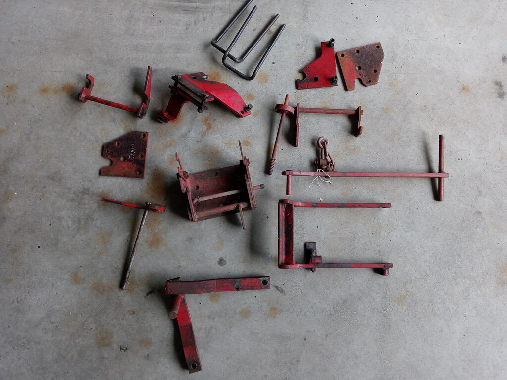

marreque 218 #96 Posted June 1, 2023 So were all the mower deck brackets but that's to be determined. I'll have to lay them out on the table and send a few pics for the experts to look at. 1 Share this post Link to post Share on other sites
marreque 218 #97 Posted June 4, 2023 Belt guard issue solved.. 2 Share this post Link to post Share on other sites

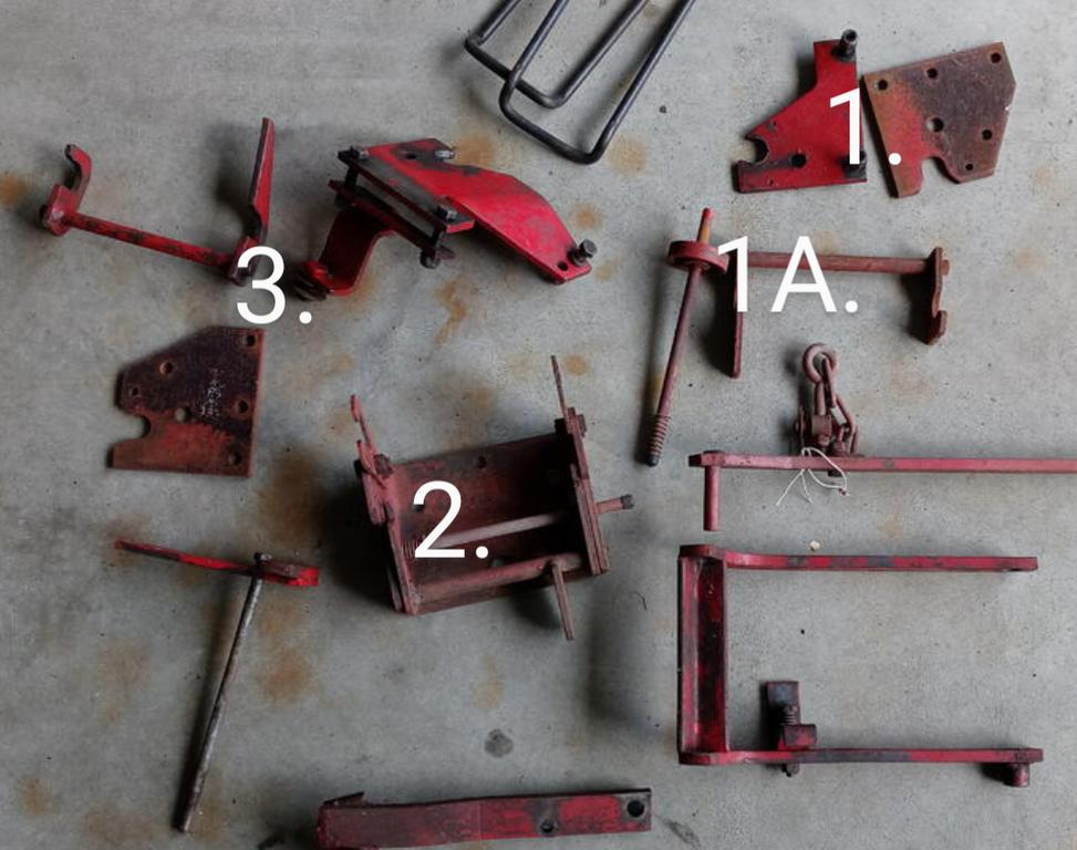

marreque 218 #98 Posted June 4, 2023 If anyone could help with these brackets, as to what they are for. I believe there is a attach a matic in there but how about the rest? Thank you! 1 Share this post Link to post Share on other sites
ebinmaine 80,477 #99 Posted June 4, 2023 1 hour ago, marreque said: If anyone could help with these brackets, as to what they are for. I believe there is a attach a matic in there but how about the rest? Thank you! 1. 1A, are mid hitch pieces that'll work on mid-60s short frame Wheelhorse. 2. Front attach-o-matic (with an added piece at the top??) 3. Clearly another mid hitch. I'm not familiar with the design. The piece just below 1A appears to be the link that goes from the back of the frame down to a mower (or other implements?) Share this post Link to post Share on other sites
Pullstart 71,172 #100 Posted June 5, 2023 Please don’t take this the wrong way… because it looks great and is plenty functional! It’s too late now, but I’m pretty sure the belt guard should go behind the PTO setup. The crank sleeve and backing disc mount should have a set screw to hold it to the crank, not just against the drive belt pulley. As for the mule drive sets you have, set number 3 that EB labeled is correct for this tractor. The others don’t apply. Share this post Link to post Share on other sites
