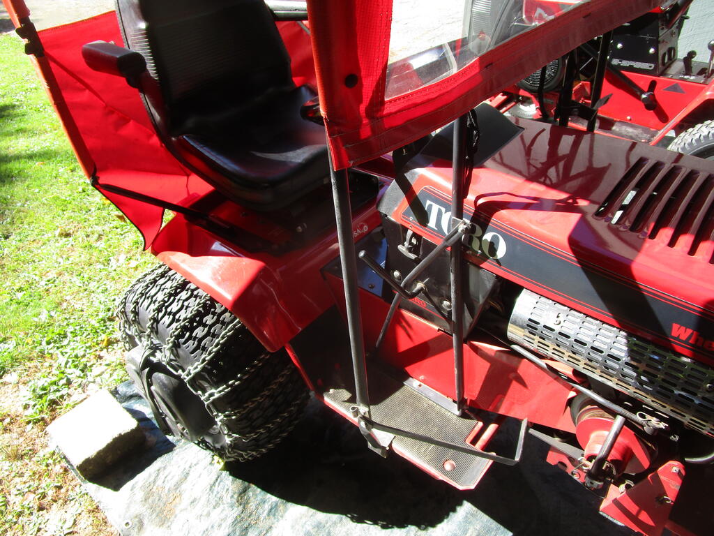

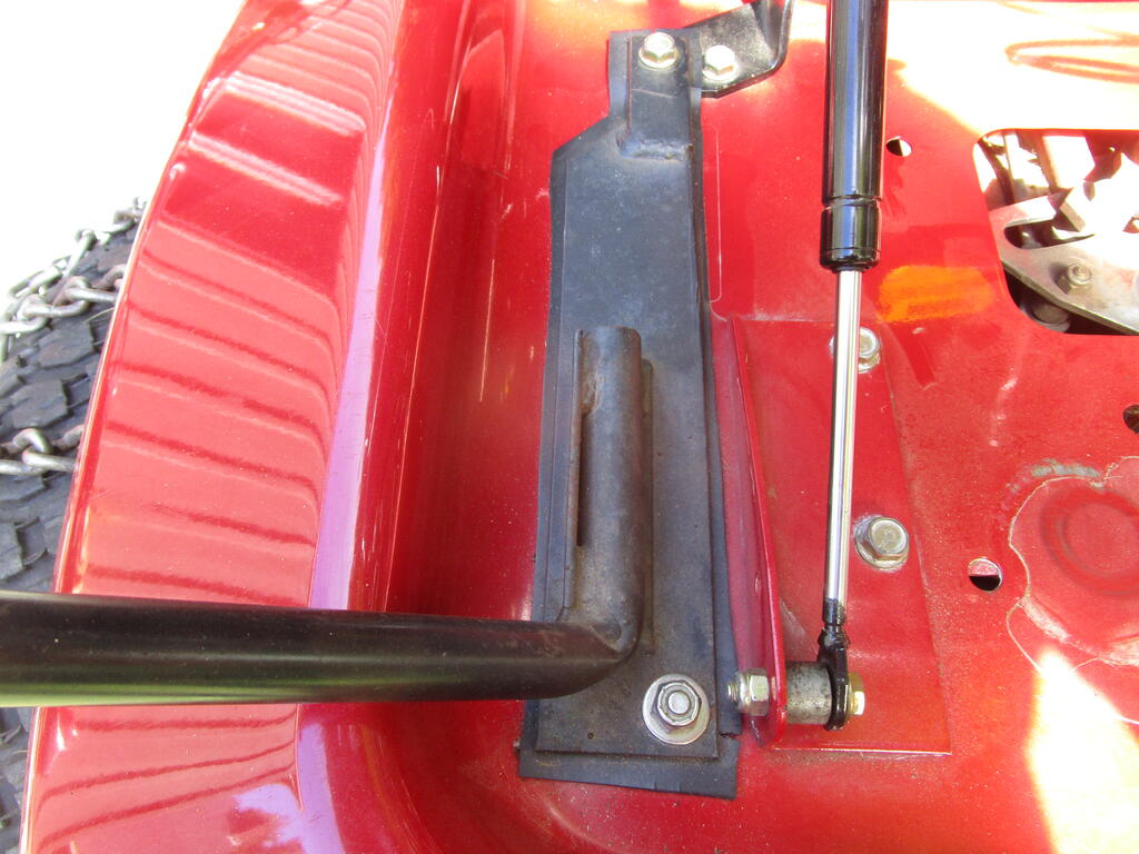

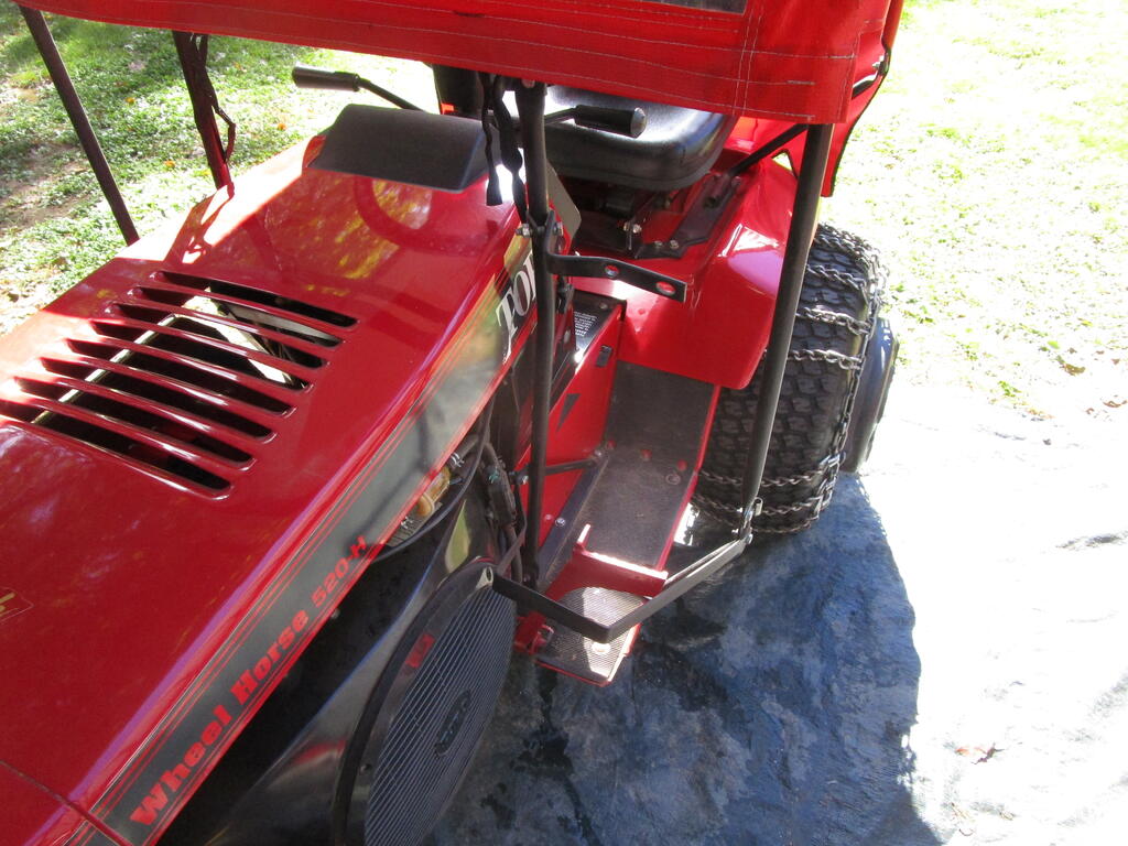

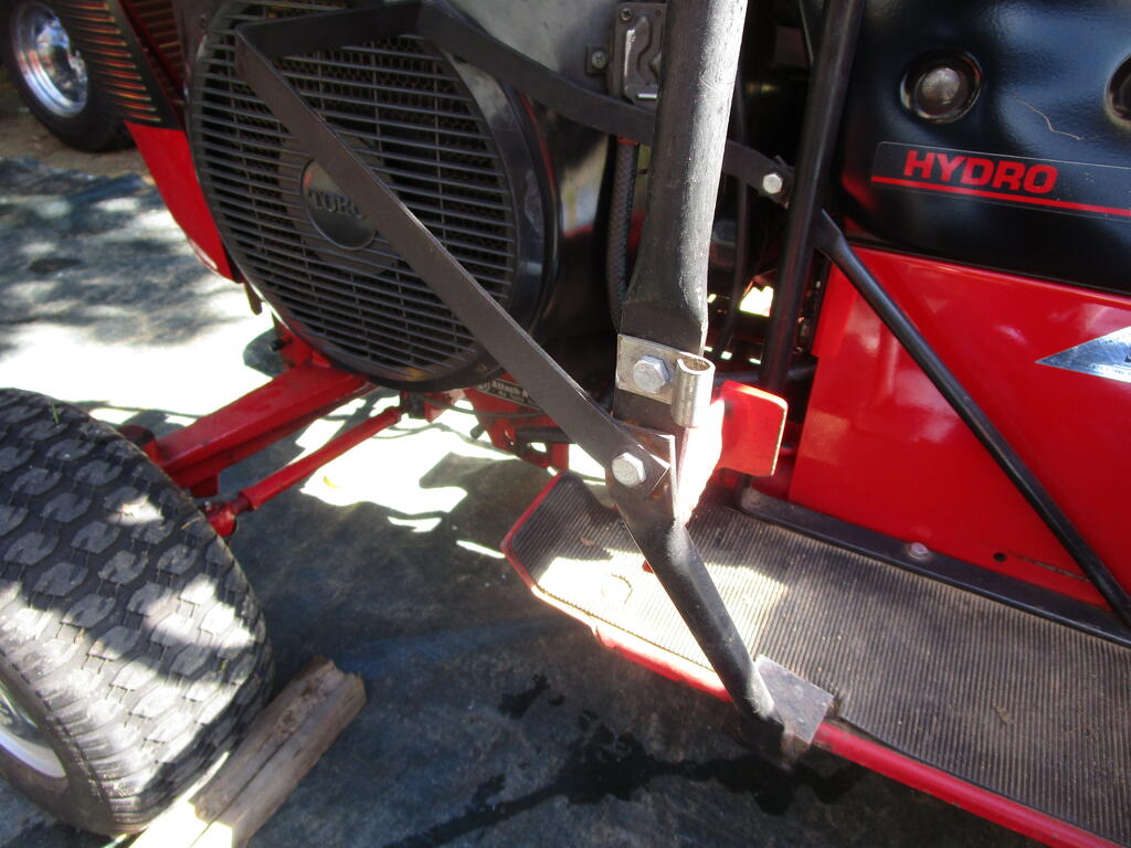

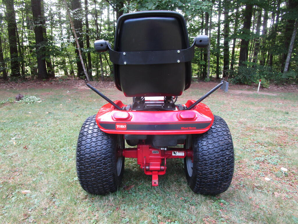

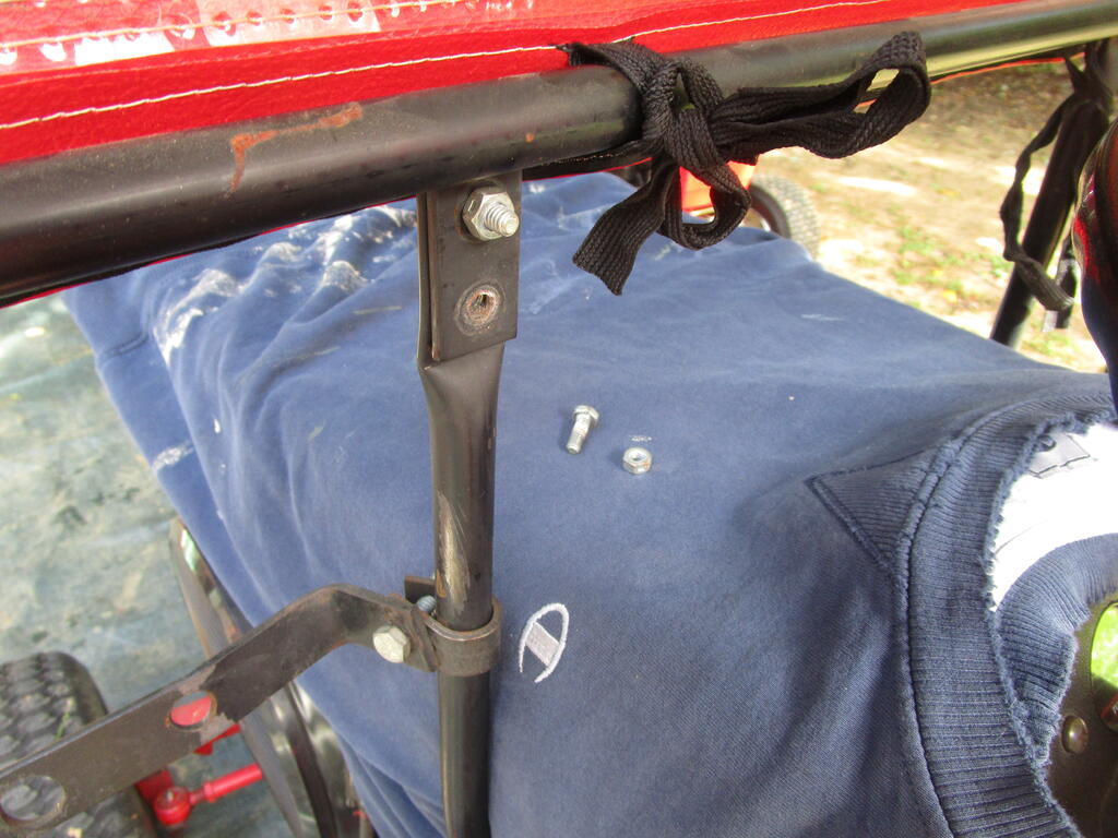

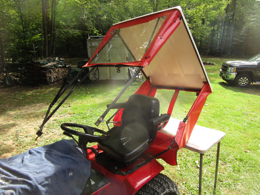

JCM 11,395 #7 Posted September 23, 2022 Some pictures here may help. Not all that difficult. Just take your time. I made some rubber gaskets to go under the 2 rear brackets on the rear fender to protect the original paint, optional. 2 Share this post Link to post Share on other sites
