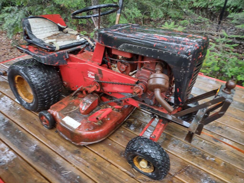

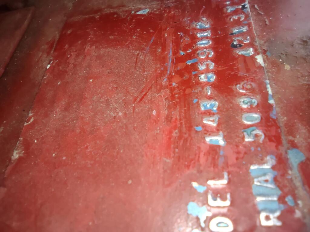

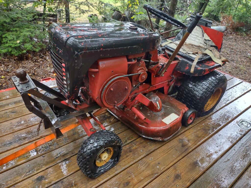

Achto 32,923 #1 Posted September 20, 2022 (edited) I acquired this L106 Right purty, isn't it. Any way, it has had an engine transplant. I have looked around on the net trying to find out what size the engine is and have had no luck. Found 10hp as well as 7hp. Of course some one painted over the engine plate, so this helps me out tremendously. The model number on the engine is 143-659012. Can any one tell me the size of this engine from the model number?? Edited September 20, 2022 by Achto 2 1 1 Share this post Link to post Share on other sites

rmaynard 17,642 #6 Posted September 20, 2022 Tecumseh HH100 143-659012 Craftsman Engine 2 1 Share this post Link to post Share on other sites
WHX?? 58,347 #7 Posted September 20, 2022 Guessing you got the techy manual? Nothing in ther? Bob just nailed it. I that number and came up with the same HH100. Same muff that was on the Sears I sold to Jerimi's kid. 1 Share this post Link to post Share on other sites
EB-80/8inPA 2,129 #8 Posted September 20, 2022 Good luck with that thing! It looks interesting. I’ve never seen one quite like it. 1 Share this post Link to post Share on other sites
rmaynard 17,642 #9 Posted September 20, 2022 1 minute ago, WHX?? said: Bob just nailed it. I Dang you Wisconsin boys! I want people to think I'm smart, but you blew my cover. 6 Share this post Link to post Share on other sites

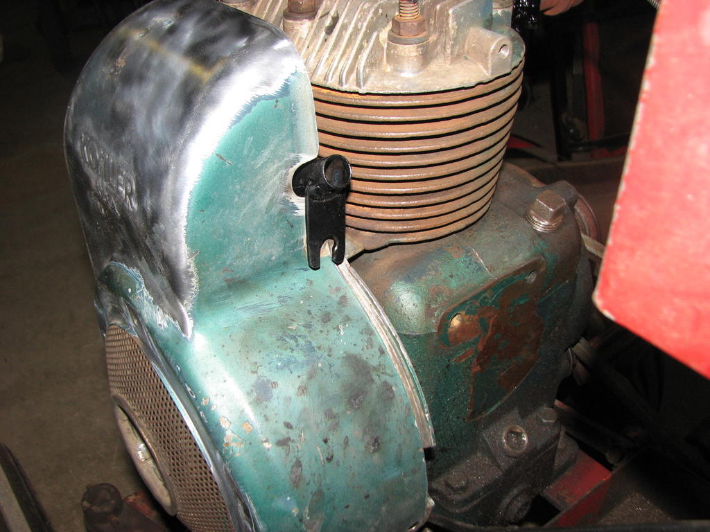

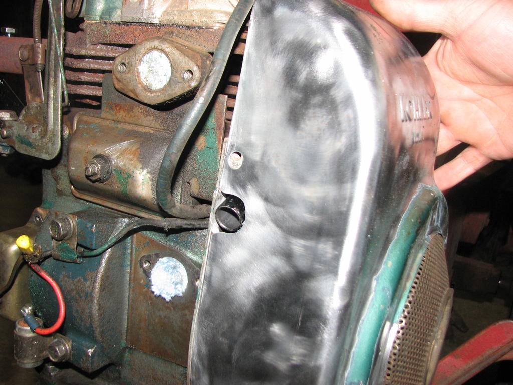

Ed Kennell 47,813 #10 Posted September 20, 2022 Is the fuel line thru the blower shroud unique to Tecky. All mine had that. If so, makes a quick easy way to ID Teckys. 2 Share this post Link to post Share on other sites
WHX?? 58,347 #11 Posted September 20, 2022 Somewhere in this mess of a phone I got pics of the model # on that beast... see if I can find it but pretty sure it started with 143. Share this post Link to post Share on other sites
Achto 32,923 #12 Posted September 20, 2022 (edited) 15 minutes ago, Ed Kennell said: Is the fuel line thru the blower shroud unique to Tecky. They are the only engine that I have seen this done on. Always made me nervous as to how long it would take to vibrate a hole in the fuel line. Edited September 20, 2022 by Achto 1 Share this post Link to post Share on other sites

WHX?? 58,347 #16 Posted September 20, 2022 (edited) Be interesting just to see if it runs?!?! After further review what the heck is that belt on the mower? Edited September 20, 2022 by WHX?? Share this post Link to post Share on other sites
Achto 32,923 #17 Posted September 20, 2022 (edited) 19 minutes ago, WHX?? said: Be interesting just to see if it runs?!?! May be I'll Clean the carb, hook up an IV bottle, an AED & see if there is life in it over the weekend. Edited September 20, 2022 by Achto 2 Share this post Link to post Share on other sites
WHX?? 58,347 #18 Posted September 20, 2022 (edited) 2 minutes ago, Achto said: May be I'll Clean the carb, hook up an IV bottle and an AED & see if there is life there over the weekend. Just for S&Gs...check the oil Ryan. Edited September 20, 2022 by WHX?? 2 Share this post Link to post Share on other sites
ebinmaine 81,139 #19 Posted September 20, 2022 21 minutes ago, WHX?? said: what the heck is that belt on the mower? Engine PTO to mower gear drive box. 18 minutes ago, Achto said: AED I might regret this. What's an AED? 1 Share this post Link to post Share on other sites

Pullstart 71,516 #21 Posted September 20, 2022 41 minutes ago, Ed Kennell said: Is the fuel line thru the blower shroud unique to Tecky. All mine had that. If so, makes a quick easy way to ID Teckys. there’s room behind a Kohler shroud… 3 Share this post Link to post Share on other sites
Achto 32,923 #22 Posted September 20, 2022 (edited) 29 minutes ago, WHX?? said: After further review what the heck is that belt on the mower? Adjustable link drive belt. https://www.grainger.com/product/POWERTWIST-STANDARD-Link-V-Belt-Powertwist-Std-49YL71?opr=IDPPLARECS&analytics=PLAPDP_undefined Edited September 20, 2022 by Achto Share this post Link to post Share on other sites

ebinmaine 81,139 #25 Posted September 20, 2022 1 minute ago, Pullstart said: there’s room behind a Kohler shroud… One of the several 8 HP Kohler engines we've seen here had the old rubber fuel hose go through the shroud kind of at the bottom of the cooling fins. 1 Share this post Link to post Share on other sites
