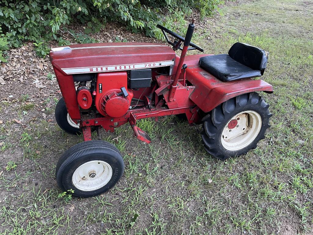

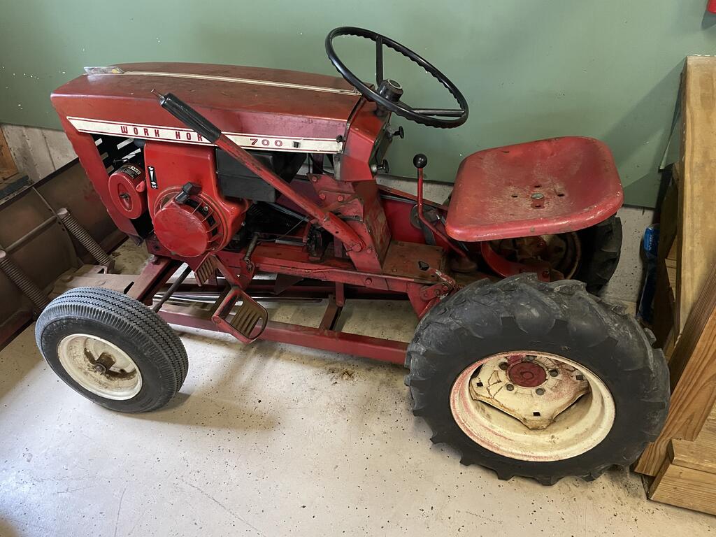

RustyGold 88 #1 Posted September 19, 2022 (edited) Started out with this stock 69 workhorse 700. The existing seat was clunky & had some damage . I set out to make this into a 1045 clone . This is the last year wheelhorse made the short frame. The frame & upper hood stand matches the 1045. I removed the stock flip up seat & lower hood stand . Found a nice wheelhorse metal pan seat at my local flea market . Here’s the Before & after pics …looks beefier than before ! I’m hoping to add the toolbox & fenders from a 702, or 753 . Maybe someday I’ll find the Lower hood stand from a genuine 1045 . Edited September 19, 2022 by RustyGold 8 1 Share this post Link to post Share on other sites

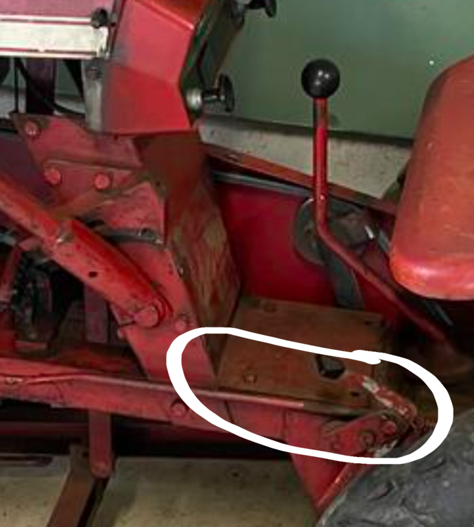

ebinmaine 81,046 #2 Posted September 19, 2022 I like it. We have a seat spring and seat to do similar to one of Trina's mid 60s tractors. Do you find the hood stand to be weak or flexible after having cut off the horizontal section? If I remember correctly there are bolts going through the holes circled in my pic. 2 Share this post Link to post Share on other sites
RustyGold 88 #3 Posted September 19, 2022 (edited) 18 minutes ago, ebinmaine said: I like it. We have a seat spring and seat to do similar to one of Trina's mid 60s tractors. Do you find the hood stand to be weak or flexible after having cut off the horizontal section? If I remember correctly there are bolts going through the holes circled in my pic. I didn’t notice any difference in the upper hood stand . It still feels solid , no difference. The lower center piece I removed only had (4) thin tabs which go thru some slots in the lower hood stand. And yes . There are 4 bolts which hold that lower plate in place on the frame rails . I didn’t finish mounting that one up before I took the pic . One thing to note is that the workhorse 700 shares the same upper hood stand as the 1045 but the 1045 has the 7 slot hood . The Workhorse has 6 slot hood with room for lights !! Edited September 19, 2022 by RustyGold 1 Share this post Link to post Share on other sites

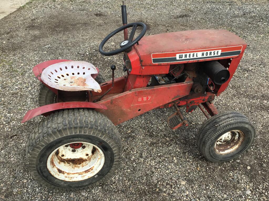

Pullstart 71,482 #10 Posted September 20, 2022 2 minutes ago, RustyGold said: Thanks man. I’m planning to add the shifter box & toolbox /fenders but they are hard to find . Hopefully they come up for sale sometime ! Here’s our project mock 1045 on my daughter Jada’s 857: https://www.wheelhorseforum.com/topic/75987-and-now-on-to-the-last-haul-of-the-big-show-jadas-barney-fife/?page=2 4 Share this post Link to post Share on other sites
RustyGold 88 #11 Posted September 20, 2022 7 hours ago, Pullstart said: Here’s our project mock 1045 on my daughter Jada’s 857: https://www.wheelhorseforum.com/topic/75987-and-now-on-to-the-last-haul-of-the-big-show-jadas-barney-fife/?page=2 nice job ! What model did you get the lower hood stand / shifter surround from ? Share this post Link to post Share on other sites
Pullstart 71,482 #12 Posted September 20, 2022 1 hour ago, RustyGold said: nice job ! What model did you get the lower hood stand / shifter surround from ? Thanks, we had fun having a daddy/daughter project out of it! We used the box from a 753. I believe any 62-64 round hood will work. 1 Share this post Link to post Share on other sites
