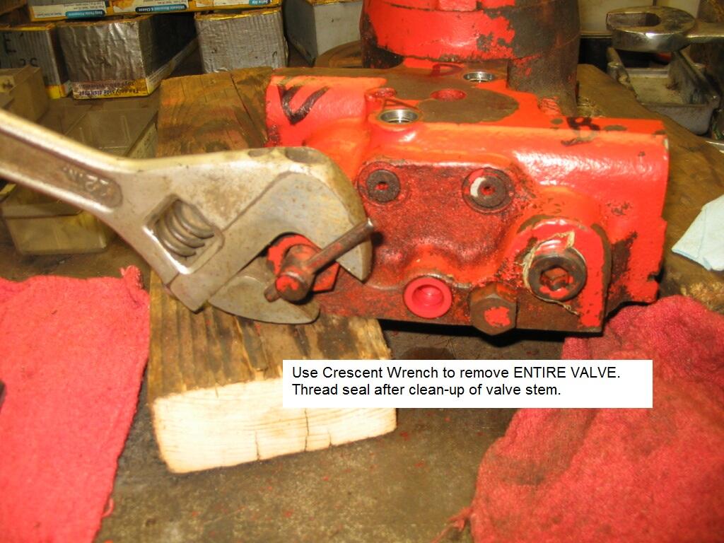

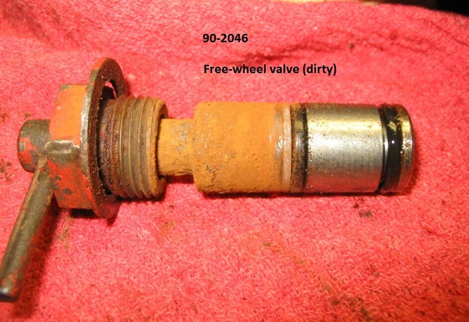

daveoman1966 3,884 #3 Posted September 19, 2022 Put a big crescent wrench on it and take out the entire valve. Clean out the rust and refit, with new O-ring...if needed. Put anti-sieze on threads and moving parts...NOT on the O-ring surface though. 2 2 1 Share this post Link to post Share on other sites

C.Lawles 5 #10 Posted September 19, 2022 Well after letting the blaster soak over night, I was able to get valve to finally turn and pull out. Cleaned it up and now works great. Thanks guys!! 3 1 Share this post Link to post Share on other sites
