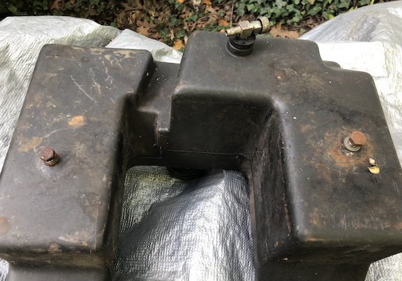

Handy Don 17,735 #38 Posted October 19, 2022 (edited) And don't forget that on several models there are two bolts into the bottom of the tank (this tank is from a 518-H) holding the tank to the bracket Edited October 19, 2022 by Handy Don 2 1 Share this post Link to post Share on other sites

lynnmor 9,081 #42 Posted October 19, 2022 2 minutes ago, ebinmaine said: Lucky for me this particular tractor is an 8-speed so I don't have that wonderful source of irritation. I've got at least one extra spare fuel tank that fits these tractors but if I wanted to try to clean the inside of this one how might I go about doing that? Handful of small rocks and shake it to death? I find a lot of debris caked around the gas tank from mowing or leaf cleanup. If left in place, winter duty will keep that mess wet causing rust. I like to do a complete seat, fender and tank removal at winter changeover. To clean a dirty tank, just toss a handful of clean nuts with some soapy water inside and find someone in the household that wants to play catch. 2 Share this post Link to post Share on other sites
Handy Don 17,735 #43 Posted October 19, 2022 54 minutes ago, lynnmor said: I find a lot of debris caked around the gas tank from mowing or leaf cleanup. If left in place, winter duty will keep that mess wet causing rust. I like to do a complete seat, fender and tank removal at winter changeover. To clean a dirty tank, just toss a handful of clean nuts with some soapy water inside and find someone in the household that wants to play catch. Avoiding sharp edges on whatever you use is a good idea to lessen the chances of creating scratches in the plastic. I used a bag of glass marbles which I knew wouldn't reach into the smallest corners but my tank wasn't that dirty that I worried about it. (Also, if you have a fuel level sender in the tank, get that out before cleaning!) 1 hour ago, lynnmor said: Don't you just love how they managed to put one bolt directly over the hydraulic filter? Yeah, and there isn't room for it to come out even once its loose. Getting it restarted is so tedious -- probably took me 5 mins. Like @ebinmaine suggests, that likely won't get done again until I'm changing the filter. 2 Share this post Link to post Share on other sites
