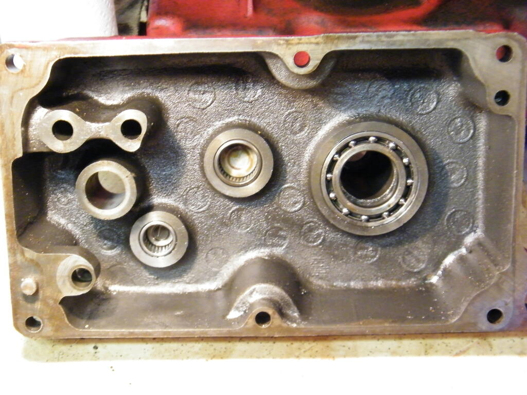

stevasaurus 23,738 #7 Posted September 17, 2022 (edited) If you look at these two pictures, the halves are sitting like they would in your tractor. The 1st picture is the right side and at the far left in the middle is the input shaft hole. The top 2 holes are for your shift rails and the bottom hole is for your cluster gear shaft. What spins in neutral (with the clutch out)...the input shaft, the spline shaft and the cluster gear shaft. That is enough to keep the trans bearings lubed, but only the cluster gear shaft, the bottom of the mushroom gear and the lower part of the differential are in the oil. In the second picture, the left side of the transmission, notice the small indentation at 7 o'clock of the 1533 differential carriage bearing. That is your fill plug and that is where the oil level should be. As you can see, the input bearings are above the oil level, but with those shafts turning when ever the clutch is out, the bearings stay well lubed. Know that these transmissions throw the oil all over the gears and bearings, if you over fill the trans with oil, the gears cannot throw the oil like it should. Edited September 17, 2022 by stevasaurus 1 3 Share this post Link to post Share on other sites
