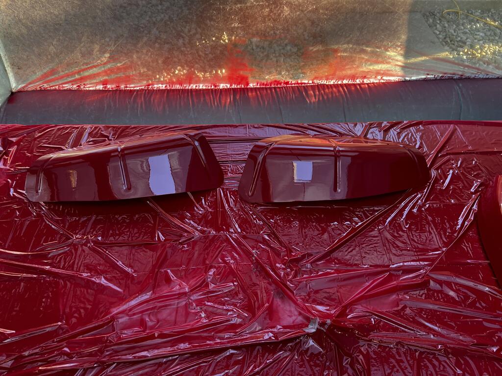

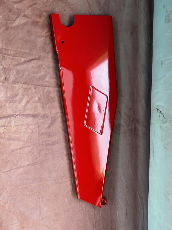

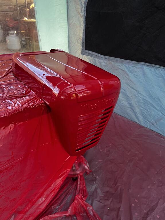

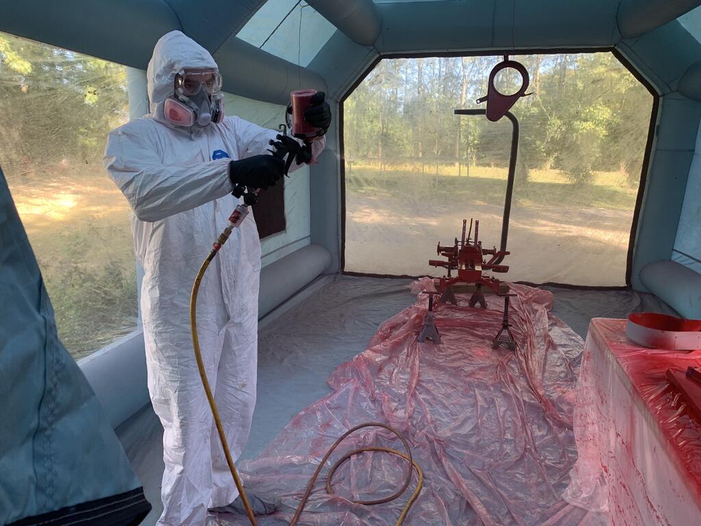

WH1618speed 543 #26 Posted October 6, 2022 Hey everyone! I got my painting done today. Have been waiting for a warm enough day but today was perfect. I was pretty happy with the paint. Now to let it cure for a week and put 'er back together with decals and such. All the prep work paid off. I used Toro red from toro. The paint is older than I am lol. Also a perfect project to test out the new paint booth and 3M paint gun. 2 2 2 Share this post Link to post Share on other sites
WH1618speed 543 #28 Posted October 6, 2022 Lighting is off here. Looks darker than in person. 1 1 1 1 Share this post Link to post Share on other sites
WHX?? 56,833 #32 Posted October 6, 2022 This guy has been snowing us fellas he's a pro! 2 1 3 Share this post Link to post Share on other sites

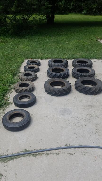

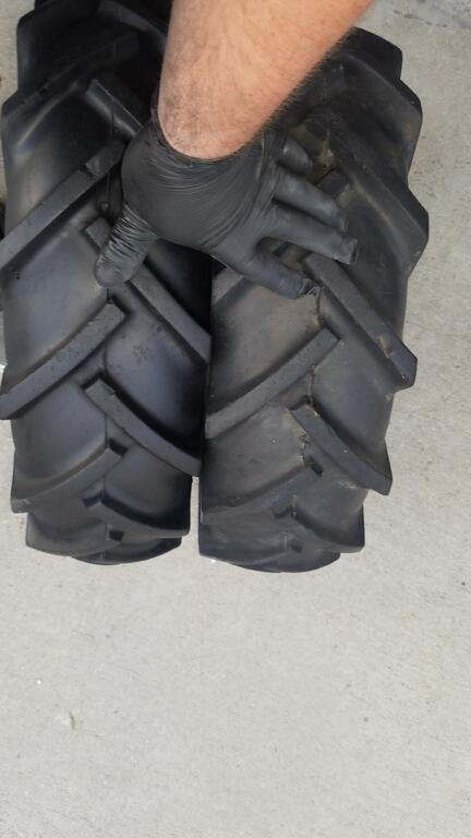

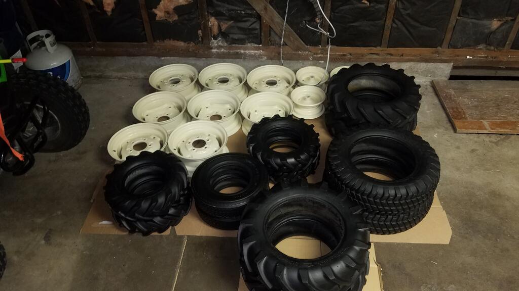

DBlackston 333 #33 Posted October 9, 2022 (edited) On 9/15/2022 at 2:27 PM, WH1618speed said: Per recommendations on this site I used Bleche White Tire Cleaner and then instead of the Miller Tire Paint I used AA Stealth Tire paint. Both products worked wonderfully. Here are some before and afters of the Bleche White. I just dumped the tires in a wheel barrow and poured in about 1/4 of the bottle of bleche white. I scrubbed them with a stiff nylon brush then rinsed off. That small amount of the cleaner did a lot of tires! Heres a before and after of a set of tires with the cleaner. Here is a before and after cleaning and painting to an original tire in the same condition that hasn't been cleaned or painted. Here is a comparison of just a cleaned tire and a painted tire. I used just a few ounces of the 128 ounces of paint. It was diluted very heavily probably 1:5 to spray in a gun. I am certain that this one gallon would do every tire I will ever own in my lifetime. It was very easy to apply too, and unlike paint even when it was literally dripping off the tire it left no runs or discoloring. Here they are all painted and ready to mount. On 10/5/2022 at 7:57 PM, WH1618speed said: On 10/5/2022 at 7:57 PM, WH1618speed said: This inflatable paint booth is the bees knees! I will have to keep that in the back of my mind. Edited October 9, 2022 by DBlackston 6 2 1 Share this post Link to post Share on other sites

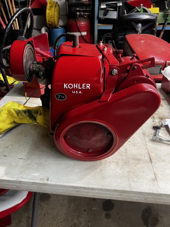

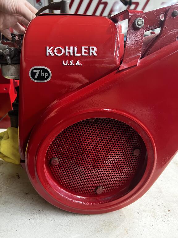

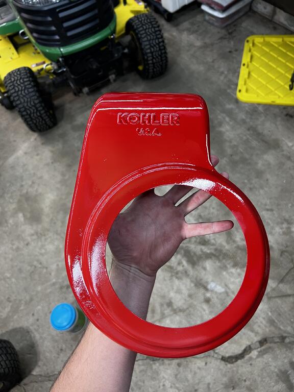

WH1618speed 543 #34 Posted October 10, 2022 Got some motor assembly done! Looks pretty sweet! 2 5 1 Share this post Link to post Share on other sites
WH1618speed 543 #35 Posted October 10, 2022 (edited) the die cut letters from @Vinylguy are awesome! Edited October 10, 2022 by WH1618speed 3 2 Share this post Link to post Share on other sites

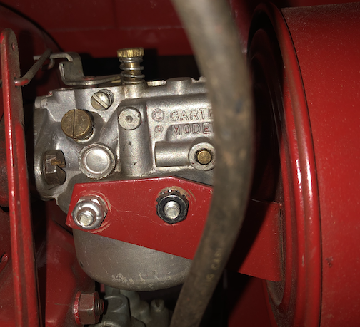

WHX?? 56,833 #36 Posted October 10, 2022 Something looks funky with the air cleaner guy ... upside down? 2 Share this post Link to post Share on other sites
WH1618speed 543 #37 Posted October 10, 2022 10 minutes ago, WHX?? said: Something looks funky with the air cleaner guy ... upside down? It may be… I will check on my 854 to see. 3 Share this post Link to post Share on other sites
WH1618speed 543 #38 Posted October 11, 2022 It is the same orientation as the 854 and I've got a pic of it before restoration its the same way. 1 Share this post Link to post Share on other sites
WHX?? 56,833 #39 Posted October 11, 2022 Good ... it just looked weird .. just the pic I guess. 1 Share this post Link to post Share on other sites

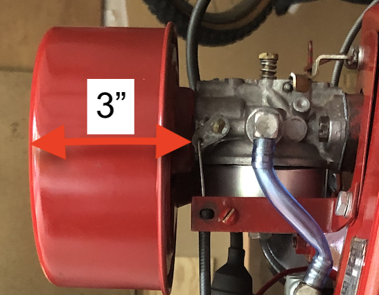

Handy Don 16,745 #40 Posted October 11, 2022 11 hours ago, WH1618speed said: It is the same orientation as the 854 and I've got a pic of it before restoration its the same way. The K181s I've seen on 854s have all had a larger dry-type air cleaner vs. the one used on the K161--the larger displacement needing more airflow to breath properly. It measures ~3" from carb face to the front of the outer housing. BTW, it's this extra length that causes the 854 to need a longer hood than its 703 predecessor! Also, the K181 air cleaner can only be mounted one way because its base has a bracket secured to threaded holes in the side of the carb body. (Note: the threaded holes on the otherwise excellent carb pictured here were damaged when it came to me so I used JB Weld to convert the holes to studs for holding the air cleaner base bracket.) 1 1 Share this post Link to post Share on other sites

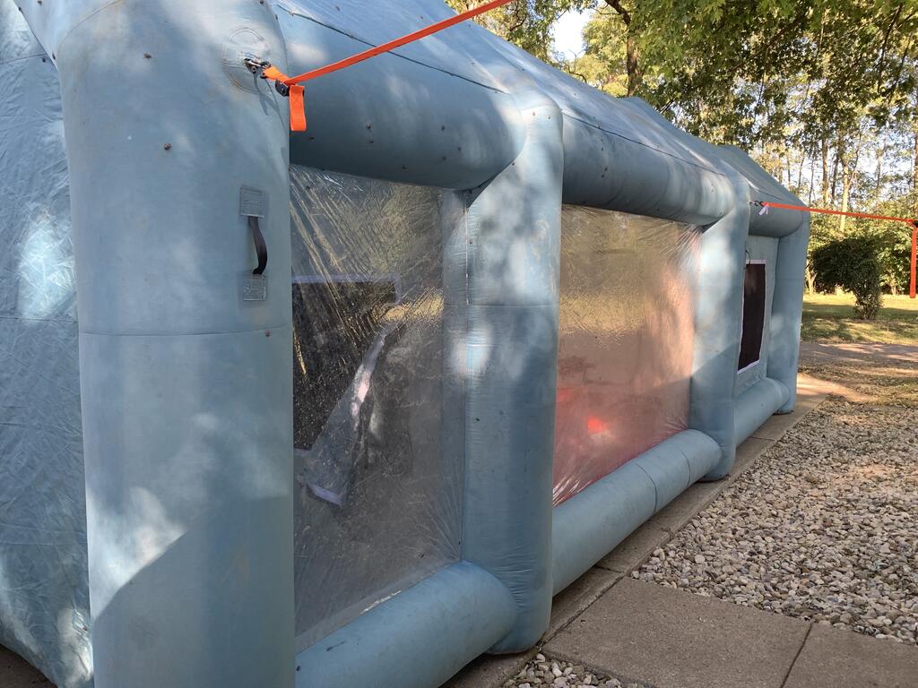

Zeek 2,299 #43 Posted November 6, 2022 On 10/5/2022 at 8:57 PM, WH1618speed said: Ok, maybe it was answered in another post I missed, but where did you get the inflatable spray booth ? I have spent time doing 2x3 enclosures with plastic, but this looks pretty cool since you can put it away from everything you don't wany oversprayed! Share this post Link to post Share on other sites
WHX?? 56,833 #44 Posted November 6, 2022 You need to quit tryin to hackin off your hand and visit here more often Tom... just had a discussion on these awhile back. Do a on them or search here. Turns out they offer them in all different pay grades. Quite the cats meow I understand. 1 Share this post Link to post Share on other sites

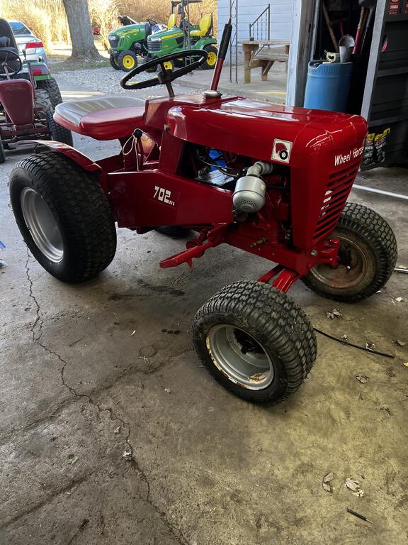

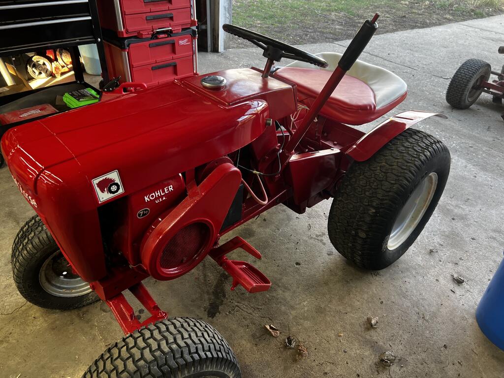

WH1618speed 543 #46 Posted February 10, 2023 Update on the 702 she’s all put together and running… waiting on the weather to warm up to paint the factory rims. It’s got some donors on now. 5 2 Share this post Link to post Share on other sites
